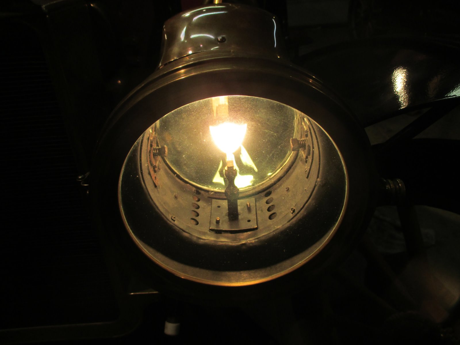

Here is the inside of an original:
As far as reproduction lamps go, these look fine.
Nice, but not original.
