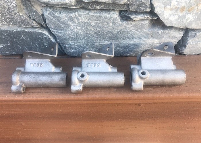

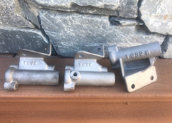

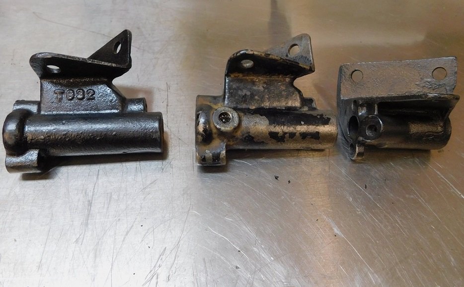

- Posts: 6577
Re: Replacing lower steering column bracket bushing
Does it look like any of these LHD. The one on the far right of the top picture is 26-27
