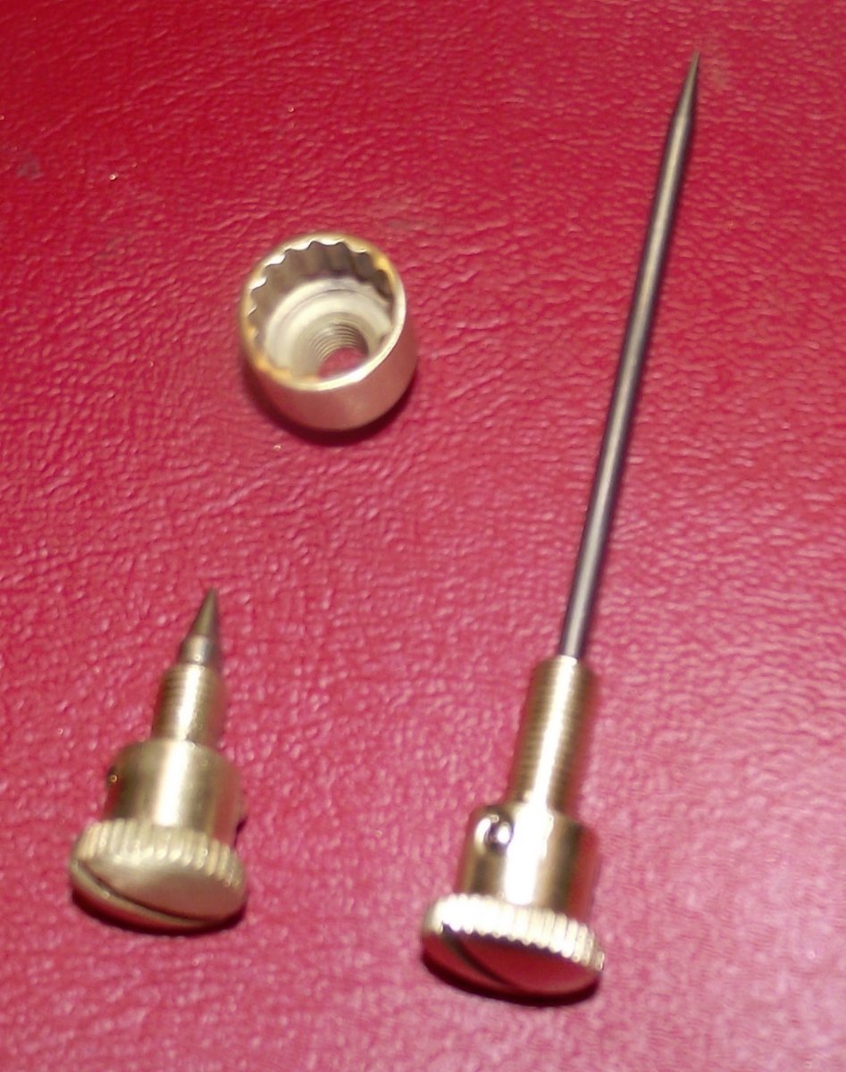

This is the kind of thing that takes all the time.
Replacing the 4 little balls and two springs in the Stromberg carb's adjustment needles.
I spent an hour on these today, it is piddly little work and no matter how many I've done I can't seem to do it any faster.
I wind the springs for them on the lathe, buy the little steel balls by the bag full, etc., but it just takes time.

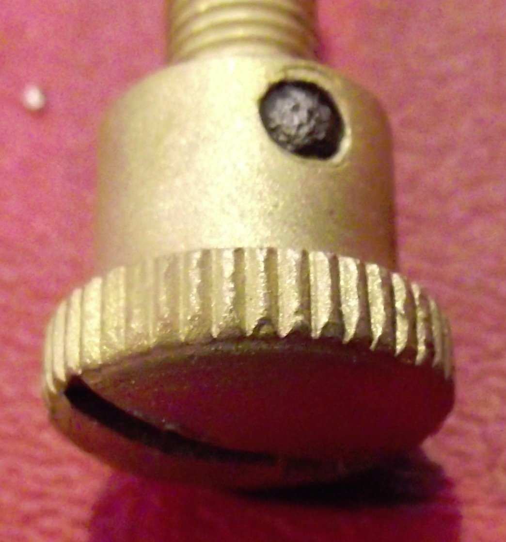

Notice how the steel ball is rusted into the knob. There is a spring on each side with a little spring inside. Nearly every one is rusted up or at the very least, sticky.
First thing is to get the old balls and spring out. Bigger hammer, hot wrench, it's amazing how that little spring can stick in there.
Have to clean the hole up, this is a .126 -- .001 oversize reamer --

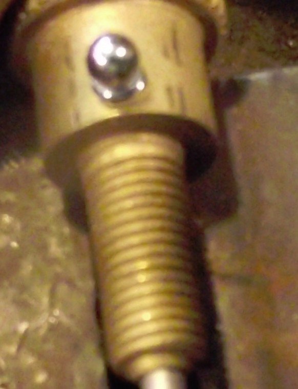

I wind these little springs, have to do some more, I see I only have one more in the drawer with the balls. The larger springs are for the economizer on OF's.

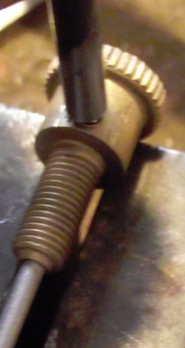

Now the tricky part, get a ball, the spring, another ball in the hole, seal it in and still have enough of it sticking out to contact the sides of the holder.
Do one side, turn it over, insert the spring, insert the other ball, whack the tool with the hammer, hope it is all in the right place when you're done.
Finally, take a 1/4 x 32 die and run it down the threads and a 1/4 x 32 tap and run it through the threads in the holder and it should be good to go.

As far as soaking them in something to free them up.
Some people do that and probably can make it work.
My answer is when I ask myself "should I do that and it will be ok?" is that people are paying me pretty well to do a restoration, not a half assed rebuild that will work.
So unless they are not pitted, free and working and will hold the setting -- rebuild them, replace the balls and the spring. Do it right the first time you don't have to do it over.
I should post a photo of one that came in recently with two new holes drilled for the spring and balls.

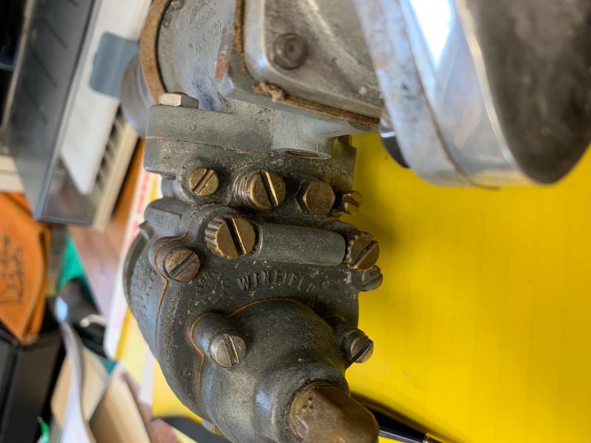

The Winfield carburetor also has that type of "ball & spring" tensioner on them which most are stuck !

Now, for beginners like me, how do you get the old balls and spring out? And does the housing get swedged to retain the new ones?
StanHowe
Posts: 979
First Name: Stan
Last Name: Howe
Location: Helena, MT
Re: Little Piddly Work is all part of it. Stromberg Needles
Post by StanHowe » Thu Dec 12, 2019 4:49 pm
Answers: Material: Yes the balls are .125 stainless steel. The springs are wound from .023 stainless steel wire. I have a jig on my variable speed lathe that I wind them on. I used to buy them but I was always out whenever I needed some. Especially after I dropped the last one on the floor and it bounced somewhere I couldn't find it.
How do I get the old balls and spring out. Tiny little punch, itty bitty hammer. Bigger hammer. Bigger hammer. Hot wrench. Bigger hammer. I also have a variety of encouraging words that I yell at it while I am hitting the punch with the progressively bigger hammer.
How do I keep the balls and spring in the hole. The tool is a little swage. The tip has a hole for the ball to fit in far enough to hold it in position and the tip of the swage collapses the edge of the hole when you whack it with a little hammer. I usually hold the part in a V block while I am working on them but I used the V blocks for doing a setup on my mini mill and didn't want to tear it down so I did this one in a vise.
Note to self. Buy another set of V blocks.
