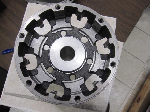

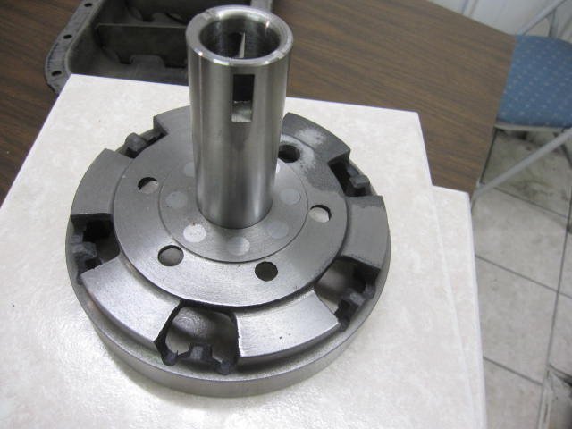

Re: Loose rivets in brakedrum
Can I save this by trying to heat the rivets individually (somehow) and hammer them so when they cool it will be tight again? Or what does one do?
(Apart from finding another)
It is better to remove them and purchase replacements and then start over. The rivets along with the holes will be worn and if you reset them they will loosen up shortly. You would need to cold rivet them.
Once you install the rivets you will need to remachine the surface as shown in pictures so the heads don't interfere with the thrust washers.
We also make the tranmsission drums and gears see above.

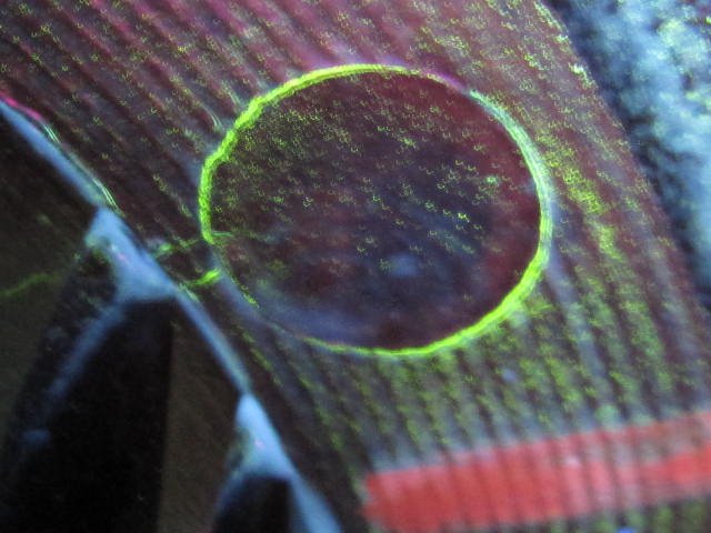

One more thing, Since no one else has mentioned this.
Since the brake drum is loose on the hub It would be wise to get the Brake drum crack inspected.
Most often we see engines with good drums only to fail the crack inspection as the rivet holes are cracked around the rivets.
Makes no sense to rerivet the drum only for it to loosen again and fail.
Above picture is a crack in the rivet hole on a reverse drum but same thing occurs to all the drums even drive plate.
It's worth it to have them checked.

I would replace the rivets one at a time. Drill one out, fit one in.That will keep the hub and drum in line when fitting them together. I note the cracks in the JM photo. I have found a number of such cracks over the years. If the rest of the drum is sound, I have re-used them. There is every chance that such cracks occurred when the two were initially riveted together. Better without the cracks, but not a real problem.
