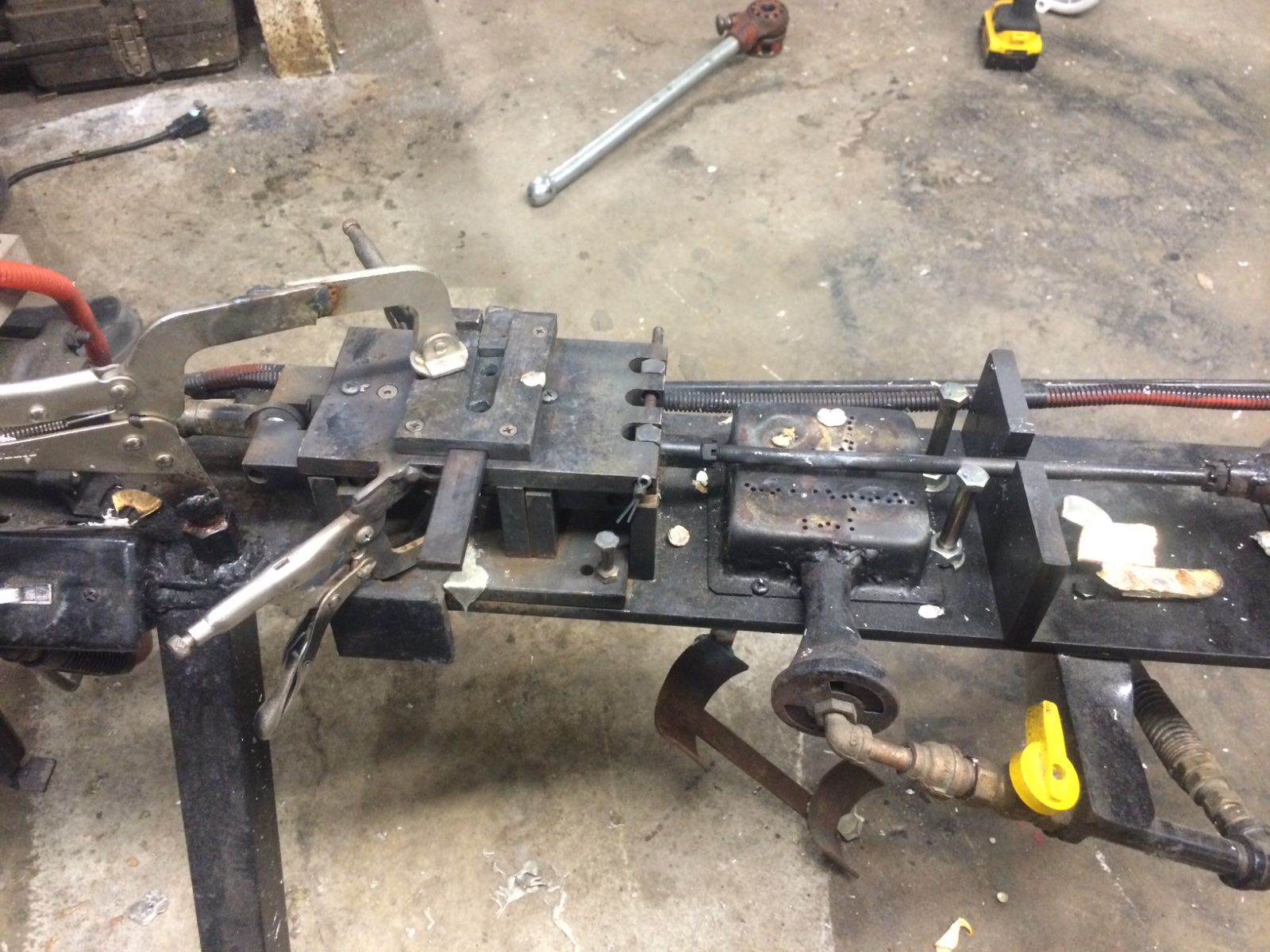

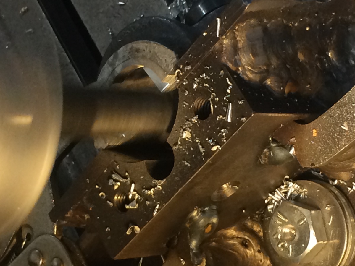

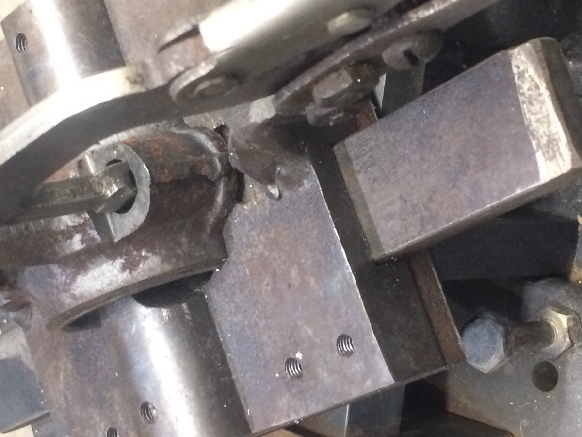

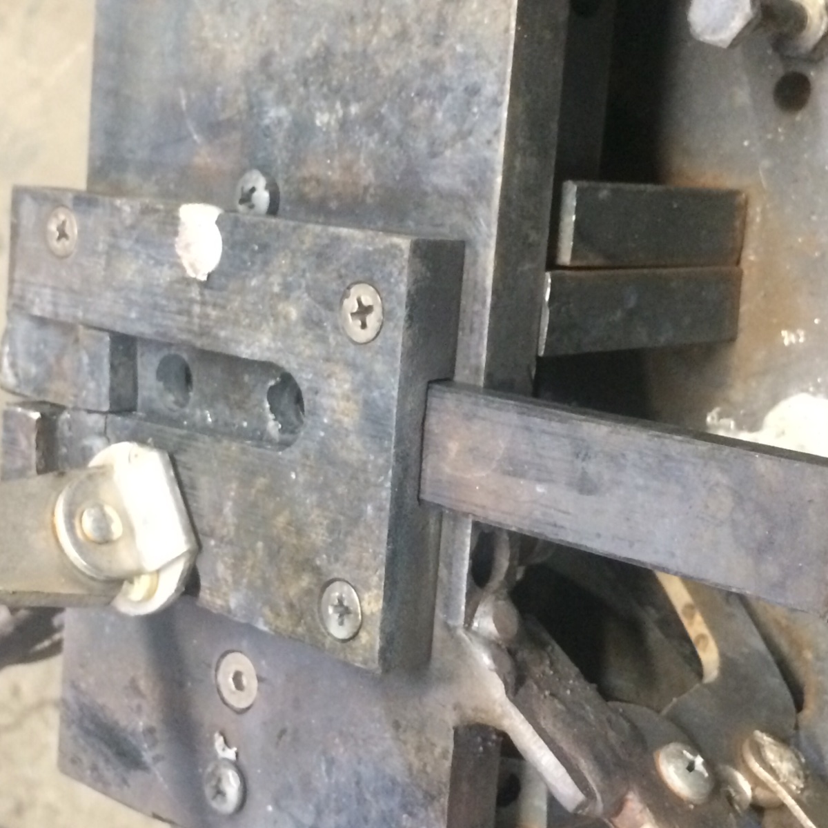

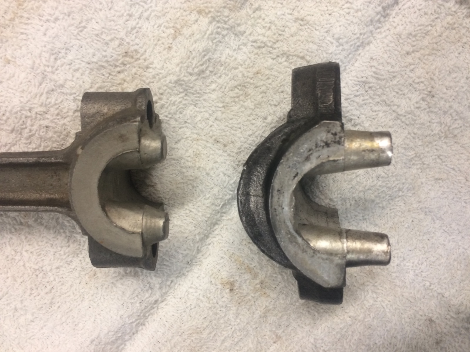

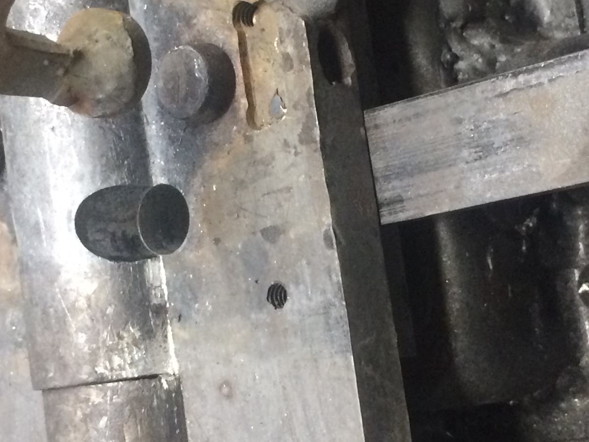

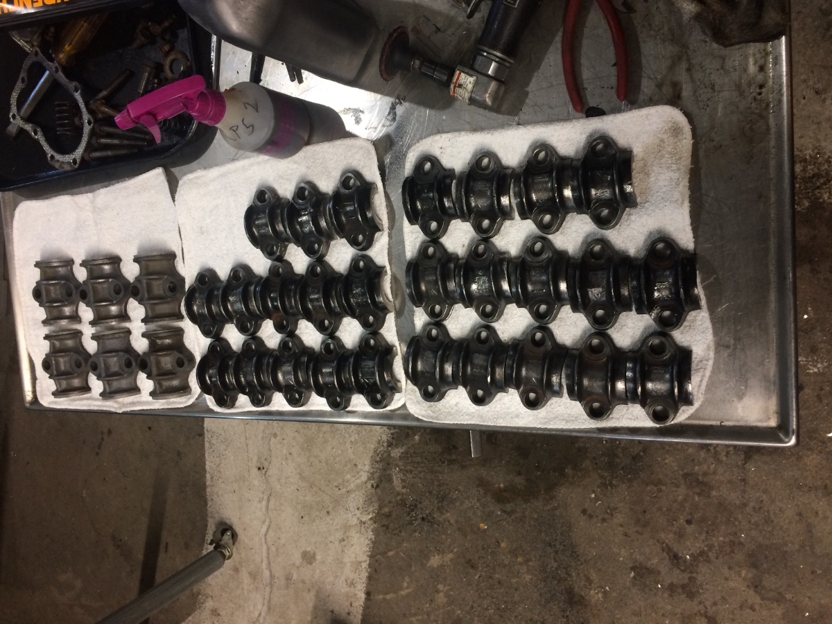

This month project. Improve my main bearing Babbitting fixture.
Babbitting
Babbitting
Complete
Complete
Spruce removal
Spruce removal

Dean : How about showing what you to improve your jig. I need to work on my jig. Thanks Dan.

The sprue cutter needs to be in the base of the mold making a 1/4 inch long sprue. Not on top of the mold. The 5/8 inch sprue is hard to remove.
