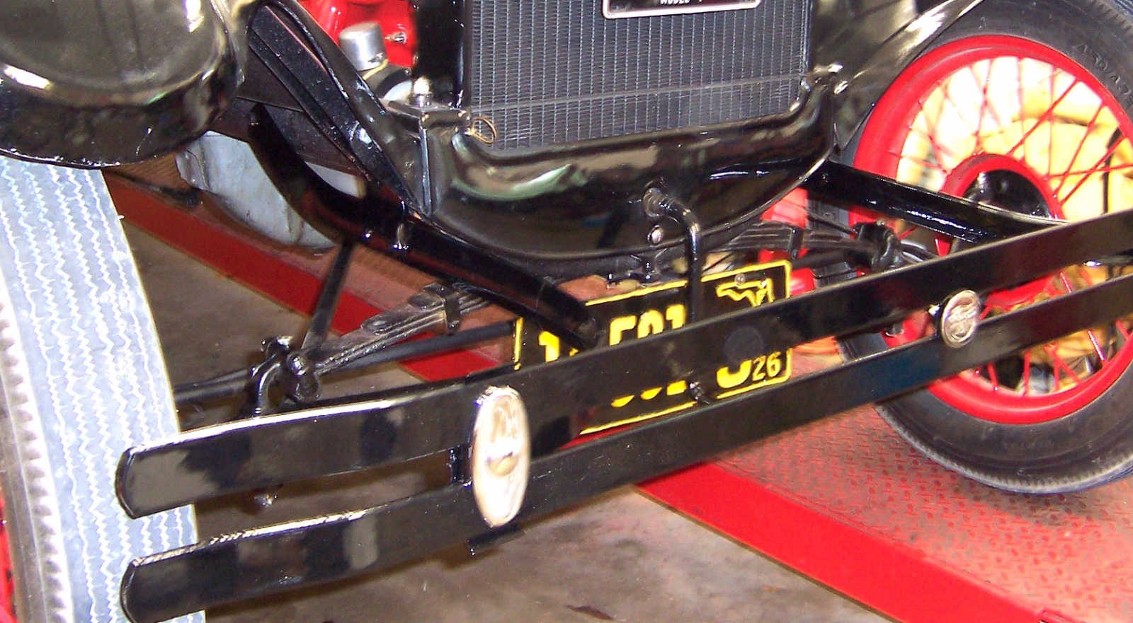

- Posts: 4042
Re: Bumpers???
Dave
On the '27 touring found at swap the front and rear original bumper bar pairs, along with a pair of original front mount arms.
Took the pieces to the powder coater, who sandblasted and coated in shiny black. Did shape each bumper bar with a hammer in the vise to have all be approx. the same shape, removing years of 'hits' and bends I guess.
Only forgot to fit the original front mount arms.
So when mounted up, the front right sagged, so had to heat torch the arm on that side to get the right level look. That burned off some powder coat, but a spat of gloss black paint, and doesn't show....much.
For the rear, got the rear mount reproduction arms from the vendors, they are made very well in my comparison to the original front arms. And the rear just bolted up exactly right to the holes in the frame. Easy to do.
And those rear don't interfere with wheel removal, and do provide protection to fenders and perhaps pedestrians
Here backing up doing the T 'blindfold' balloon breaks, T games, the folks in lawn chairs on the curb were running at this moment of photograph!
