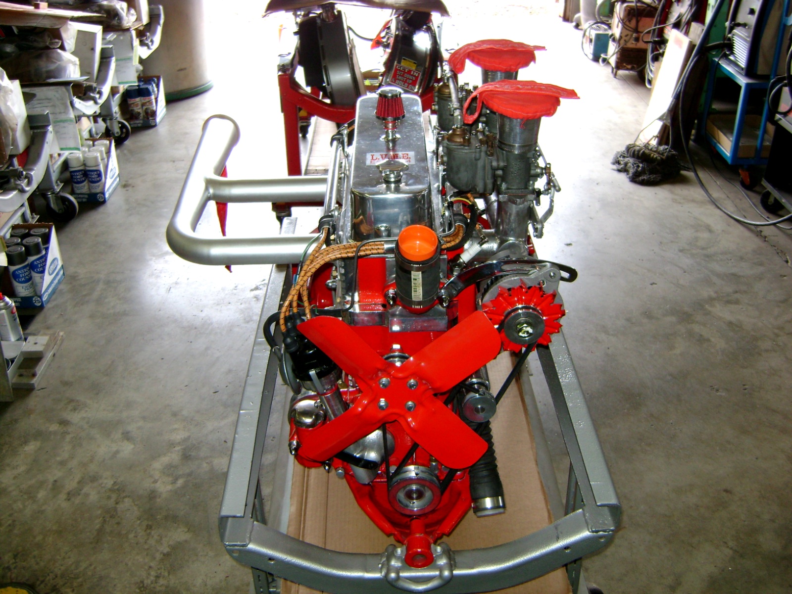

Here is what will produce the best results but you will need to relocate your generator or install an alternator on a pulley system. If you require one, please contact me though my email provided.
Hope this Helps!
Hank

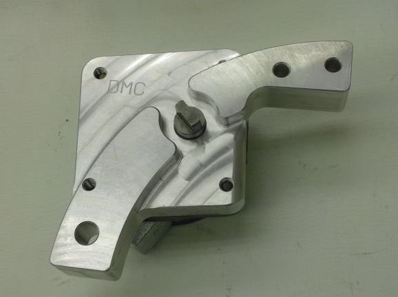

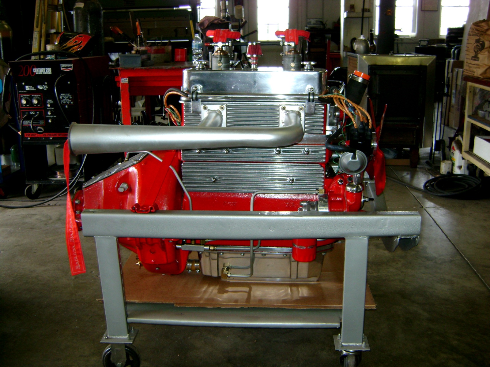

This is an overhead but gives you the idea. I do have the mounts for flat heads as well.

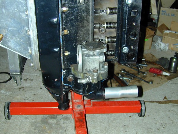

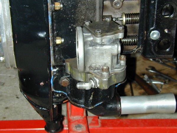

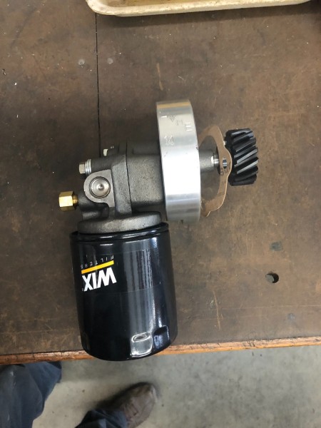

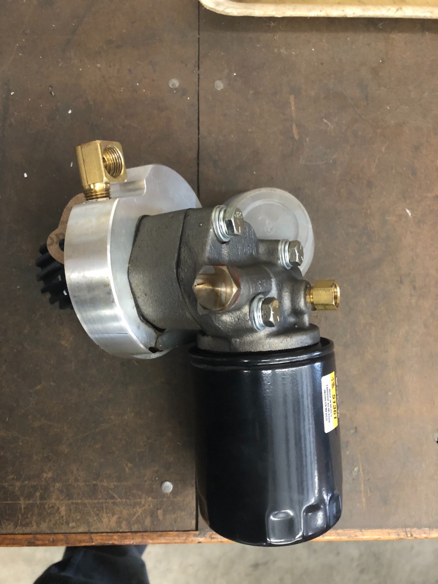

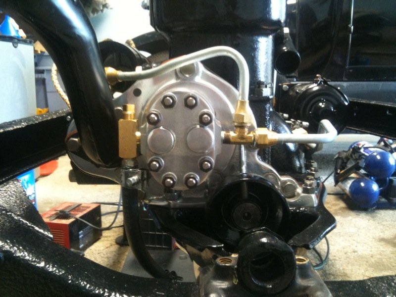

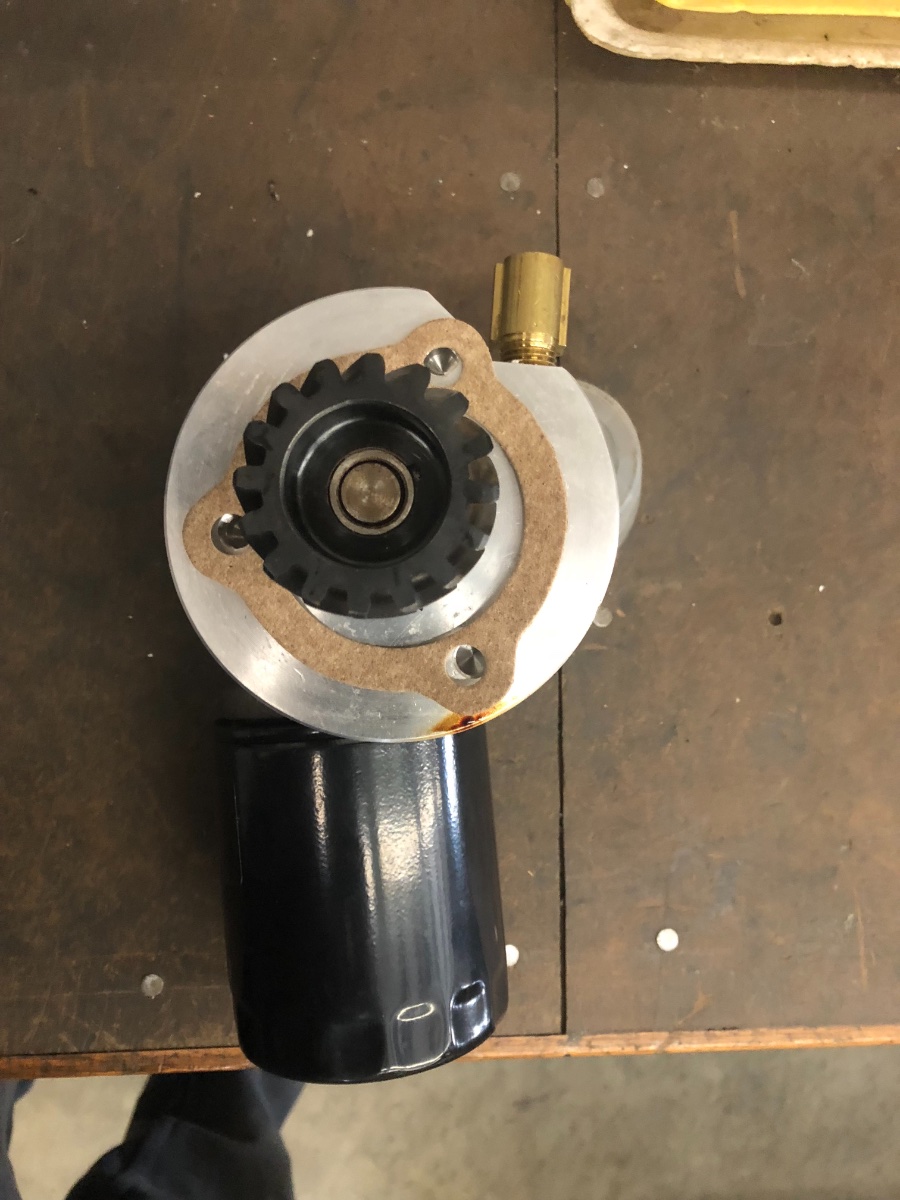

Here is a shot of the B-210 pump I’ve been running on my T for bout 10 years now. Didn’t like the fitting sizes or locations on the adapter pictured above, so made my own. You can see the special built check valve and the bulkhead fitting to pass thru the pan behind the carb air horn. I sumped my pan for several reasons, but it did make ample clearance for the required plumbing.
Pump has never lost its prime over the years, and always provides plenty of pressure 40 psi at idle. And that’s after I cut down the bypass spring to lower the pressure from >60 psi!
Remember that this discussion can have an extreme snowball effect, and is not for the faint of heart. Plan this project carefully, and remember... this is not a speed accessory! This is a required modification only when the engine is expected to perform waaaay beyond its design limits

I have never used a check valve on the oil inlet. I’m not saying that the idea doesn’t have merit. I have always “blipped” the throttle on start up.

Not sure if the check valve makes a difference er not... as I’ve never tried without it. But this pump will make pressure after a couple seconds of cranking on a cold motor, and that provides me a bit of security (potentially false) that the countless hours of effort are at least being oiled reliably. I have encountered motors that had priming issues before, and was determined not to have issues with this motor. Check valves are a must in my opinion for any motor where the pump sits above the oil level

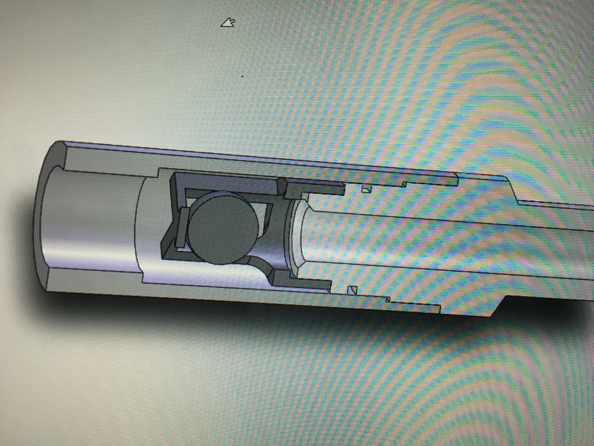

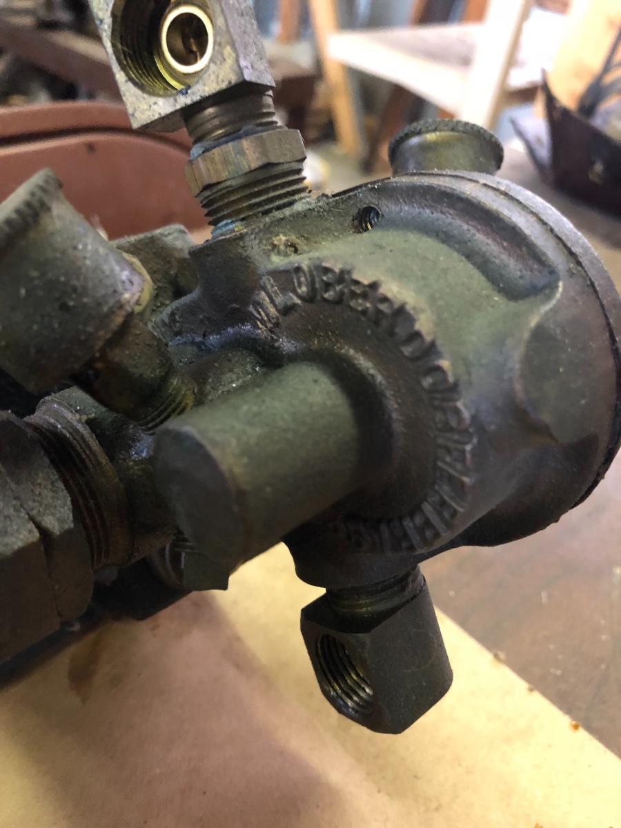

I’ve never come across an “off the shelf” solution that seemed like a good fit. Have seen some as simple as a few strategically assembled pipe fittings. For this motor I wanted something a bit cleaner... and it only cost me dozens of hours...! :roll:
If I remember correctly... there is a captured .500” ball in that aluminum housing that is gravity seated

Post by Kevin Pharis » Thu Dec 19, 2019 11:03 am

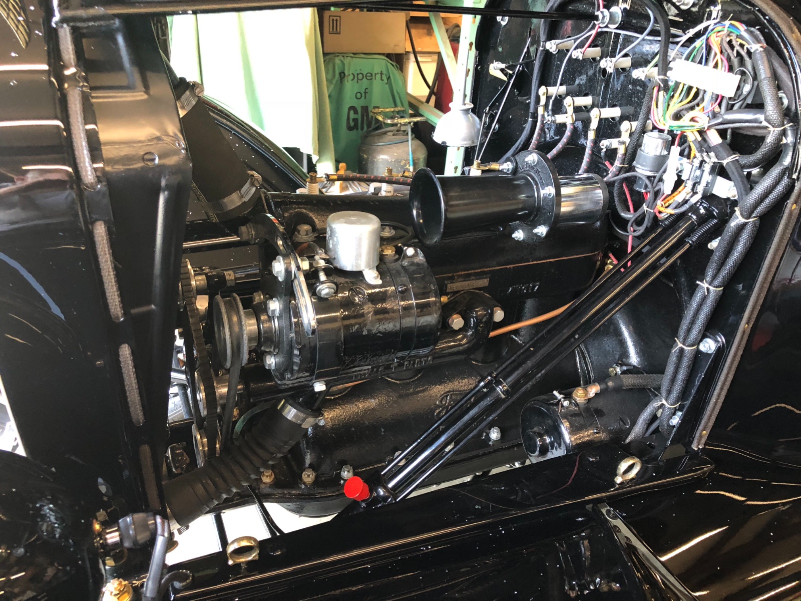

Here is a cross sectional view of the check valve in the pic

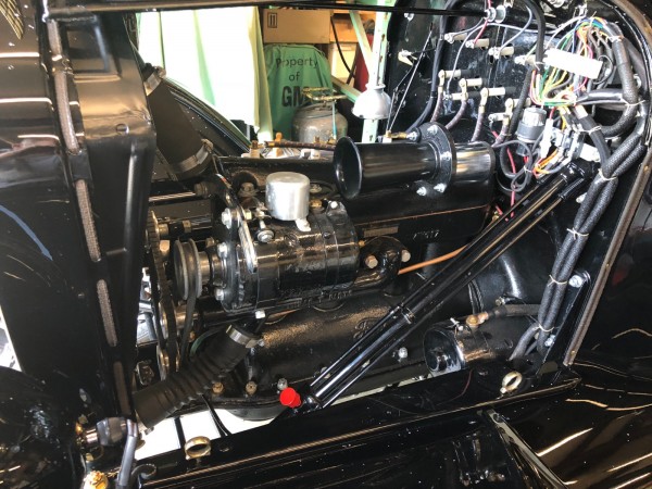

Great topic. I'm trying to work out how to rig an oil pump on a pre-19 motor... I have a pre-19 block that's been drilled and tapped for pressure oil but don't have an idea how the person setting this up was planning on pumping oil...

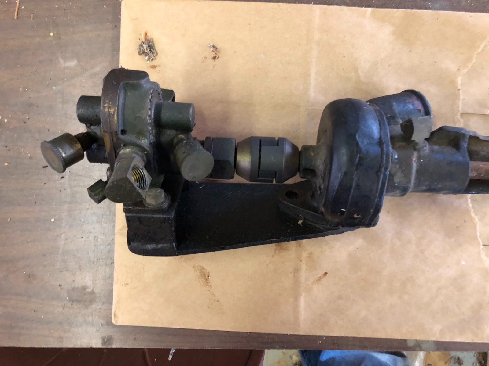

Post by Henry K. Lee » Thu Dec 19, 2019 7:34 pm

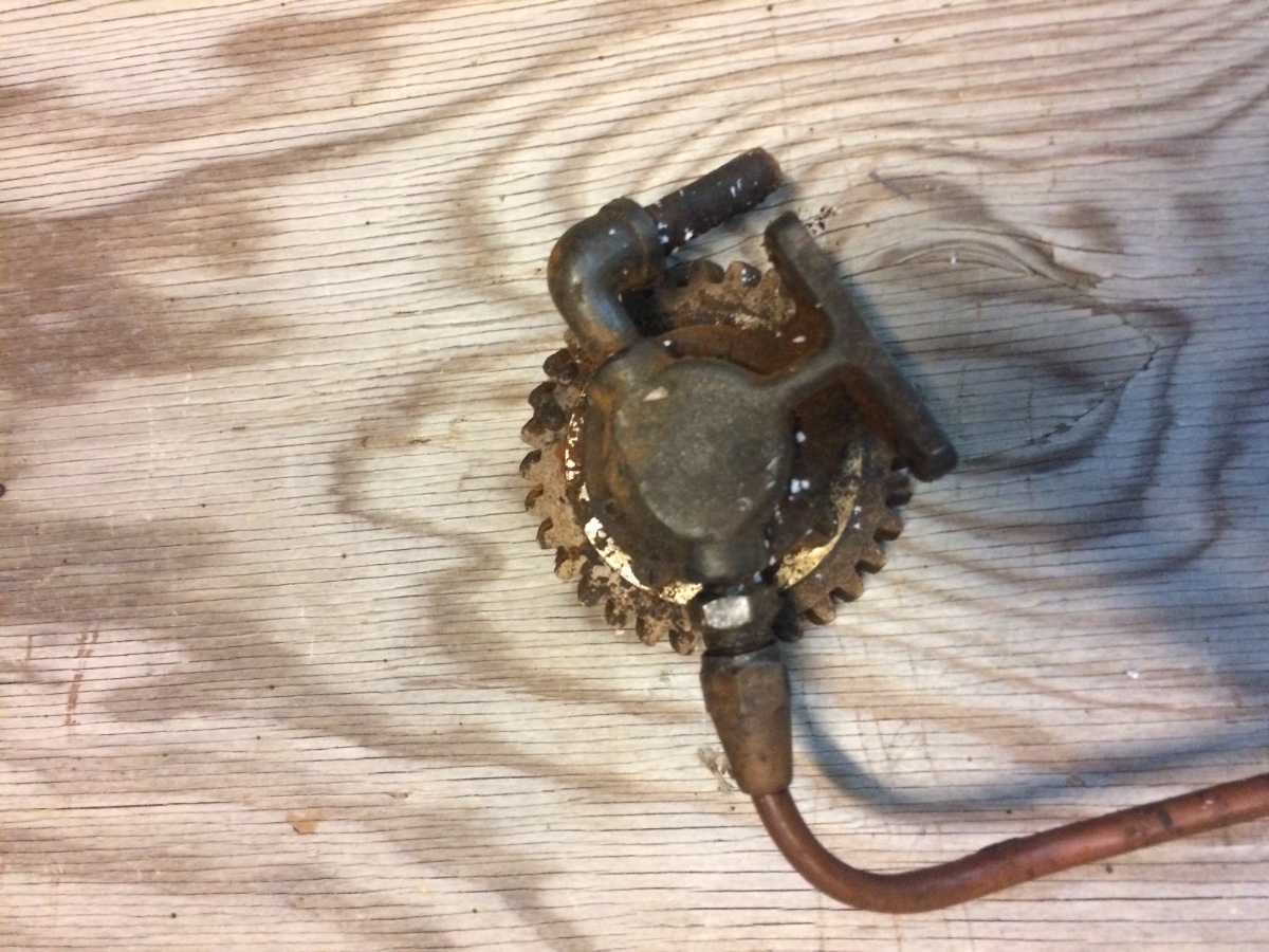

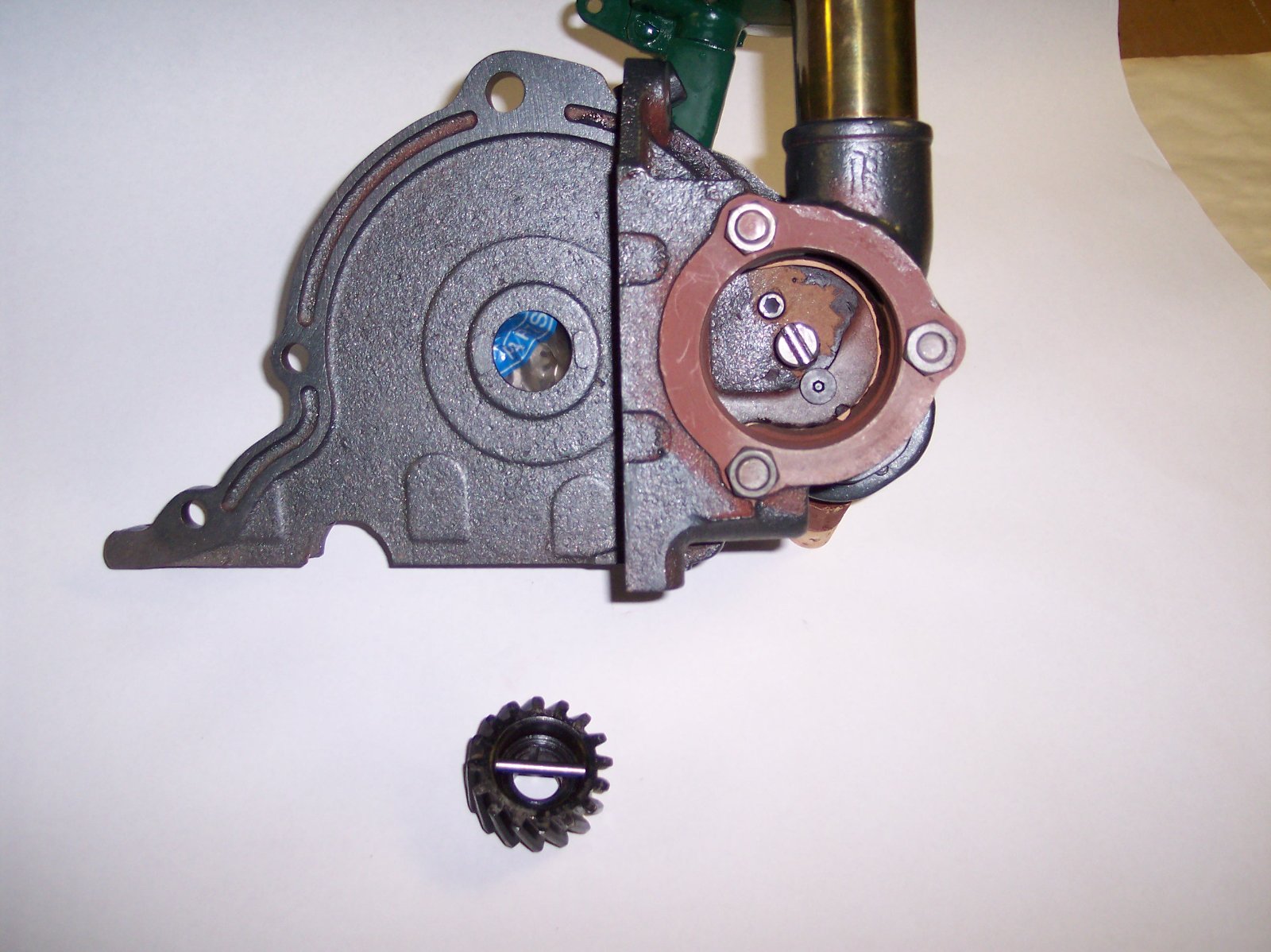

I will dig one out of my barn stash for you and take photos. Dad made one years back that was belt driven from a small marine brass water pump, worked excellent! He made a by pass switch you depressed on initial start up until oil pressure was achieved, if you loss oil pressure due to a broken belt, engine would kill and red oil light came on. Just ideas!
All the Best,
Hank

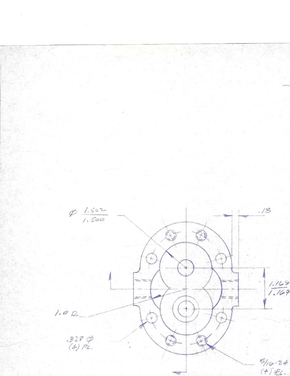

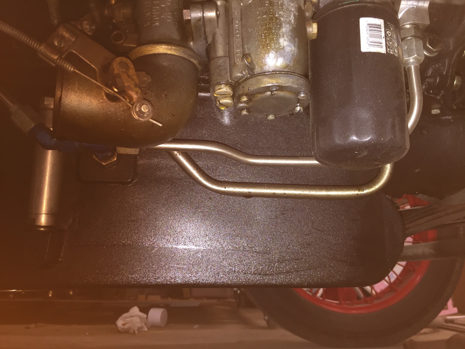

Post by Lessumner » Fri Dec 20, 2019 8:24 am

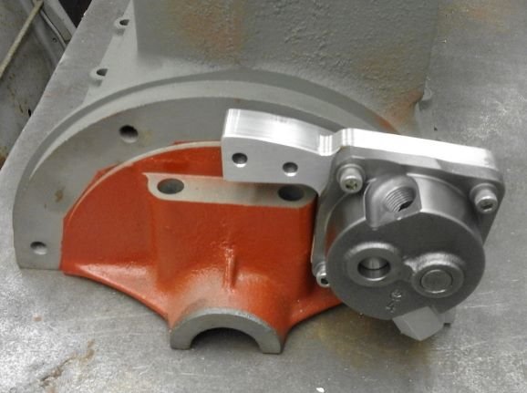

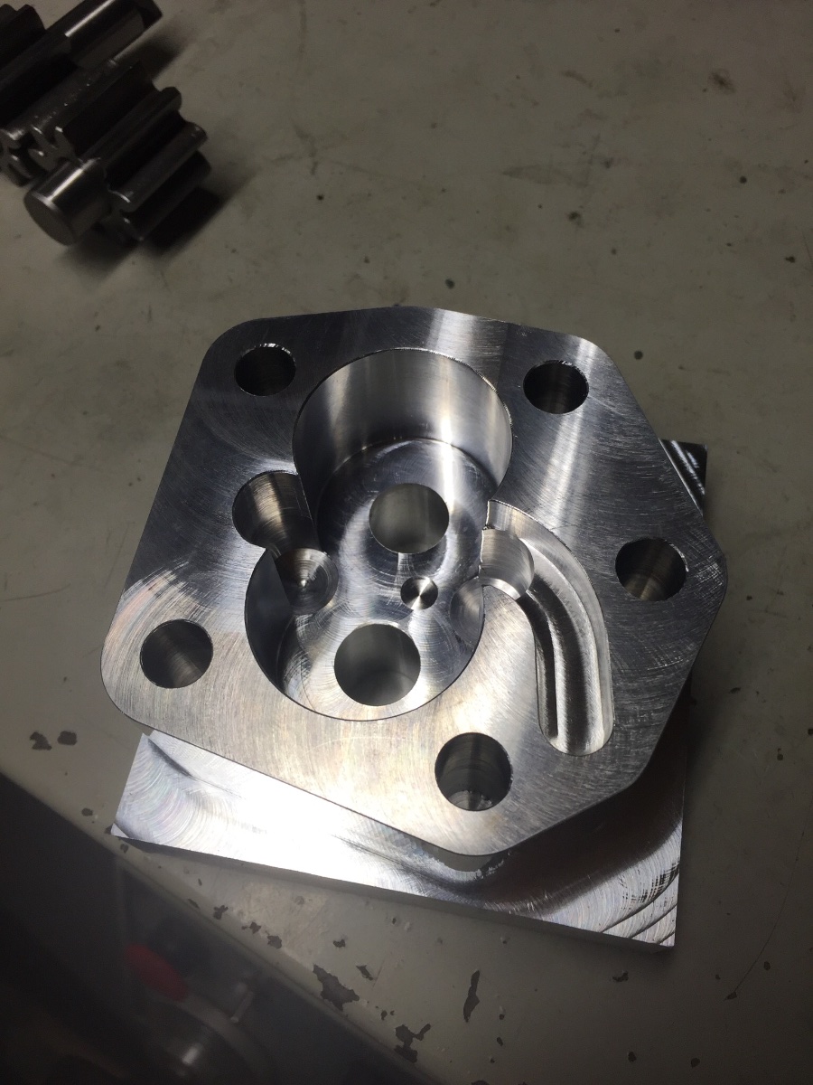

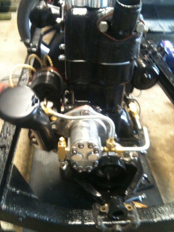

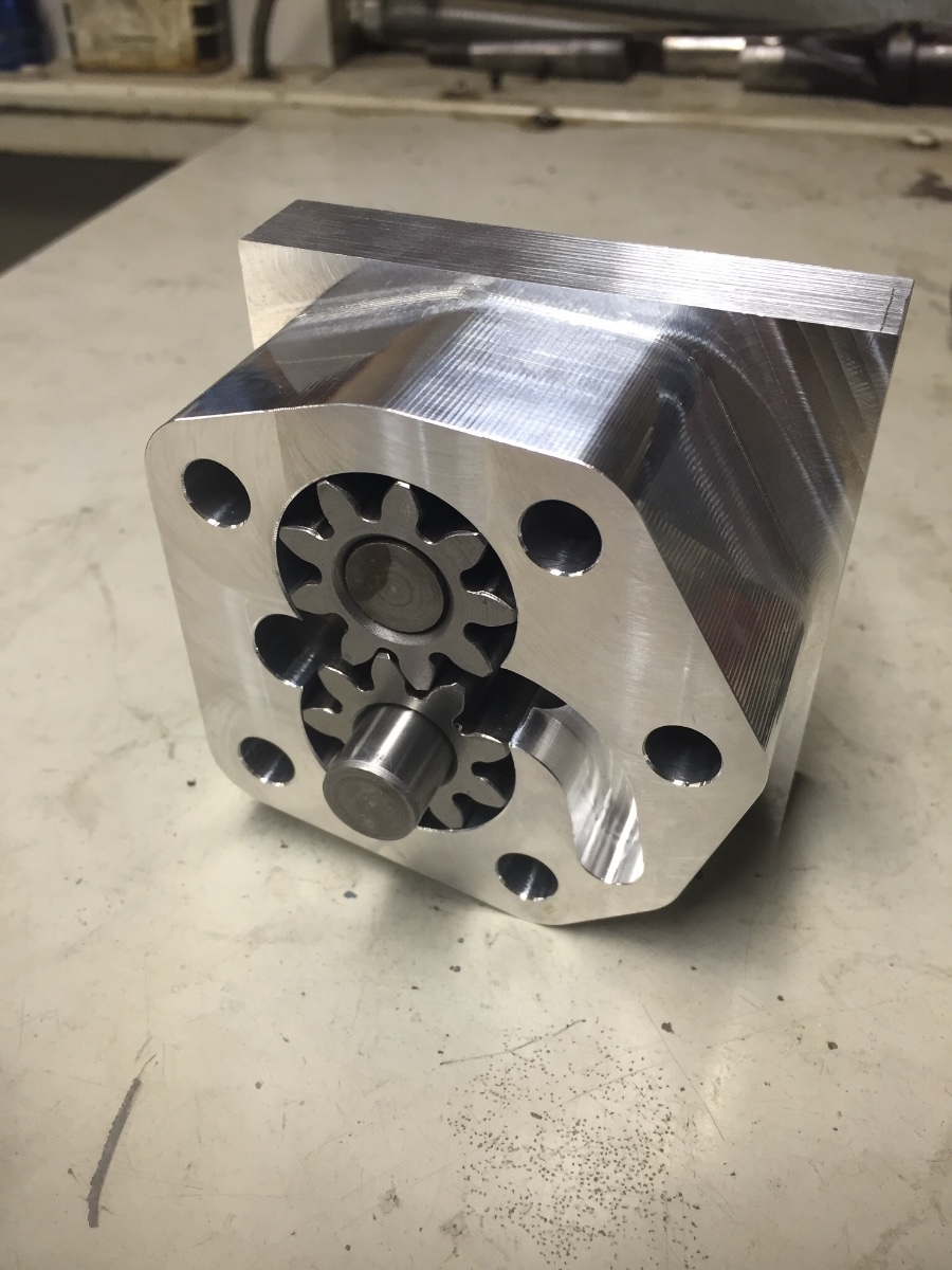

I have made many of these pump set ups for my cars. It is a small gear pump bought at a machinery surplus sale driven off the front of the generator gear. I machined a flat surface on the timing gear cover, fitted a small plate to screw the pump to. A roll pin thru the generator gear fits a slot in the pump shaft. They self prime and I have used one on my Fronty for 35 years trouble free. Les
Posts: 5603
First Name: Henry
Last Name: Lee
Location: South Pittsburg, TN
Re: Oil pump
Post by Henry K. Lee » Fri Dec 20, 2019 8:58 am
Very Nice Les!!!!

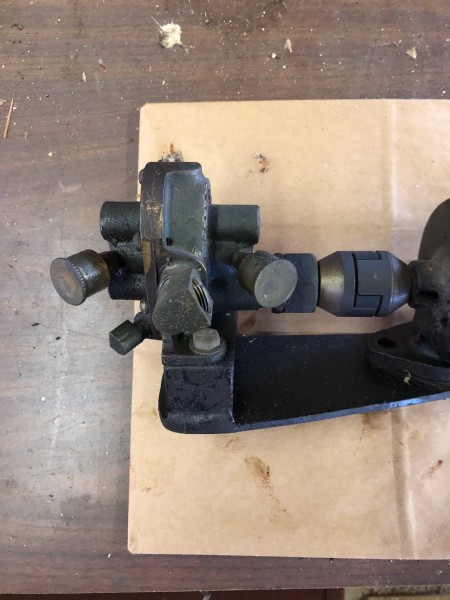

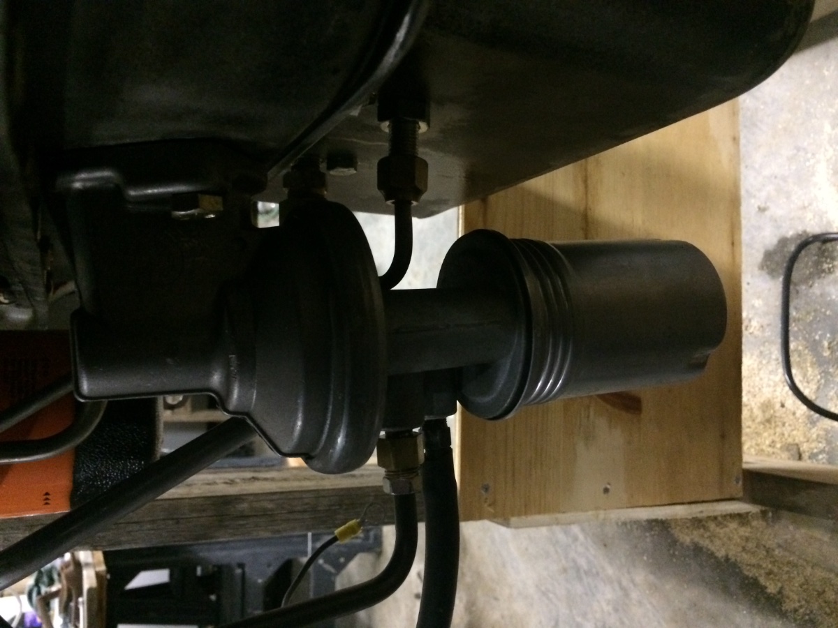

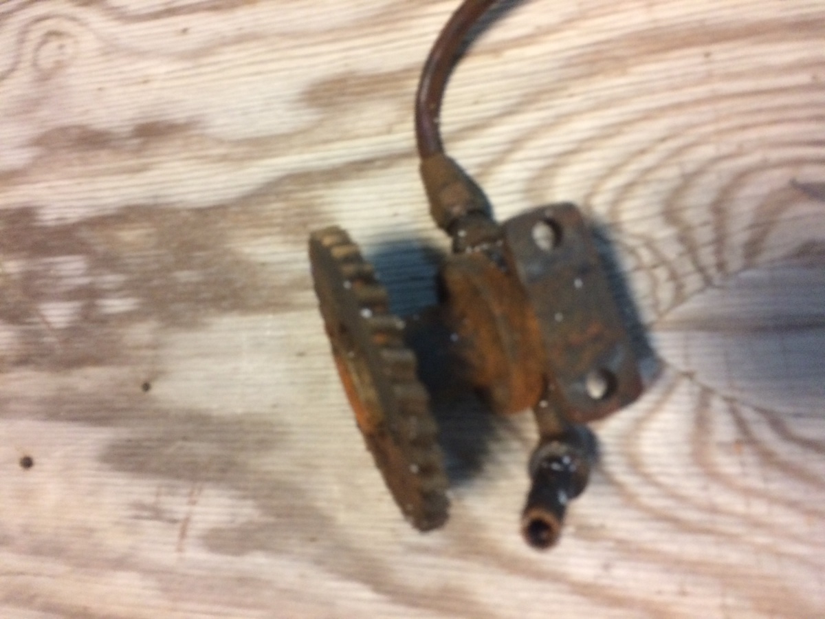

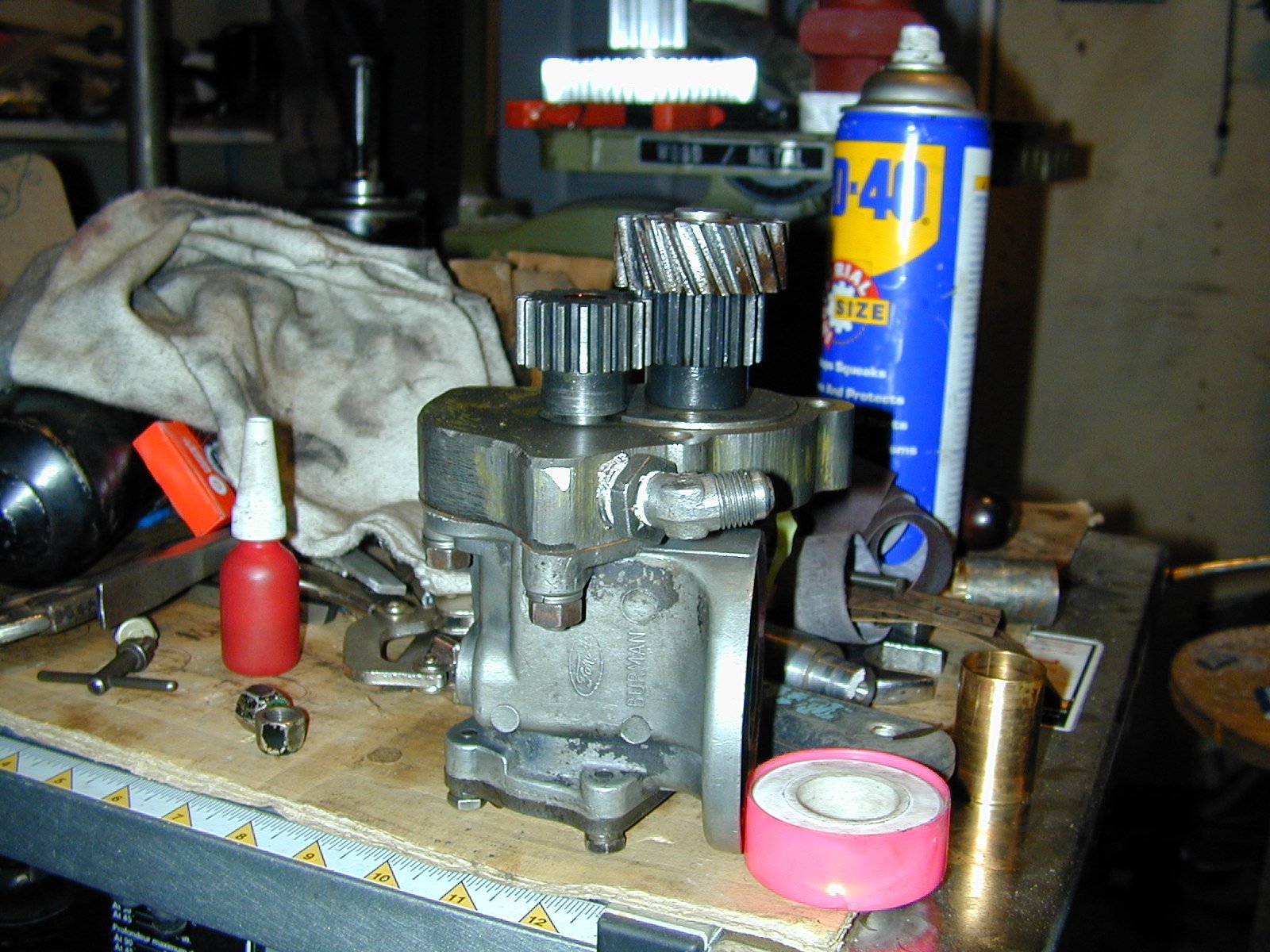

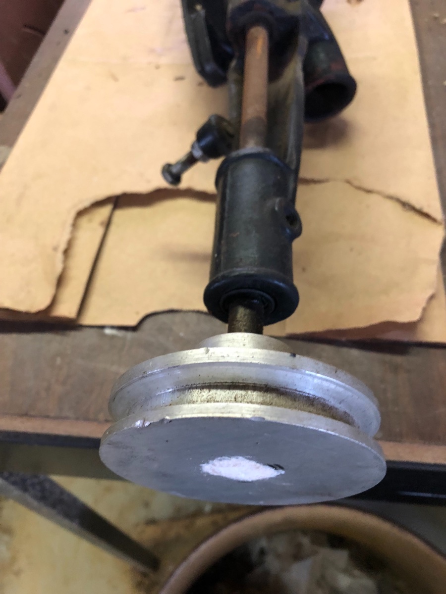

Here''s the belt drive system with a water pump. Dad got a little creative so to say, two in one.
All the Best,
Hank

The water pump/oil pump combo looks nice as you would still have a generator?? Has anyone ever thought about a battery powered pump in the sump? With 6 or 12 volt you could supply oil before even starting the engine. :? :shock: Bud.

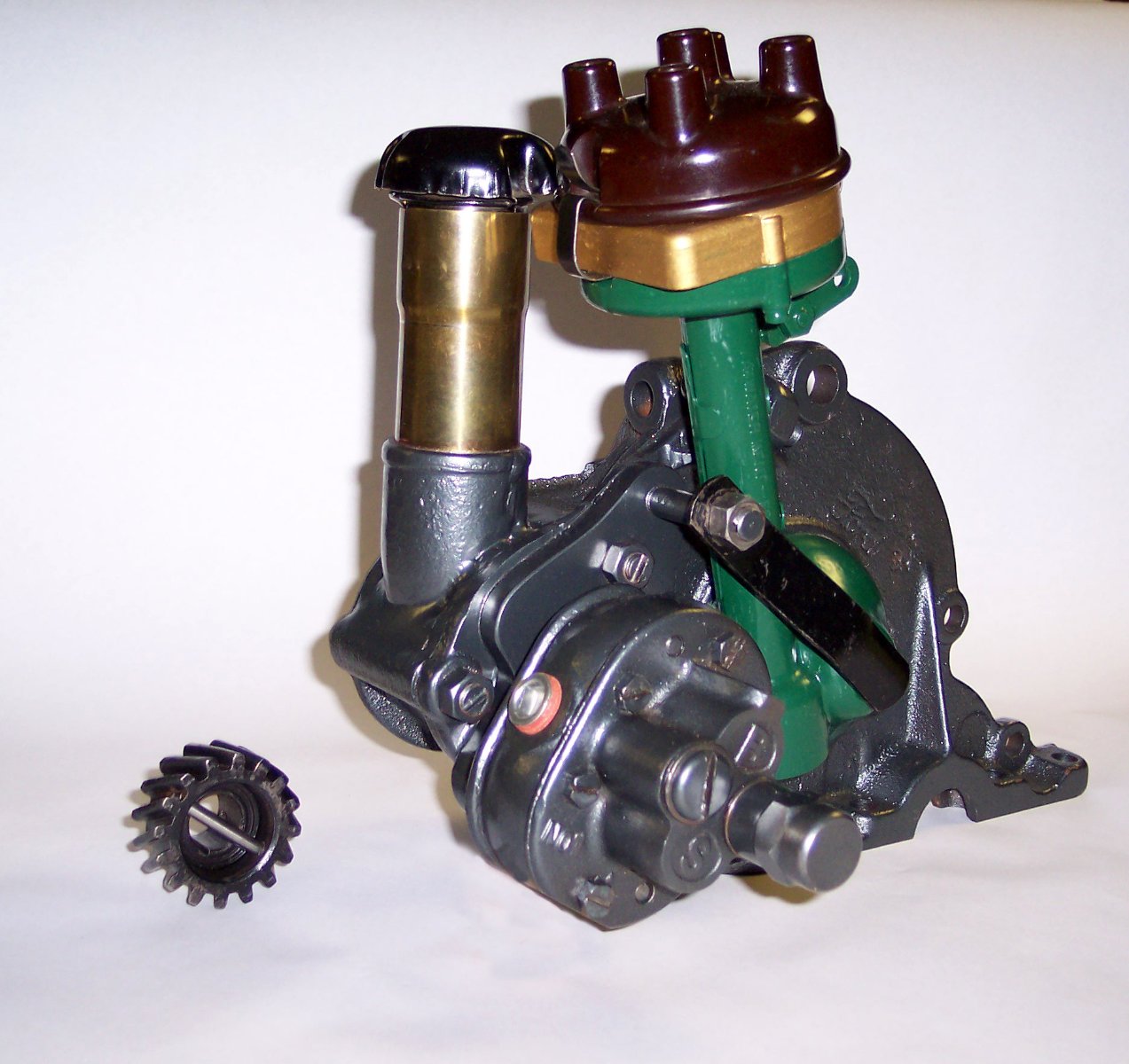

Seems to me there was an oil/water pump accessory constructed similar to the one pictured above.
Of course there were a couple 3 in 1 (oil/water/distributor) units available too...
The trait that bugs me the most is the elevation of some of these pumps. Why design problems into the system...? Get that pump as low as possible! And I believe the B-210 pump would be the lowest of all the options discussed so far

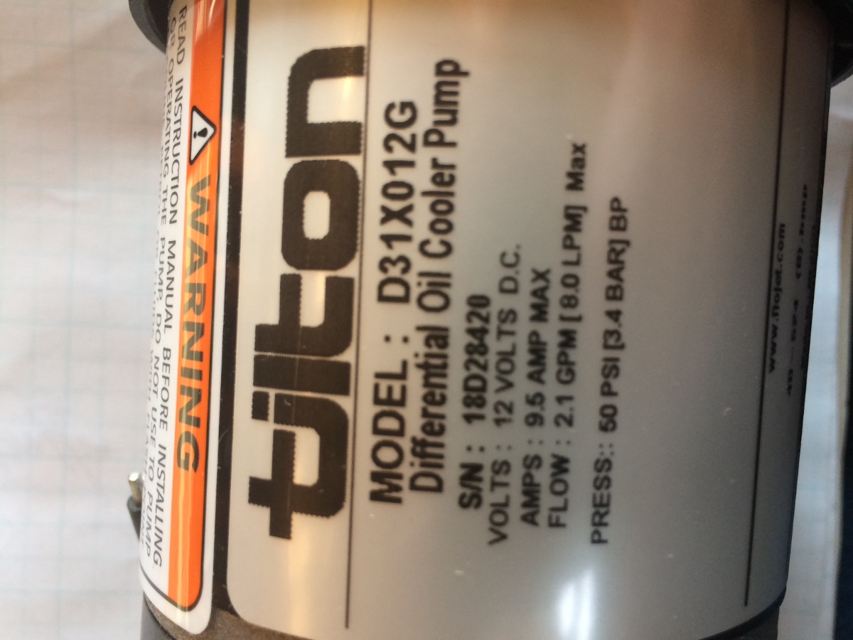

Further to Bud’s comment, I have a electric pump that I have considered installing as a “prelube “ in conjunction with a VW pump on the end of the camshaft. It is certainly capable of my requirements.
It has 3/8” npt connections

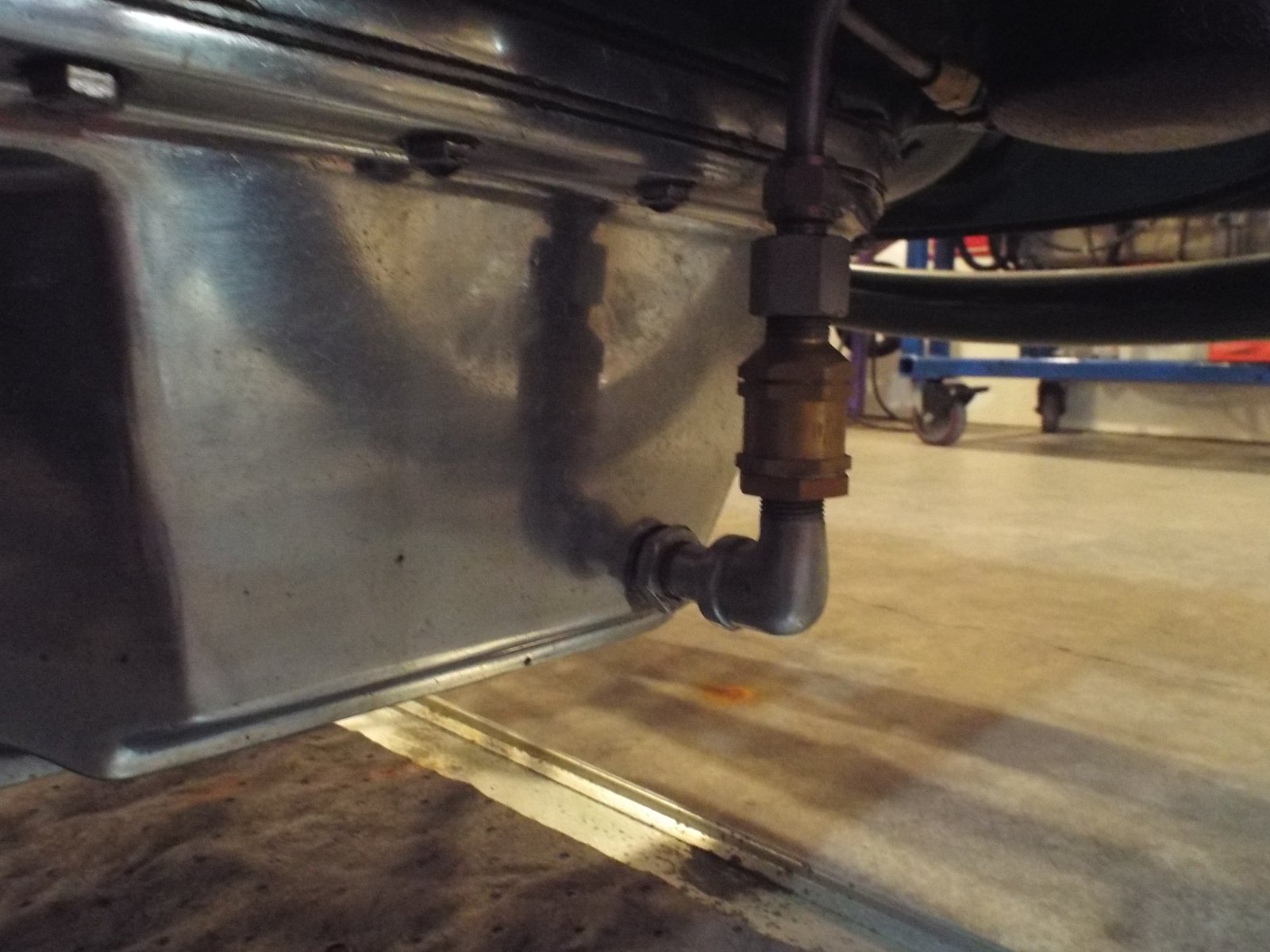

Re: Oil pump
Post by Liberty Garage » Fri Dec 20, 2019 3:52 pm

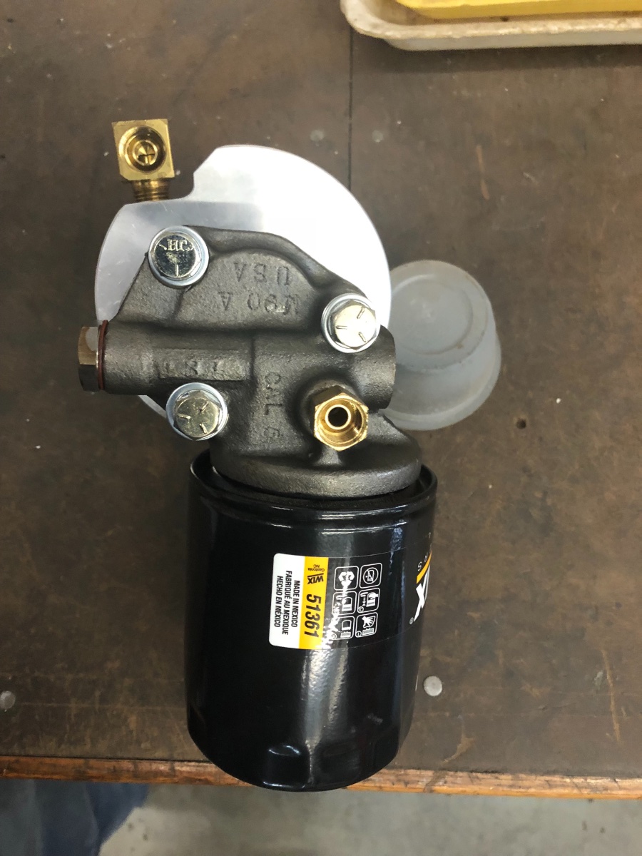

I have been using the Parker diesel fuel check valve on my speedster sumps (suction line) It is a swing type check valve and has 3/8" IP ends . The Parker number is 5135308 and is about $50. 30+ years and no problems. I screw it into a 3/8" x 1/2" pipe bushing and into the sump where I have a long cylindrical screen. Easy to remove during oil change to check for clean.[image][/image]

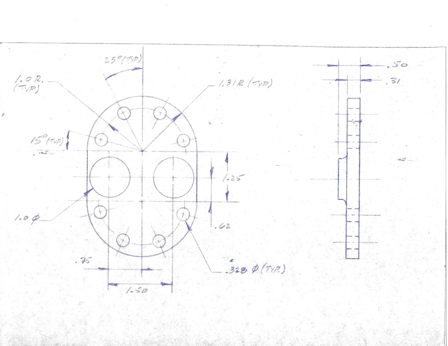

Post by henryford2 » Fri Dec 20, 2019 4:58 pm

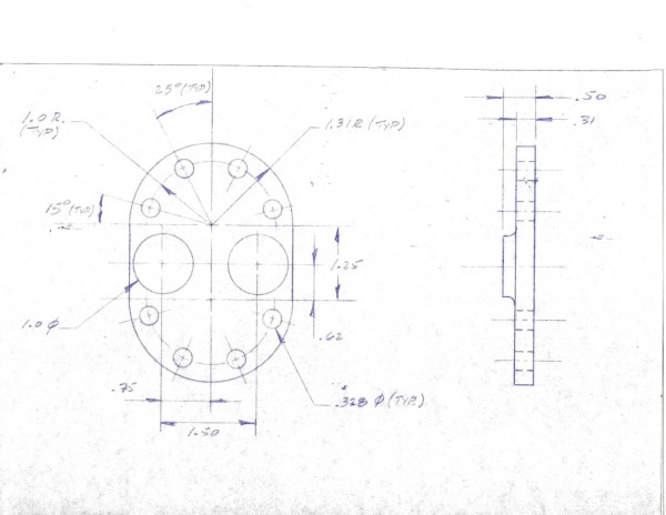

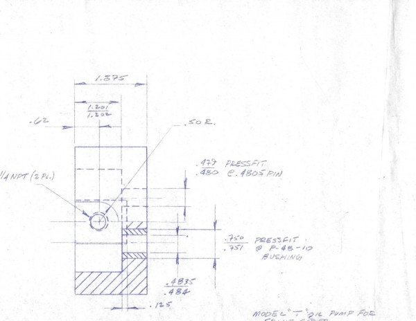

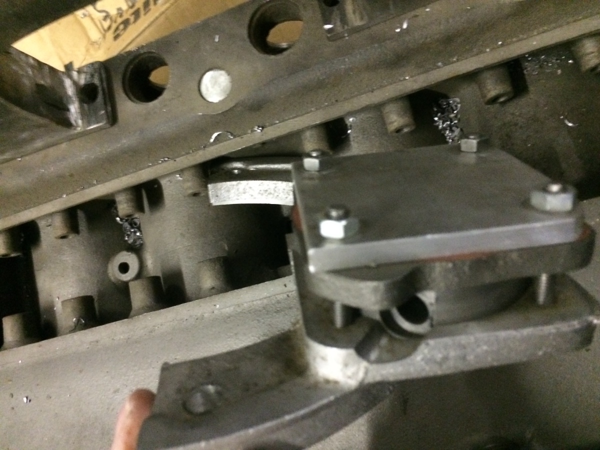

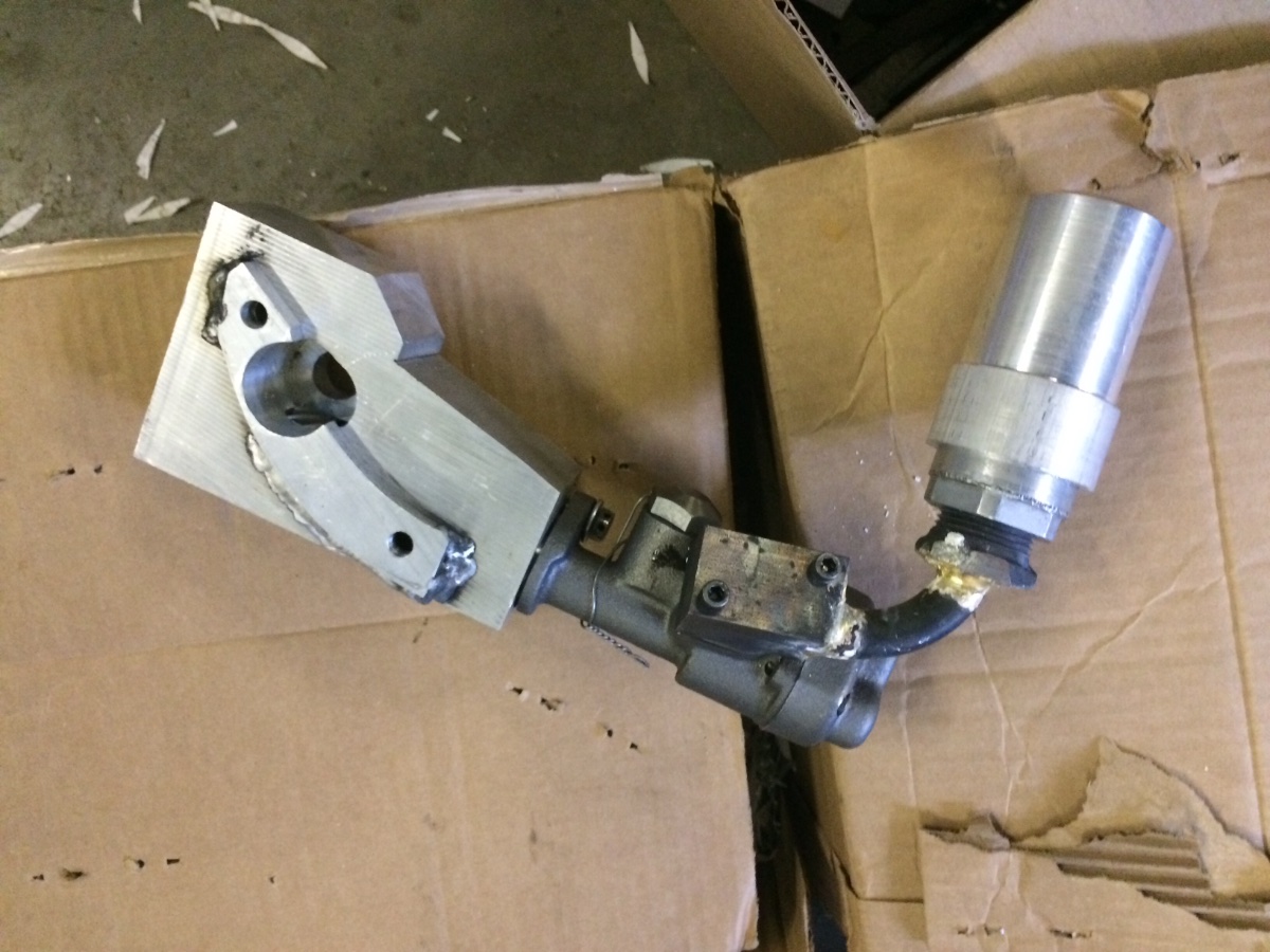

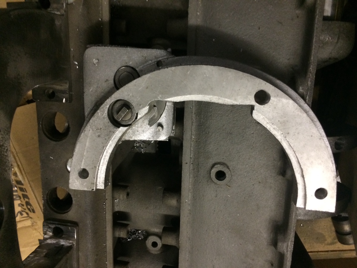

I know I've probably beat to death posts of my oil pump alternative, but here they are again. Uses the gears from a small block Chevy, magneto side drive so no generator. Enjoy

yes you do. I used the gears, the shaft for the non driven gear and the brass/bronze bushing for the driven gear from the small block Chevy pump. I still has the patterns for the pump/front plate and side drive. I've retired and lost my easy access to all the fun toys needed for the machining. I have no future plans for casting up and machining any additional parts.
Kevin Pharis
Posts: 1644
First Name: Kevin
Last Name: Pharis
Location: Sacramento CA
Re: Oil pump
Post by Kevin Pharis » Fri Dec 20, 2019 11:10 pm
Those VW pumps have great gears in em. Here is a pump I made for a ‘26 Cleveland that utilized the VW gear set. Don’t seem to have a pic of the pump finished...
henryford2
Posts: 826
First Name: Joseph
Last Name: Andulics
Re: Oil pump
Post by henryford2 » Sat Dec 21, 2019 7:24 am
Outstanding job. CNC Vertical machining center?

A lot of very nice machine work!!! I really like the picture of the heavy duty oil pan with all that hanging and all the extra power i think that pan is a good foundation!!! :D Bud.
Kevin Pharis
Posts: 1644
First Name: Kevin
Last Name: Pharis
Re: Oil pump
Post by Kevin Pharis » Sat Dec 21, 2019 10:38 am
That Cleveland pump was made on my ‘ol Bridgeport type CNC conversion mill. In computer years, it was almost as old as our T’s! I’ve upgraded since (some call it “Millzilla”), to a much more capable and rigid “bed mill” design machine. Not only is it half the age of the ‘ol one, faster, tighter, higher RPM, but also allows to addition of an auxiliary rotary table unit. So far, it does a better job than you want to do without a cabinet around it to contain the mess! ;)

Post by Dan McEachern » Mon Dec 23, 2019 11:58 pm
We've done more than a few of these over the years!
pump 1a.jpg (38.88 KiB) Viewed 22130 times
pump 3a.jpg (26.52 KiB) Viewed 22130 times
Les Schubert
Posts: 1364
First Name: Les
Last Name: Schubert
Location: Calgary
Re: Oil pump
Post by Les Schubert » Tue Dec 24, 2019 1:53 pm

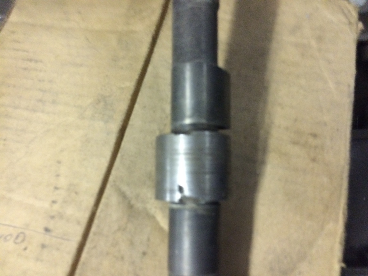

Some oil pump stuff
Les Schubert
Posts: 1364
First Name: Les
Last Name: Schubert
Location: Calgary
Re: Oil pump
Post by Les Schubert » Tue Dec 24, 2019 1:55 pm
Another one
Les Schubert
Posts: 1364
First Name: Les
Last Name: Schubert
Location: Calgary
Re: Oil pump
Post by Les Schubert » Tue Dec 24, 2019 2:00 pm
A converted fuel pump used with the cam eccentric

Dan, do you make your setup with the full spacer when the block is moved forward on the pan? Thanks, Joe
Dan McEachern
Posts: 1478
First Name: DAN
Last Name: MCEACHERN
Location: ALAMEDA,CA,USA
Re: Oil pump
Post by Dan McEachern » Tue Dec 24, 2019 9:05 pm
Joe- I make a version of the pump with a longer shaft so that the pump bracket is mounted on the block spacer rather than the block itself. I hope this answers your question. Dan

henryford2
Posts: 826
First Name: Joseph
Last Name: Andulics
Re: Oil pump
Post by henryford2 » Mon Dec 30, 2019 8:09 pm
Les, give me a day, but I believe I have the drawings that I used in making the oil pump with the Chevy gears and the castings you have. They are hand drawn (done before I began using CAD).
civinwt
Posts: 28
Joined: Sun Jan 06, 2019 4:54 pm
First Name: Bruce
Last Name: Hopkins
* REQUIRED* Type and Year of Model Ts owned: 11 Torpedo, 20TT 1Ton, 27 Runabout
Location: Victoria BC Canada
Re: Oil pump
Post by civinwt » Mon Dec 30, 2019 8:44 pm
When building my engine 30 years ago, I opted for a 4 cyl Cortina (English Ford) geared oil pump with cannister oil filter, in place of the generator. At the time, I had a choice of geared, or vane style oil pumps. No jn line check valve was used, and it has never lost its prime, nor given any trouble. At idle when hot it shows 35+ lbs oil pressure. Only downfall was I had to make a set of gears in order to change direction of rotation of the pump. I will did up a picture of the install when I get a chance.

henryford2
Posts: 826
First Name: Joseph
Last Name: Andulics
Re: Oil pump
Post by henryford2 » Tue Dec 31, 2019 1:19 pm
Les here you go. I drew these looong ago, I may or may not have updated them after machining the one I made, so proceed cautiously. I do remember I set the end clearance on the gears using a thin metal shim between the cover and the housing. I had lapped the mating surface of each of those, when assembled them with the metal shim I've never had a leak. Enjoy

civinwt
Posts: 28
First Name: Bruce
Last Name: Hopkins
Re: Oil pump
Post by civinwt » Fri Jan 03, 2020 11:10 pm
Finally found a picture of the Cortina oil pump on my '27 engine. Sorry it took so long.
