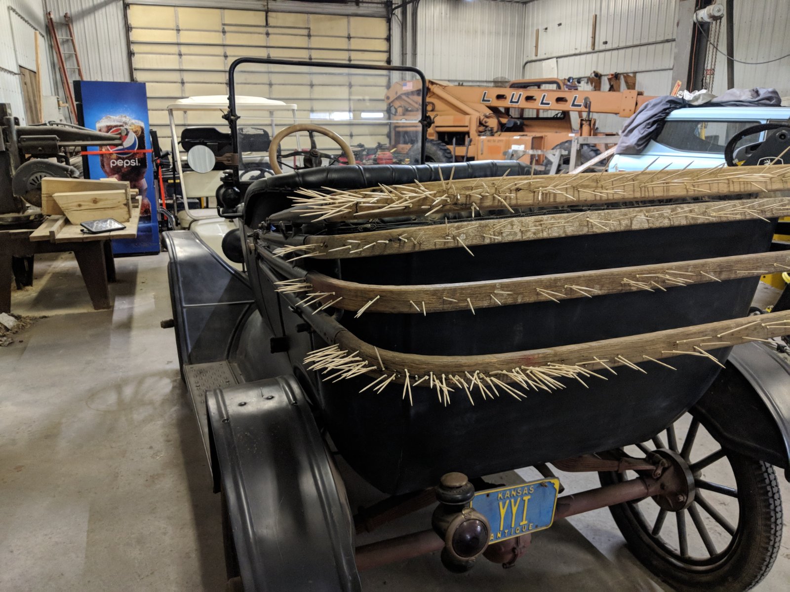

My '13 was stored for at least 40 years with the top folded down and had creases like ironed down 30# roofing felt. I lived in FL at the time and had humidity and heat working for me. I've toured in MN in July and KNOW you have the heat and humidity, too, just not for as long. I erected the top and used several large zip ties to secure the straps to the windshield. Every couple of days through the 1st summer of ownership, I'd be able to get the zip ties to "click" a couple of clicks. The tension applied thusly is far in excess of a bungee(s) and without the risk of injury to man or machine. By winter the top fit, and I am VERY glad that I did not succumb to "replacement fever".
Realizing that the top is a system of various components, you will want to limit the "oomph" of the zip ties such that you do not overload the irons and risk buckling them. Tension, time, heat and moisture (doesn't hurt to wet the top down periodically), will be your friend.

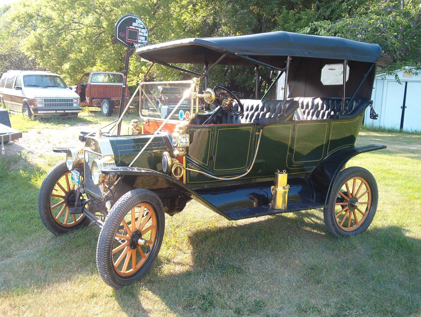

In a year the top will match the existing paint. I'll make a point of it. These are a couple of my restored T's.

Michael, looks like you need new tops on those, too.

Nice Michael!
