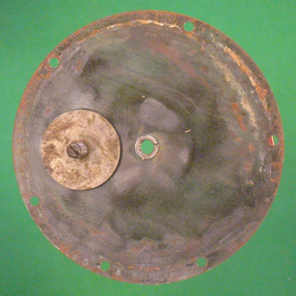

I know that is going to sound like a real strange request...but does anybody have a close up pictures of the diaphragm for a magneto horn? What I want to see is that center post, nut, washer and what-cha-ma-call-it pedestal looking thing in the center (beater?)...looks like close up or if you can tell how it is assembled (that part only), that would work too. I know the screw with the nut on it, is for adjusting the noise, except I'm wondering how does it make that noise with those parts. I'm assuming that the big pedestal looking thing that goes on the inside towards the coil hat, is what is making the noise and the diaphragm is just a resonator, which is amplified by the bell in a megaphone effect. But does it wobble in and out against the diaphragm on that bolt with the jam nut? I know as those coils energize and de-energize it attracts and repels that slug back and forth, what I'm trying to figure out is, if that action causes it to rattle on the diaphragm and adjusting that screw in or out either increases or decreases the (albeit slight) travel of that piece.
Any pictures you may have of this particular part close up so I can see what is actually entailed in its sub assembly would be greatly appreciated, thanks. :)

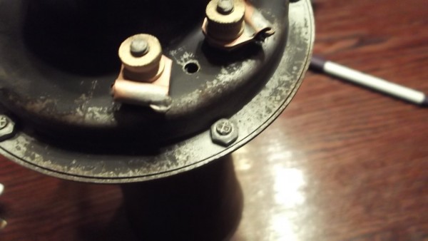

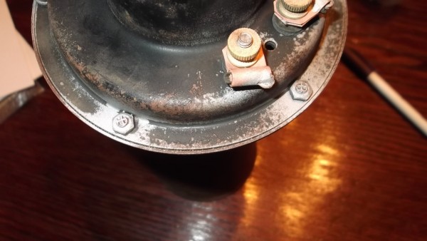

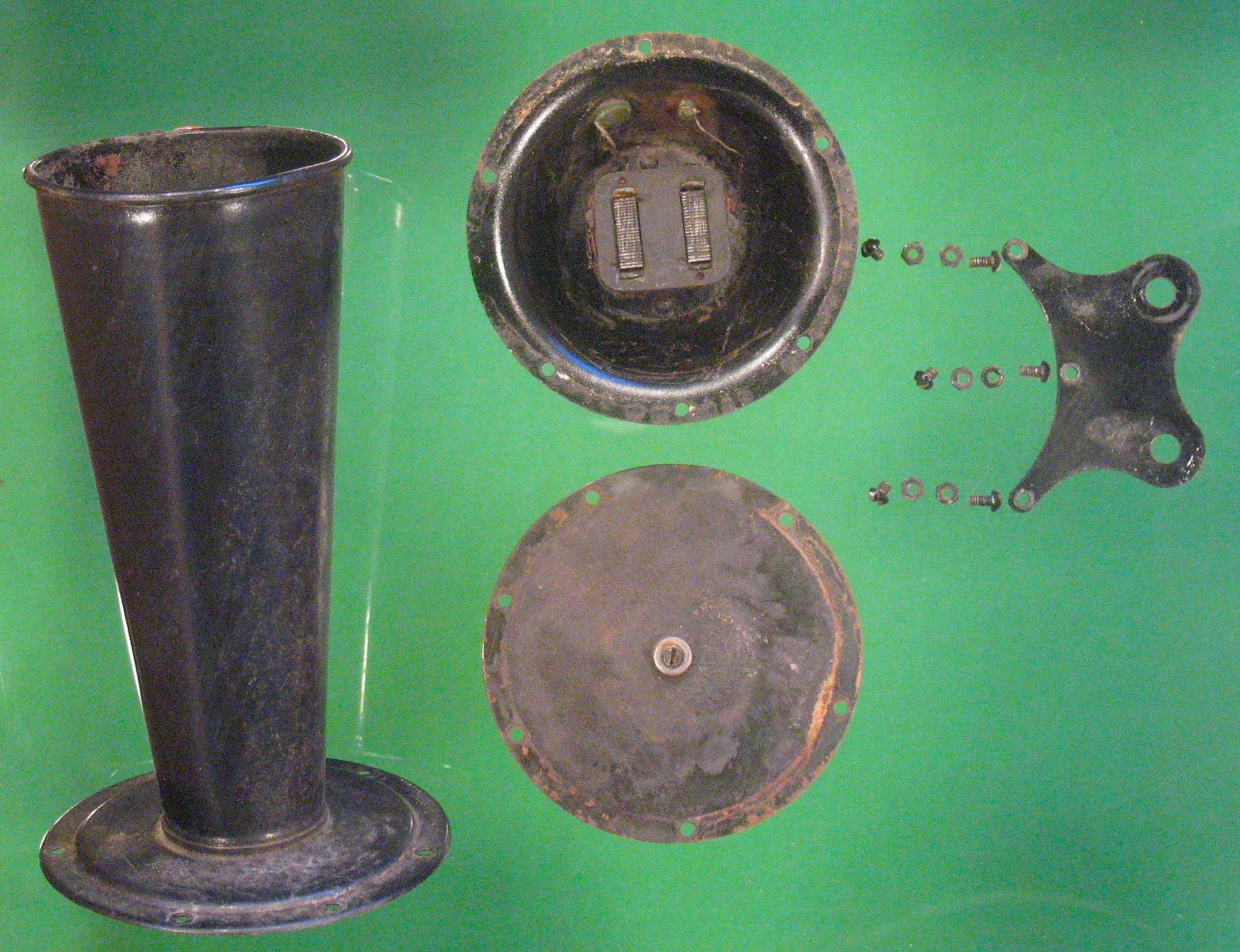

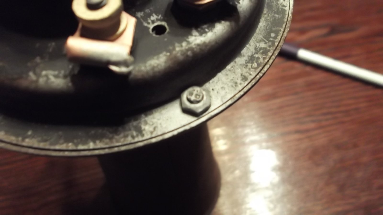

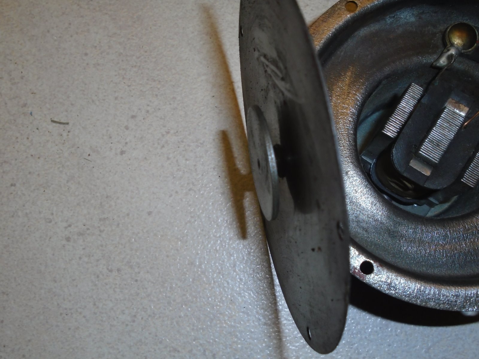

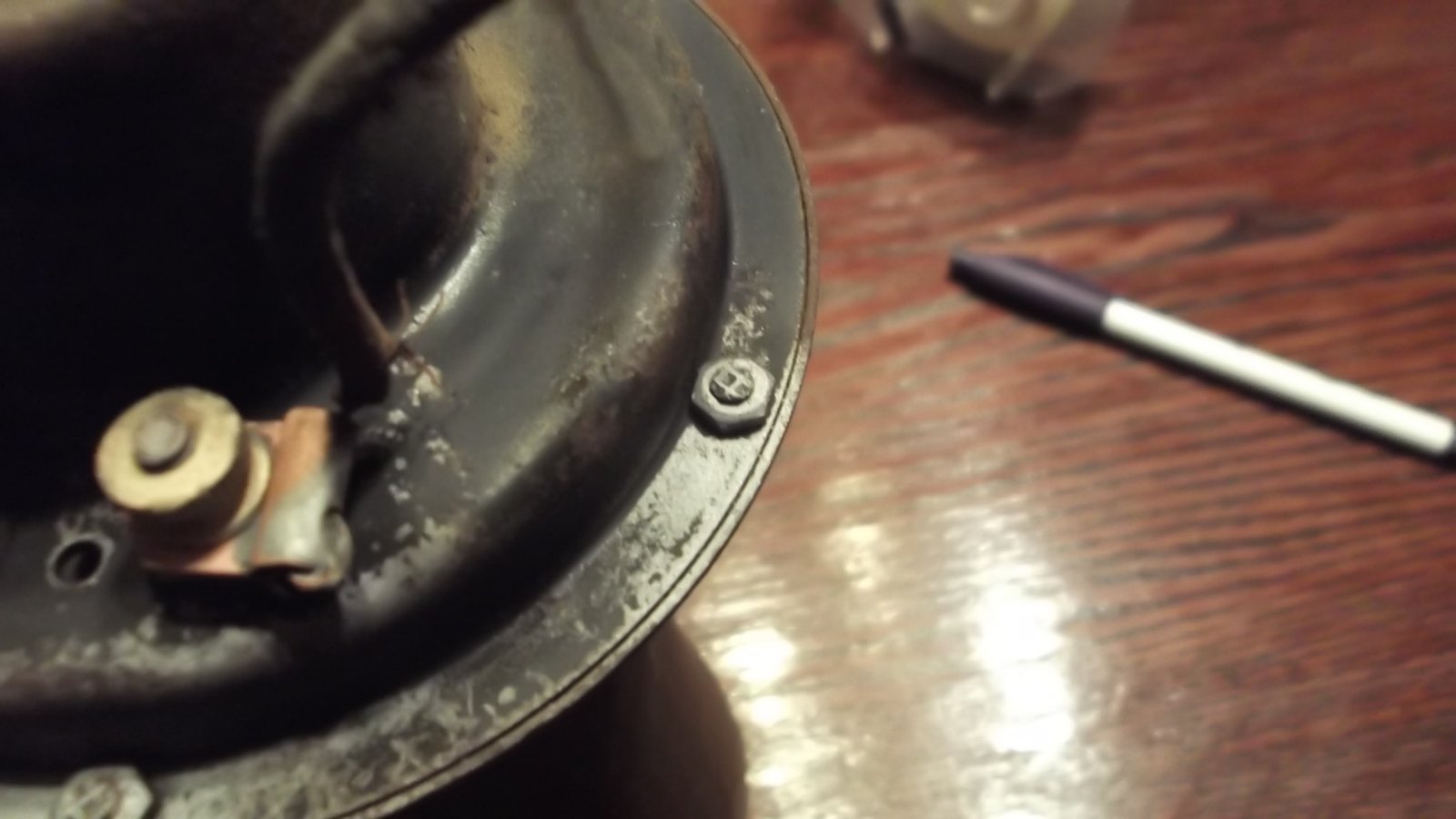

I can only send one photo at a time because it wants to reproduce them in triplicate, these are the innards of a magneto horn that I have.

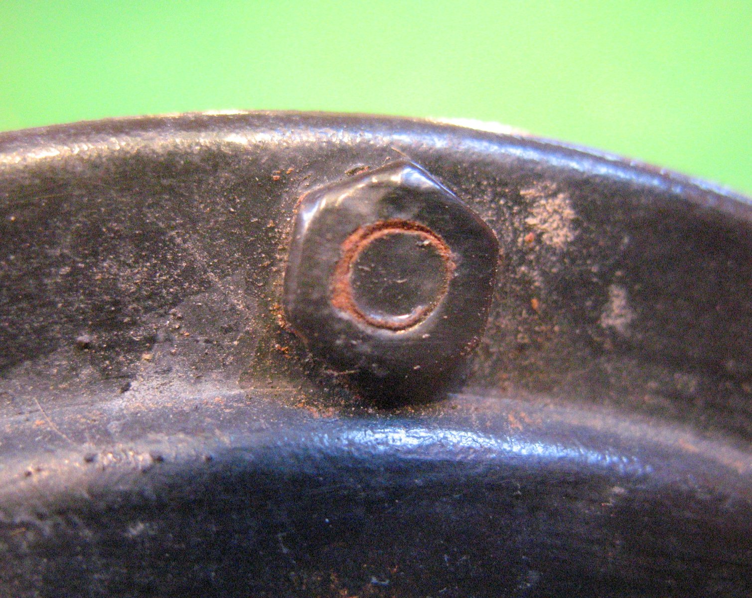

I have not got this one pulled apart yet but notice the staking on the screws. They are all staked the same way with the waffle pattern even the ones holding the bracket on.

I guess they weren't meaning for anybody to take that apart...or the vibration was so great that if unstaked the nuts would back themselves off, as unlikely as that sounds to me...they usually rust in place before they vibrate off.

I don't know if the staking was factory or added later, but seems to be odd that someone would have a waffle pattern setter that was that small. Maybe someone else can chime in on whether it was or not.

That's interesting as that is the same pattern done on the brass magnet clamp screws.

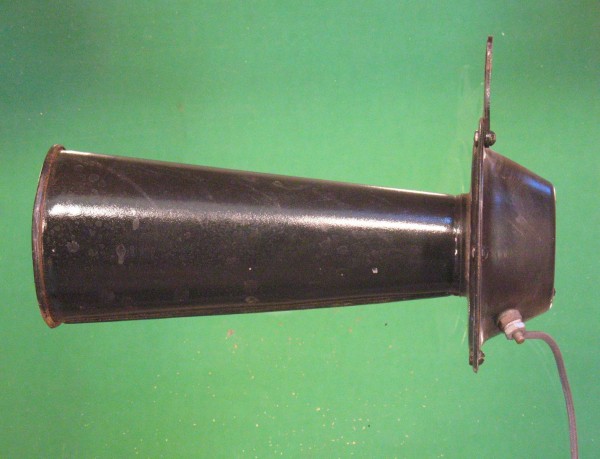

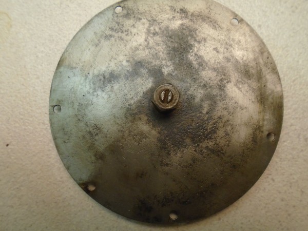

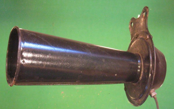

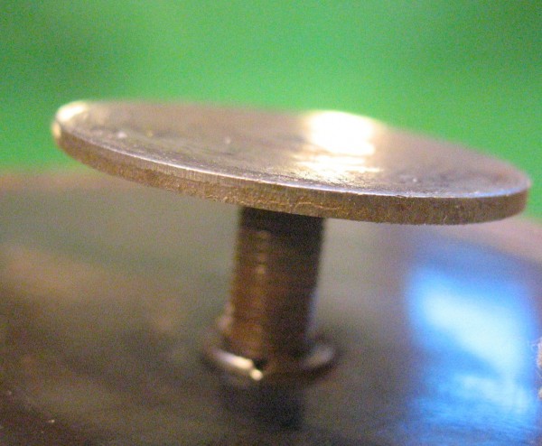

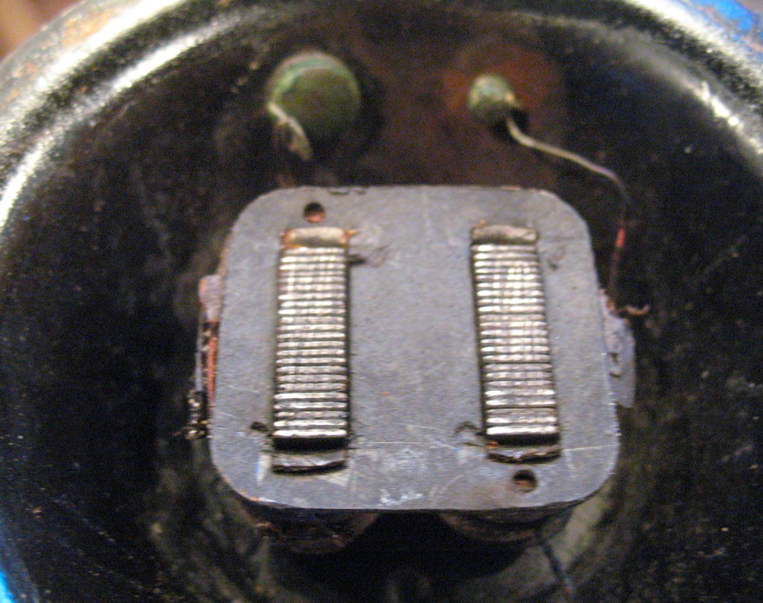

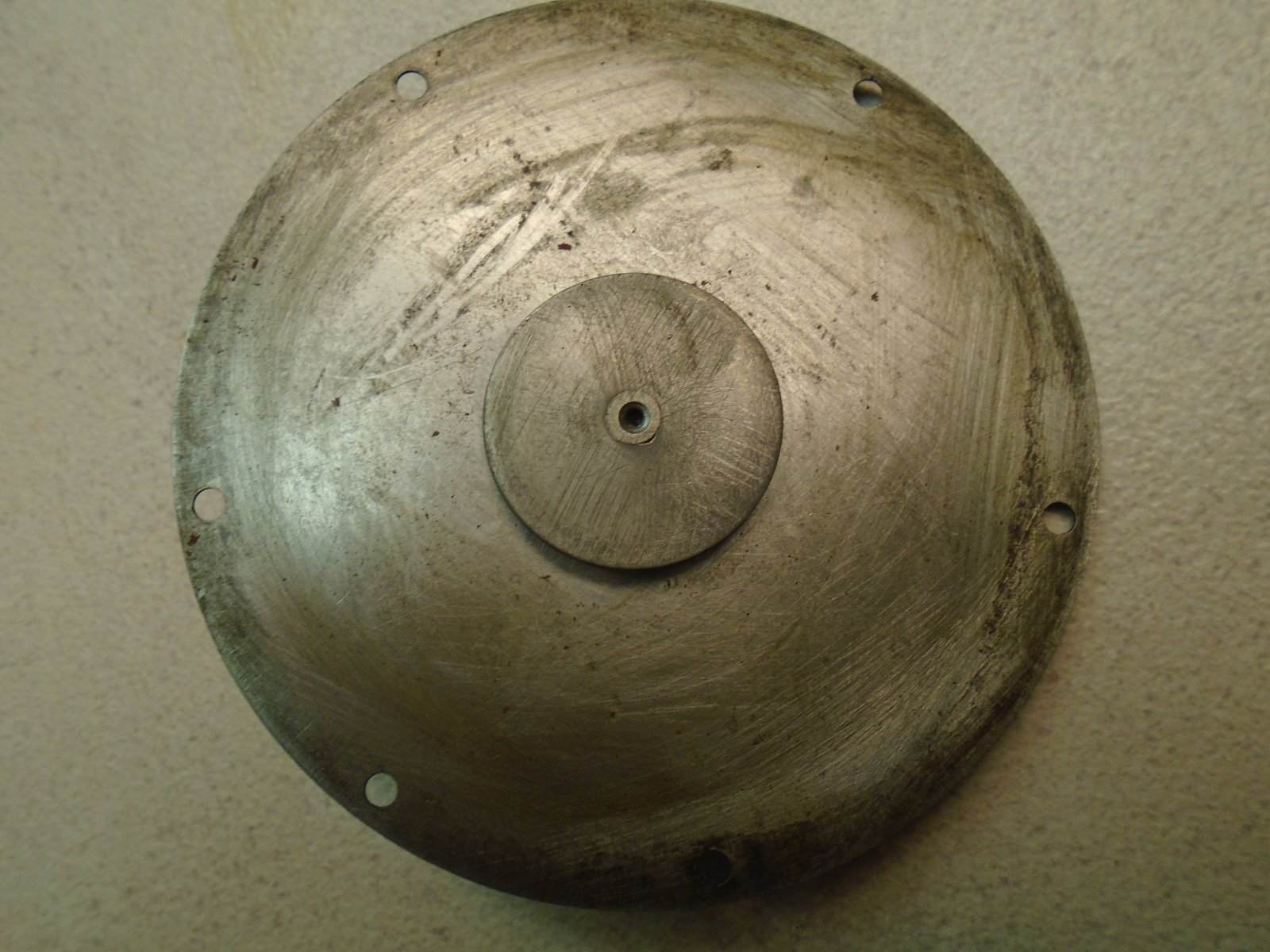

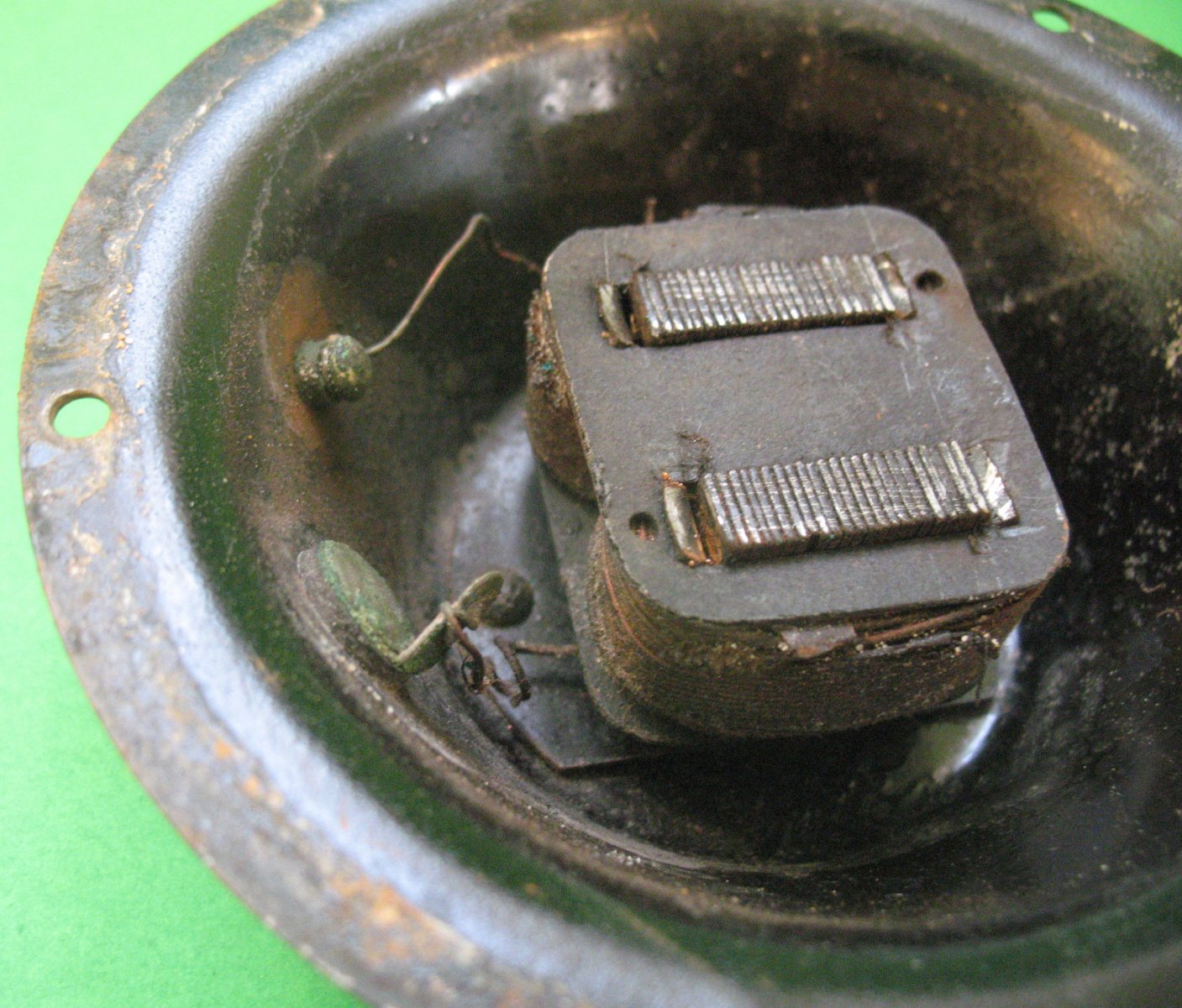

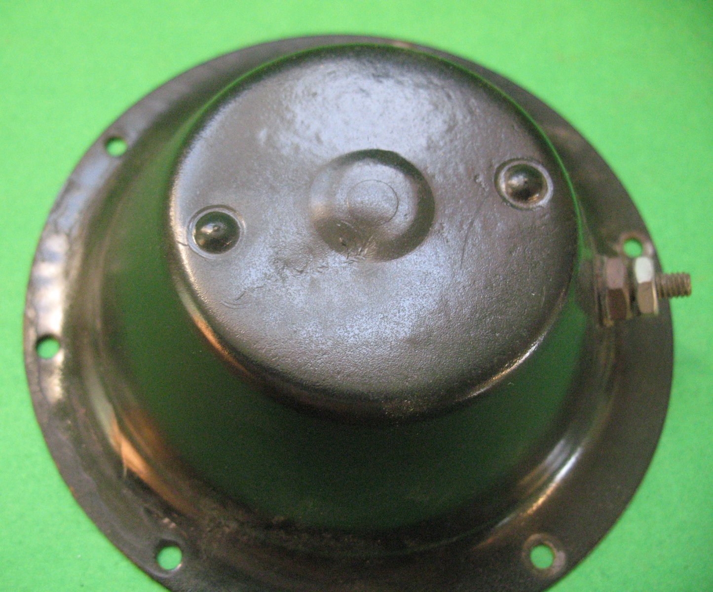

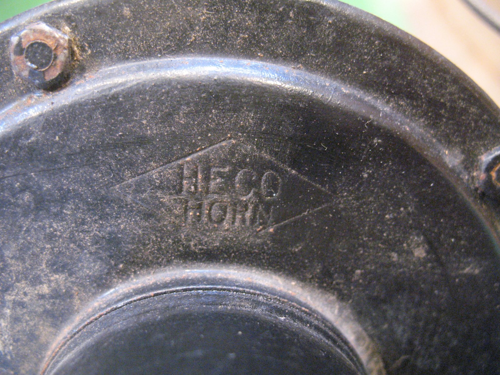

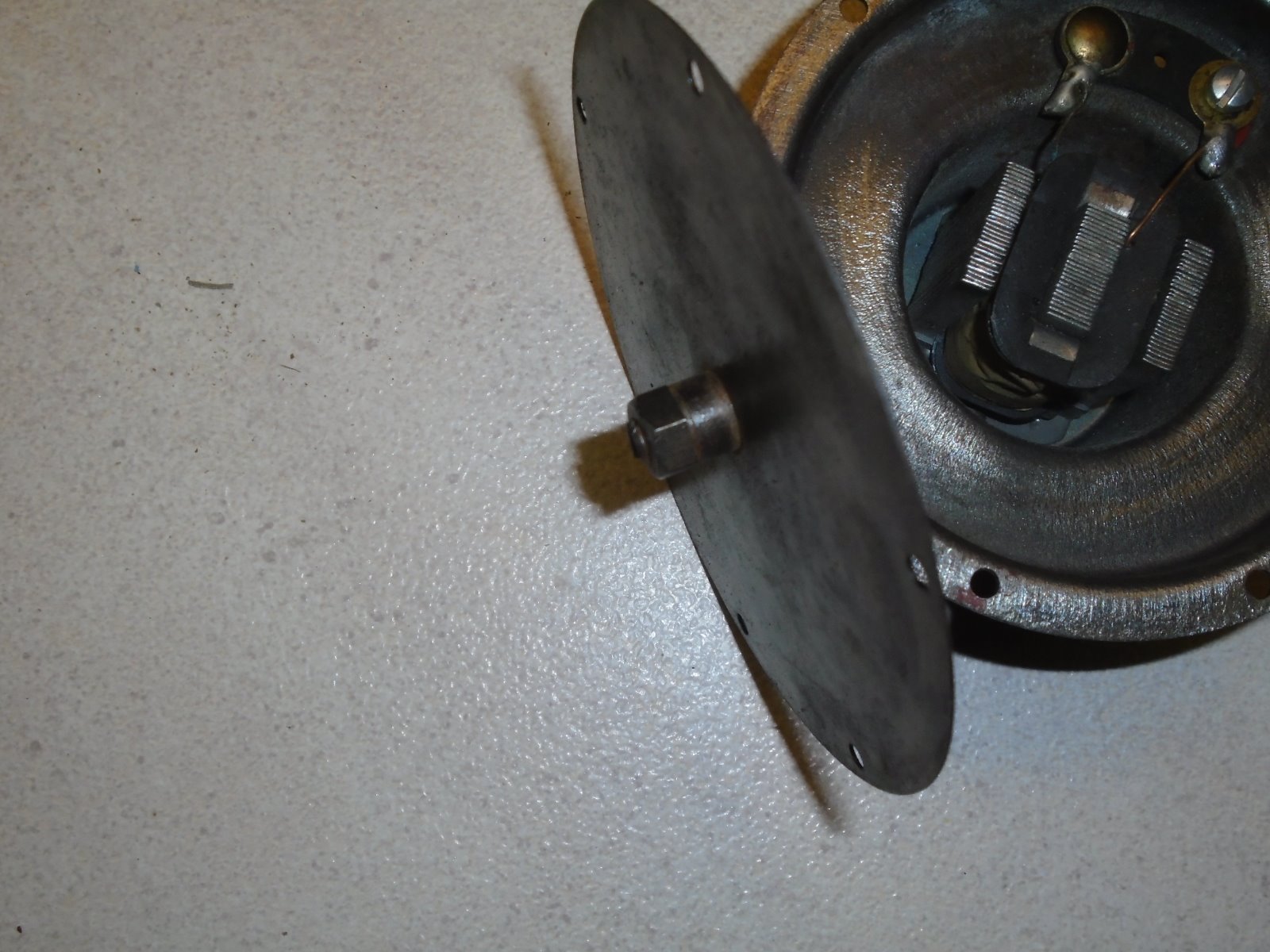

Like many other Ford parts, horns were supplied by several outside manufacturers. All magneto horns can be identified by the adjusting screw in the center of the diaphragm. This is a HECO horn.
The screws are not staked.
I'm working from a laptop that doesn't have the software to remove the reflections.

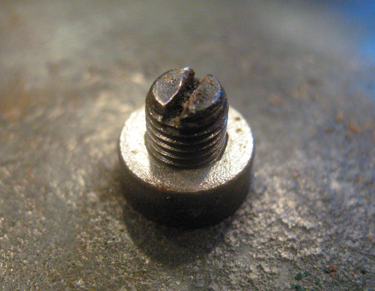

There is a single wire terminal. The other end of the coil is grounded.
The center adjusting nut is crimped into the diaphragm.

Steve, that center adjusting nut with the noise maker/adjustment screw is really the picture I wanted to see. On the other horn pictures of the square hat style it seems that the noise maker (or whatever it is called) is a machined piece with a screw that threads into it...different manufactures, I guess had different methods for making the strangled duck or goose sound...but on those is the nut swedged to the diaphragm also? Or is there something else there in that large hole and those serrations on the nut are for adjusting (like with the transmission adjustment nut)? Also does anybody ever take those coils out of the cap? Every time I see one of these the coils are always part of the cap. I'm thinking that there are 2 clips riveted to the back of the cap that clamp the coils in place or are there posts on the coil assembly that are peened over to mount it to the cap? I know I'm asking about small details here, but that's where the fun is...has anybody you know of ever had to repair those coils and had to remove them?

Steve, there is a jam nut that goes on that adjustment screw right? Something to keep it from vibrating out of adjustment?

One last question...does the "noise maker" beat against the coils? Is that what is making the sound? Because it does sound like a buzzing sound, so it has to be hitting something, right?
Soooo, the diaphragm is a resonator and the sound is amplified by the front end cone and the cone shape is what distributes the sound forward...if the cone were to have a wider bell at the mouth I think the sound would probably be louder still, but probably doesn't so as to be heard over the engine noise, since it is under the hood with that big heavy noisy thing also.
At least on my hand klaxon they put a wide dispersal bell on the cone. so it makes it very loud and it is unmistakably an "Ah-Ooga" sound too and not a loud "Squak" or whatever you'd call that sound yours made...(Steve, I think you need to back off on your adjust screw a wee bit, it sounds too tight to me, thus the "Squak" or "Bleat" and not a nice clean "Ah-Ooga" sound...just my 2 cents).
Fun never quits!
Posts: 7341
Re: Magneto Horn...
Post by Steve Jelf » Sat Dec 21, 2019 5:38 pm

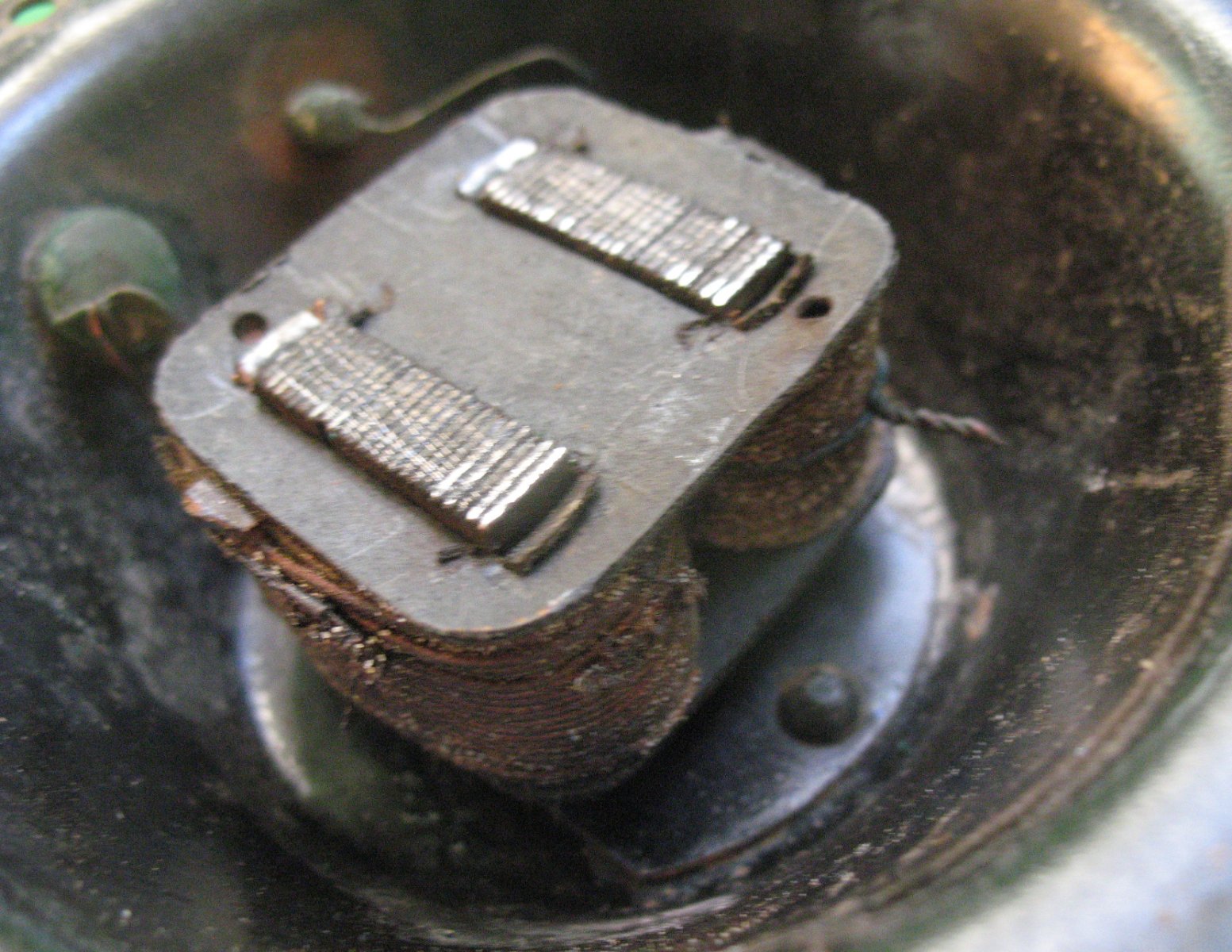

I don't think the "screw" has to beat against the coils. I believe the constantly changing direction of the AC causes the magnets constantly to reverse polarity, pushing and pulling the plate on the end of the screw and vibrating the diaphragm. I don't know if there's supposed to be a jam nut. I didn't find one in this horn.
The coils are held in by two rivets.

So, yours is a 1 post? Does that mean it grounds through the housing and the bracket?

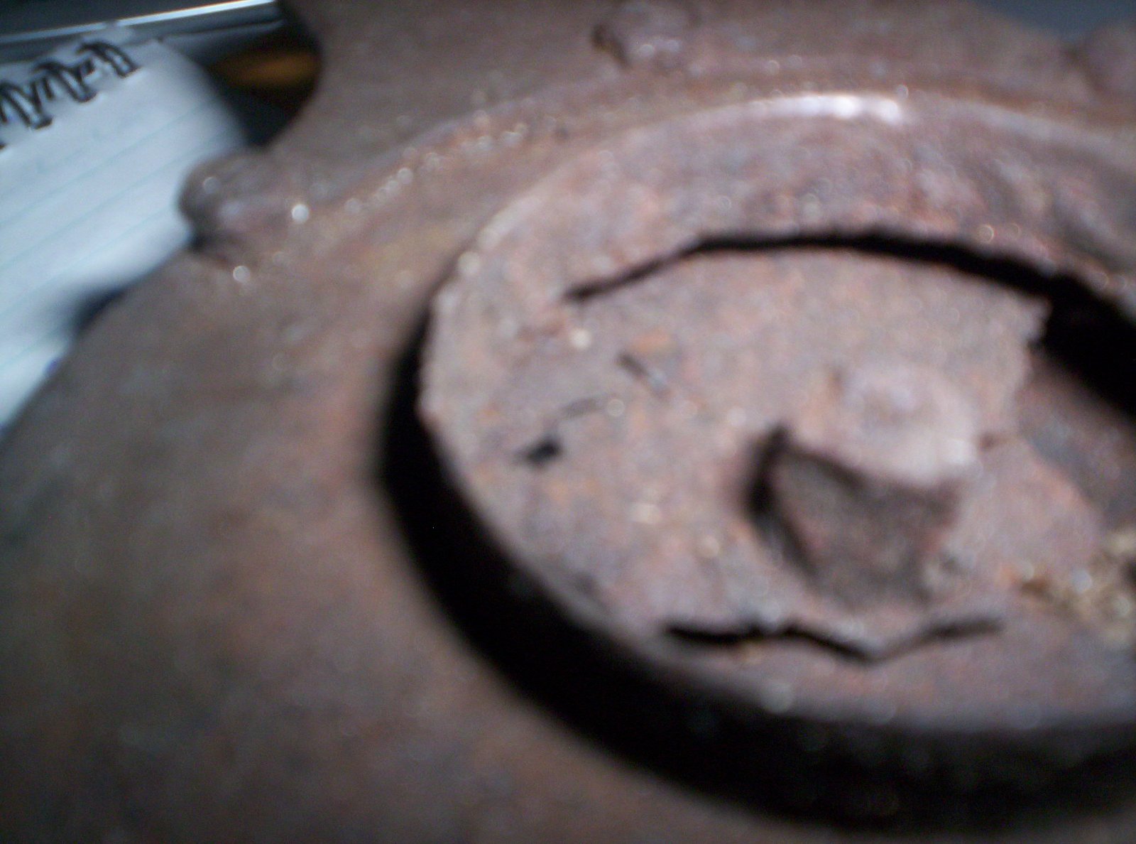

Post by Kerry » Sat Dec 21, 2019 8:10 pm
Martynn
This rusty one I have has a jam nut and 2 wires.
Exactly correct.
