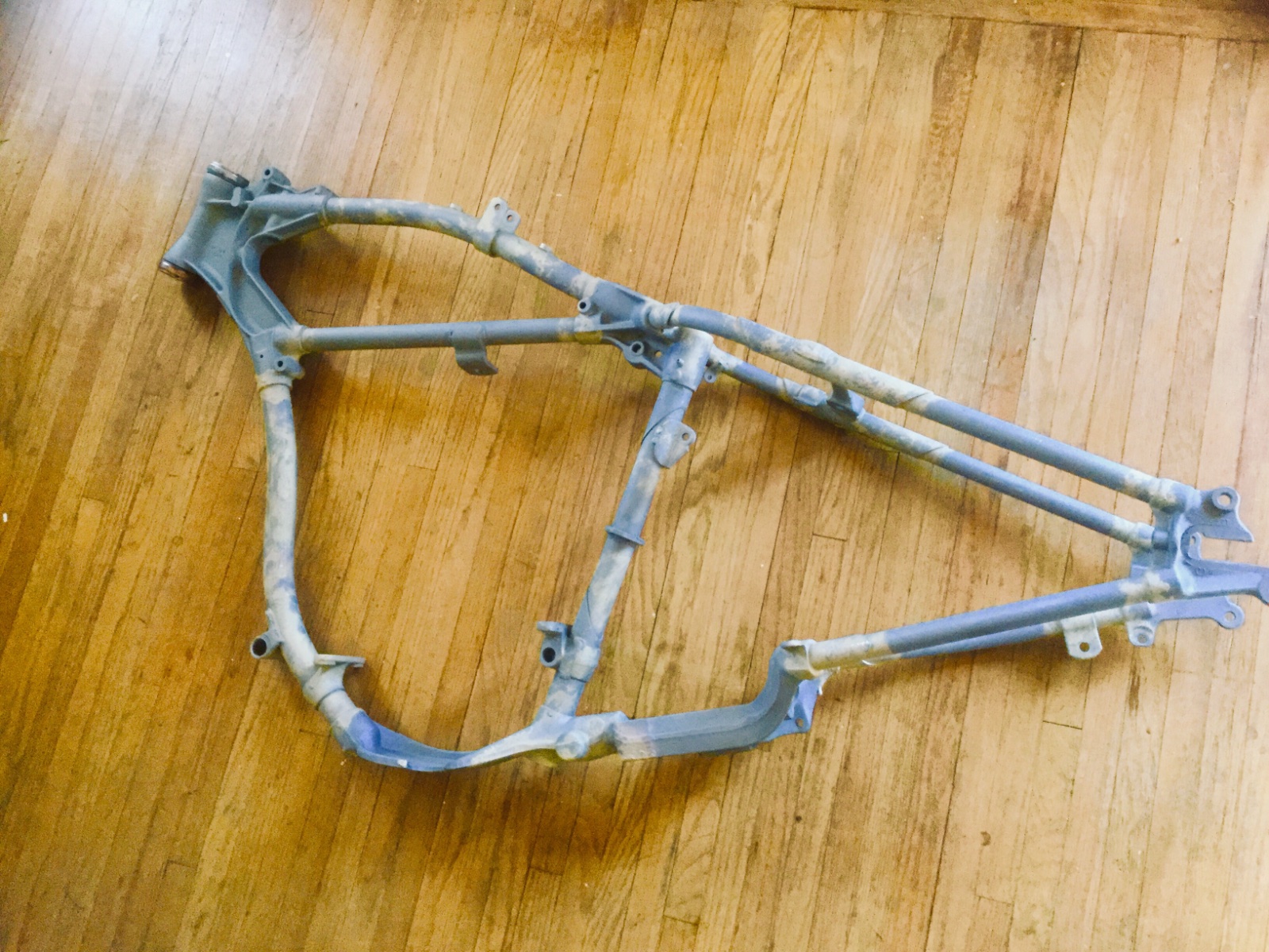

I thought only Ford was sloppy with their brazing during production
I was always amused by the overzealous splatter and puddles of brazing on the Model T Pans during production, but realized that after sandblasting a 40s Harley frame of mine that Harley Davidson was equally liberal with their use of brazing splatter. It’s all over, not just at the joints, similar to the Model T pan. Mind you, these aren’t repairs, this is just the rushed way they did things, whether on the Ford assembly line or during Harley war production

Is that a forty-five frame? Yep, no use scraping off the extra brass. It works like primer and keeps the steel from rusting.

Yes, it is a 1942 Harley WLA I am starting to put back together. An old war horse.

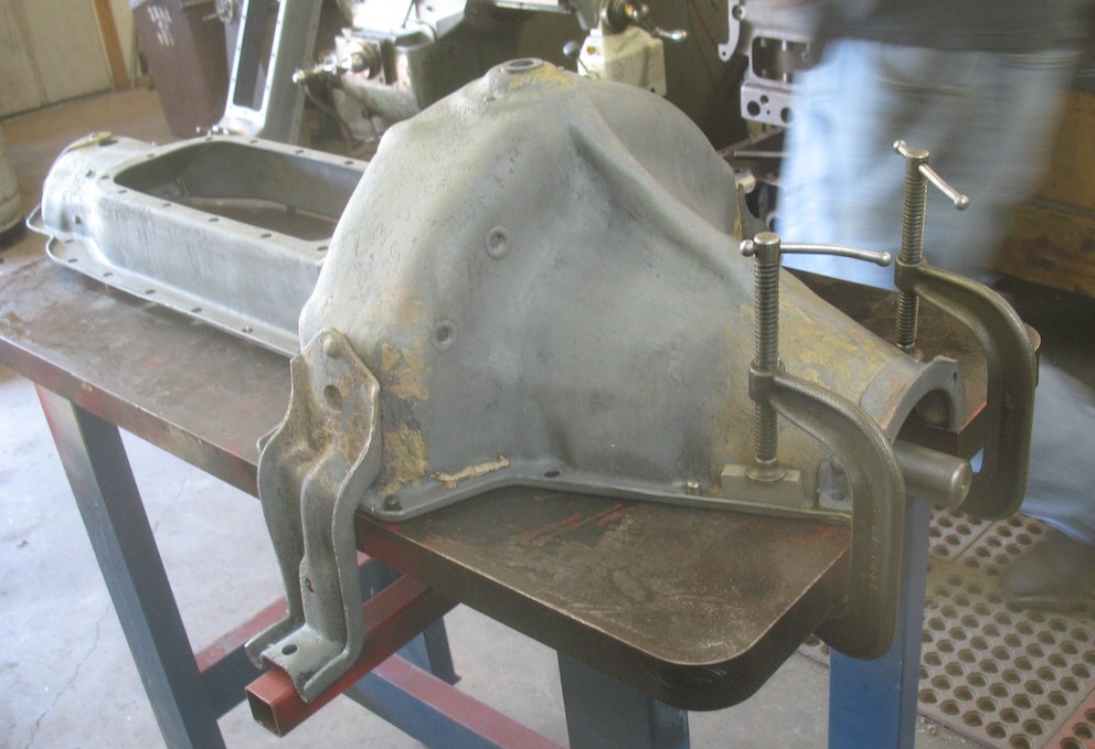

My original 1918 pan was so beat up I bought a good, straightened replacement. I sand blasted it and found brazing in huge "lumps", some of them 1/4" thick! Out came the angle grinder and after about two hours I had down to "presentable". Not perfect, just "presentable". A coat of satin black made it "original"........

Lumpy or running brass on the pan is ‘factory’ , result of methods at Ford. IMO proper to leave the patina of the past on brazed pieces of the Ford

It is lumpy in places, and even has a drip or two. Some grind or smooth it all out prior to painting, I for one, will not.John kuehn wrote: ↑Sun Dec 22, 2019 2:35 pmJust curious if the bike brazing job whether its smooth or lumpy in places.

My hunch is, the H-D frame joints are more like a sweated fit with brass. Almost looks like the leftovers from tinning before sweating the joints together.

I just sand blasted my first T pan and thought it was junk.
Everyone told me it was normal and fine. So that’s the way it is with paint over it now.
