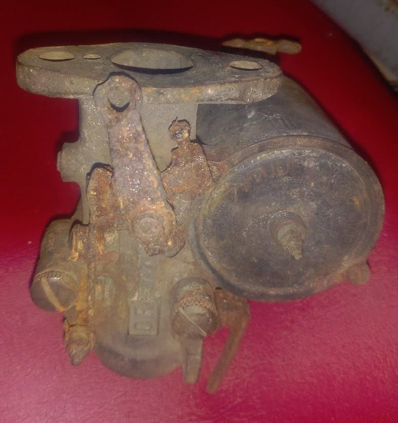

Same carb. It took me an entire afternoon to get it apart enough so I could finish taking it apart. May not have been the worst one ever but it was pretty close

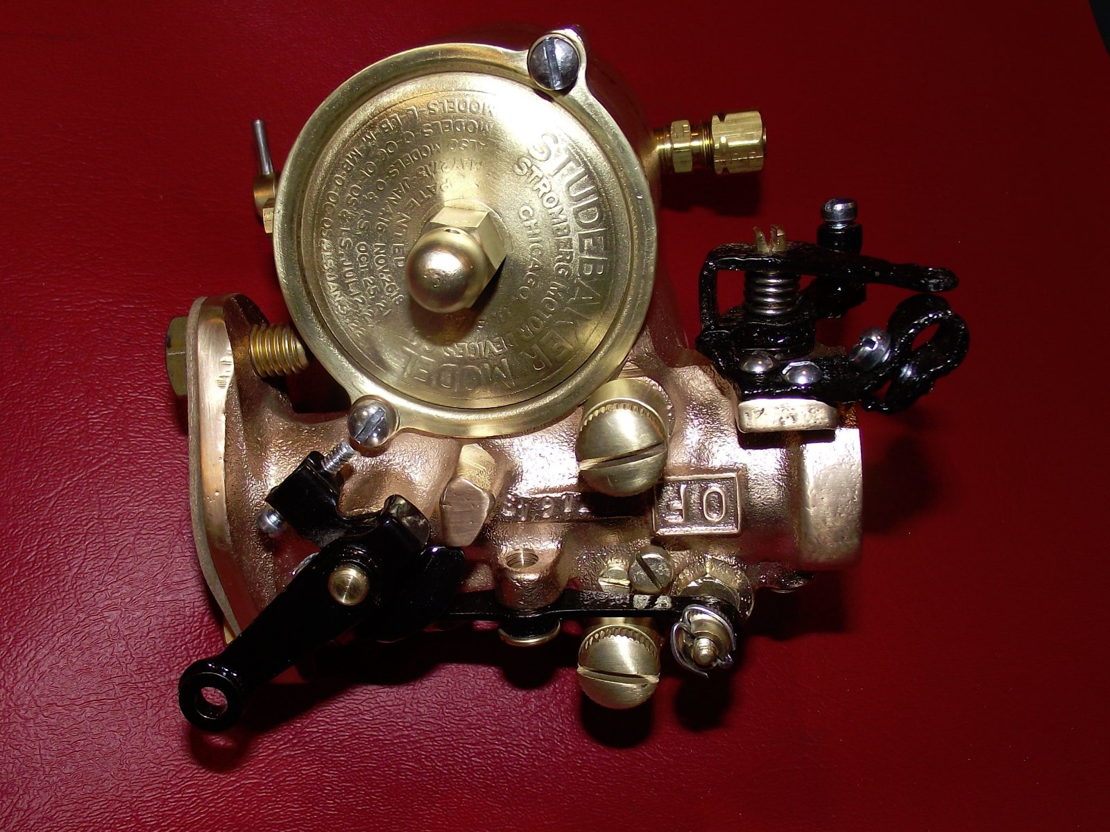

Nice work! Did you have to make the missing nut from the top of the float in the first photo?

Thanks, quick answers before I head back to the shop, trying to get some in the mail today.
I bead blast virtually every thing. I use 70/100 Potters glass beads which tend to break down into a finer dust more than some others. I have an old bead blast cabinet that I've been going to replace for years. I never change the beads, just dump the vacuum once or twice a year when it quits sucking and add more beads. I blast at 125 lbs.
Ultrasonic cleaner. IMHO anybody who isn't cleaning carbs with good ultrasonic is not cleaning them. I have three. The first has some pretty nasty stuff in it to clean passages. The second has some medium nasty with gun brass case cleaner/shine stuff and more of my concoctions. Third has water with some soap to try to get all the crap off from the ultrasonics. Then outside I have a bigger ultrasonic with what is basically lacquer thinner and other goop to try to clean internal passages, etc. It is nasty but usually works. If you don't clean the passages you didn't clean the carburetor. I drill or run a reamer through every passage. I have about every sized reamer you can think of.
Wire brush, stainless steel, .006 3450 1/3 hp. Sanding drums. Buffing wheels, big Baldor buffer outside. It will be a hell of an auction.
Parts. I have 6 lathes of various sizes, two unimats, one Little Machine Shop 8 x 16, one Enco 6 x 19, one Sherline and a Jet Gunsmith 13 x 39. Bought them all new except one of the Unimat SL's. Probably 100 lbs of brass stock from 1/16 to 1 1/2 both round and hex as well as some square. I make most of the brass bolts and nuts I use from stock. I also have two mills and half a dozen drill presses set up for various operations. So make those float caps as well as machine a lot of other parts. I have well over 100 sizes of matching taps and dies from 0-80 to 1 1/2 x 32. Most are older Greenfield tap and die but some are new even tho they are made in China or Japan or Israel.
I have every size of screw from 0-80 up through larger sizes and make a lot of the specialty bolts and pieces, including those float cover caps. I usually make a couple dozen at a time depending on how busy I am. Nearly every Stromberg carb is missing that cap. I also save all the usable originals I get.
I also have probably 20 or 30 custom made jigs and fixtures for various operations.
