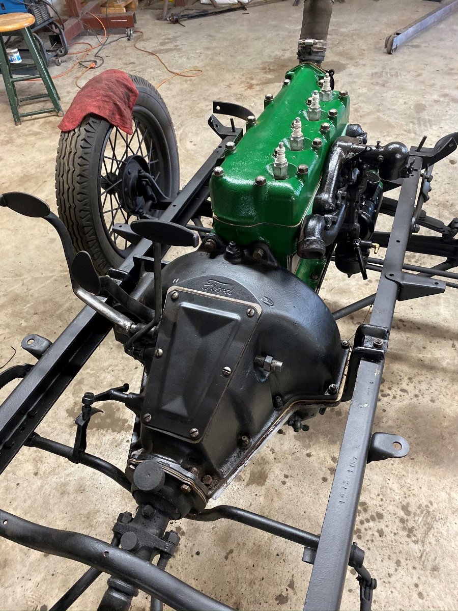

Steve, where did you find that information about the serial number of the motor?
I will try to upload some photos...if I can figure out how.
Danny

Beautiful! Very clean. The paint job, while dull and oxidized from age, looks nice enough to be brought back to a mirror shine with Meguire’s rubbing compound and a coat of Meguire’s paste wax. Jim Patrick

This cutaway at Greenfield village shows the original engine color for 1927.

Does anyone have any kind of photo that shows the fawn gray color?
If it is what I think it is, it is way too light compared to what my uncles are describing to me.
- Posts: 7335
Re: Questions from a newbie
Click on Gallery at the top of this page and go to the 1927 cars.
