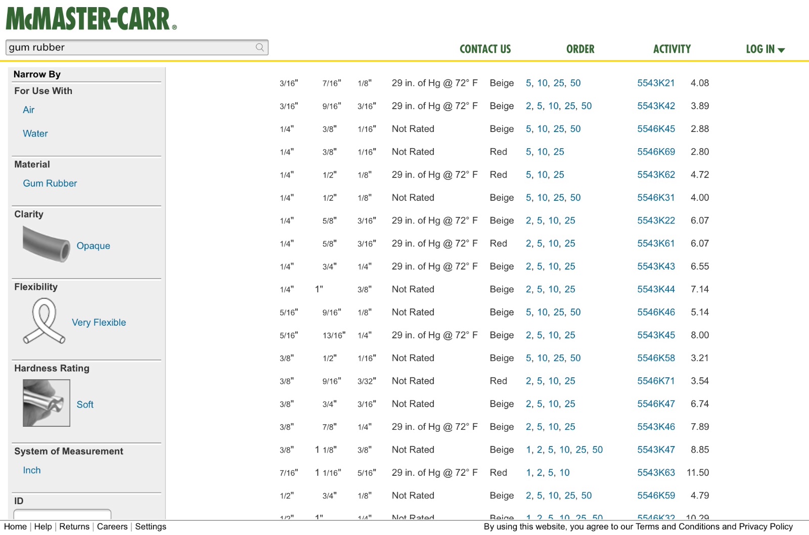

I realize early car people search for red tubing, but from various relics I’ve had in my hands over many years, I do believe the original rubber hose was actually a cream color, or even closer to white. I have some rock hard samples still attached to lamp burners and such that show as off white now , 120 years later.
Ran 8nto the same search for use on real early antique phonographs, ones made before horns were even offered. The sound transmission was so faint, hearing tubes were originally used. Again, surviving artifacts showed a hard white rubber tubing or hose. I was pleasantly surprised to find this through McMaster-Carr supply and it’s a prefect replacement. I am posting a quick screen grab, but those in need may want to check out the total offering. I have some in use that I sent maybe ten years old now and as it’s starting to age, I can see it eventually becoming the same as my rock hard originals.

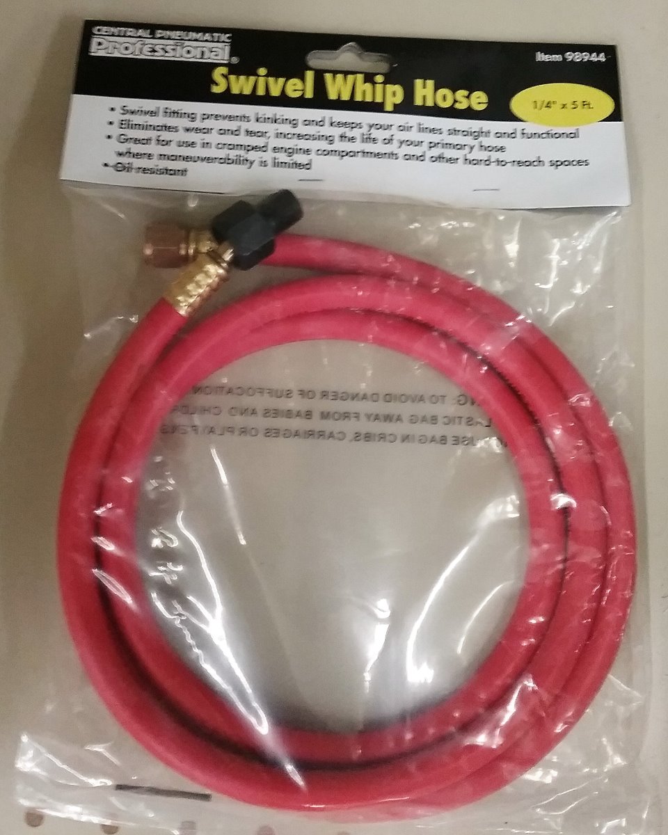

Re: Source for Gum Rubber tubing for Acetylene Hose.
Post by KWTownsend » Sun Feb 03, 2019 11:38 am
Here you go, guys:
From the People's Republic of China at your local friendly Harbor Freight!
1/4" ID, 1/2" OD.
For $5.99 for a five foot section, just cut the ends off. I'm sure the printing on the tubing will come off with a little thinner and rubbing with a scotch bright pad.
Keith

Keith:
The label clearly says it's air hose. Do you think it would do the job with acetylene?
Posts: 1524
First Name: Keith
Last Name: Townsend
Location: Gresham, Orygun
Post by KWTownsend » Sun Feb 03, 2019 11:06 pm
Larry-
I would not hesitate to use it!
