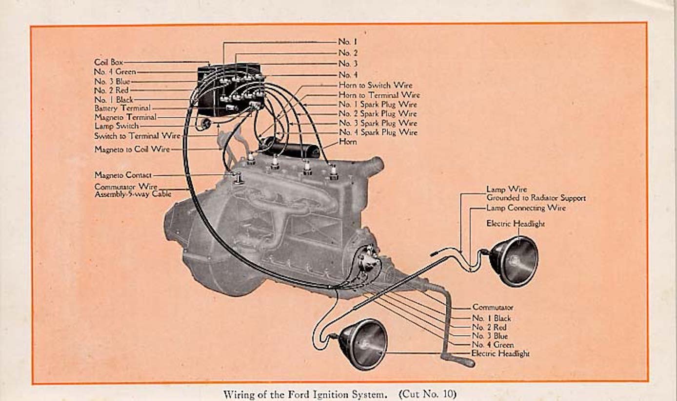

Either the passenger side headlight socket is grounded or there is a short to ground somewhere in the wire that goes across to the drivers side. If the drivers side bulb was blown neither would work.

He is having the problem with magneto headlights. They are wired in series. I don’t quite understand how one can work and one not since the current has to pass through both. If one burned out, neither one lights. Seems like it would have to be a ground problem.

Come on, guys. We're takling 1915 here. Mag lights. Of course they're wired in series, just like those notorious Christmas tree lights that all go out when one dies. I'm an electronic moron, and even I understand this.
If John's lighting setup is stock, the circuit goes like this: From the switch to one contact on the right side bulb; through the filament to the other contact on that bulb; through the wire to one contact on the left side bulb; through the filament to the other contact on that bulb; through the wire to ground at the radiator support.
Why didn't I mention the sockets? Because all they do is hold the bulb bases in place. They're not part of the circuit.
My guess is that John's left light has a short between the two contacts behind the bulb, in which case the current is taking the easiest path, through that short to the ground wire and skipping the bulb. Either that, or there's a ground somewhere between the right and left lights.

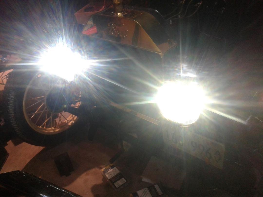

I think Steve might be onto something. I converted my magneto headlights to LED's and wired the sockets in parallel. No matter what I tried, the right one would not work. I got a new socket and no problems ever since. It seemed to check out OK but put a bulb in and it was a no-go. Unfortunately, the only way to see what is going on inside between the socket and bulb contacts is to cut the socket open.

Hey Steve, Yes my T is wired exactly as laid out in the diagram (stock). I have some wire and a test light, I'll play with it this weekend and see what I find. They worked fine at OCF (although useless with 24V bulbs) The ones I'm trying are older bulbs that I picked up so it may be a contact issue, or lack there of, in the socket assembly, as suggested. Thanks to all for the leads...

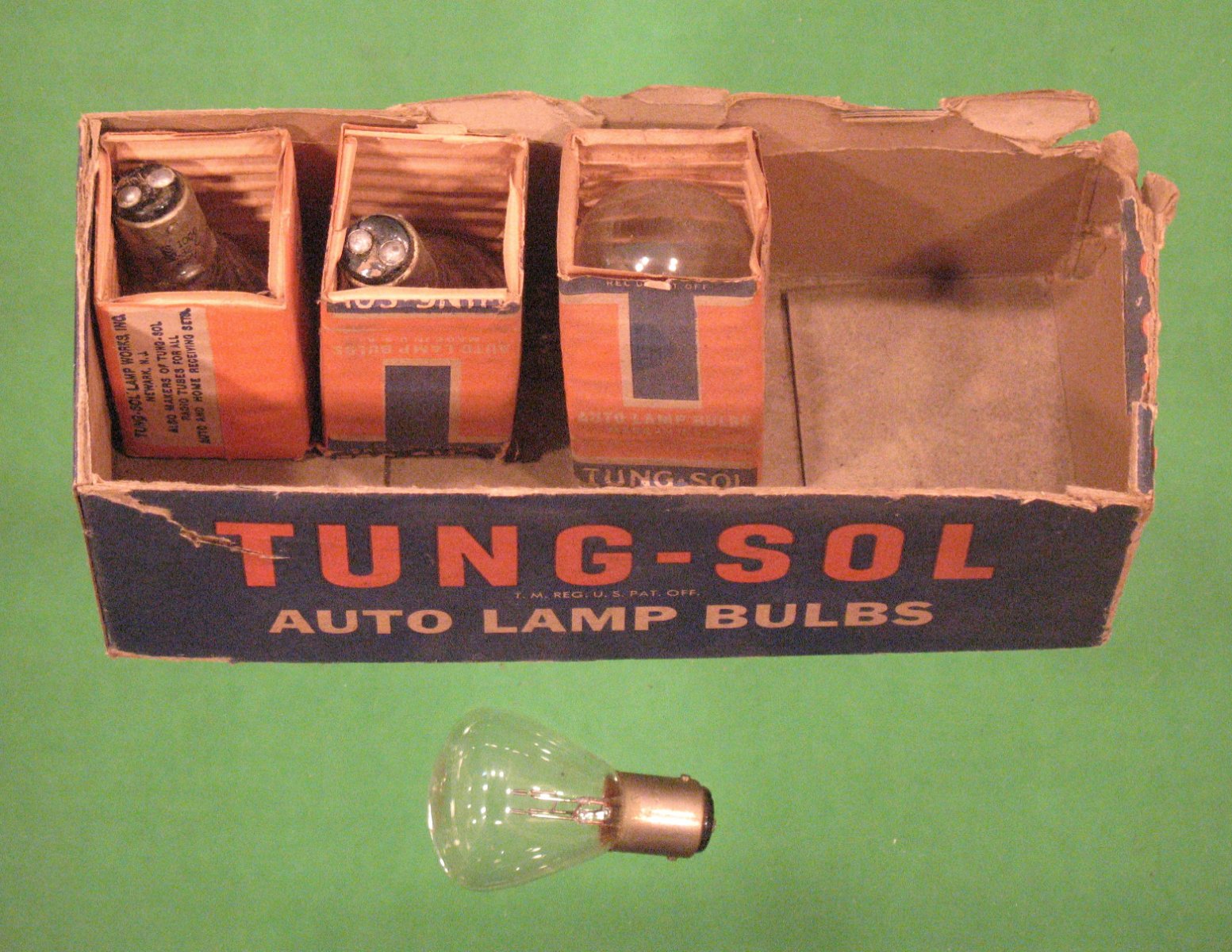

Yes, the 24v bulbs allegedly for use in mag lights are useless. Fortunately original bulbs can be found at swap meets. There is a problem with those too, though. In some of them the cement holding the glass in the base has let go, so when you try to install the bulb in the socket the glass twists in the base and the bulb is ruined. This is pretty annoying when you're on a trip and all seven of your replacement bulbs suffer installation destruction. You can count on all the local parts stores to have nothing that will work. One of my winter projects will be applying new glue to some bulbs to see if that cures the problem.
Mag bulbs are two-contact, even pin. The real ones are supposed to be 9v, but I find that bulbs marked 6-8v in this configuration last pretty well and are very common.

Those pictures are some of the ones I picked up as well

My T is a "Cyclops" no more. I now have two working headlights. I switched the bulbs from one side to the other, and now they both work. I suspect the driver side bulb wasn't making a good contact, and so the passenger side bulb found an errant ground. Switching the bulbs must have reestablished a good contact in both bulbs, since now they both work.

Actually, there were two us 1915 owners with the same problem, I don't believe the original posters problem has been resolved.
