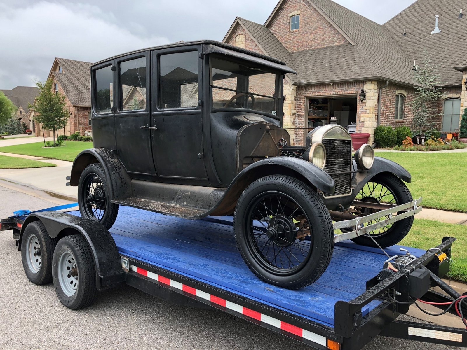

Re: Questions from a newbie
Beautiful! Very clean. The paint job, while dull and oxidized from age, looks nice enough to be brought back to a mirror shine with Meguire’s rubbing compound and a coat of Meguire’s paste wax. Jim Patrick
That is actually a black primer that my grandfather put on it before I was born.
The original color is gray and is under that primer. We are planning to put it back to it's original gray color.
Are you sure the black is not the finish and the grey underneath, primer? Primer from that period was usually either grey or rust red. That black looks too good to be primer. By 1927, Ford had the paint inventories under control so that virtually all Fordor bodies in 1927 were painted Windsor Maroon while the fenders, running boards, splash shields and radiator apron were black. I don’t believe grey was a color in Ford’s 1927 Fordor color selection inventory. Jim Patrick
i would have had a hard time taking that car apart if it had my granfathers.In that good of shape.I woulda cleaned it up and drove it !That car is in good shape!

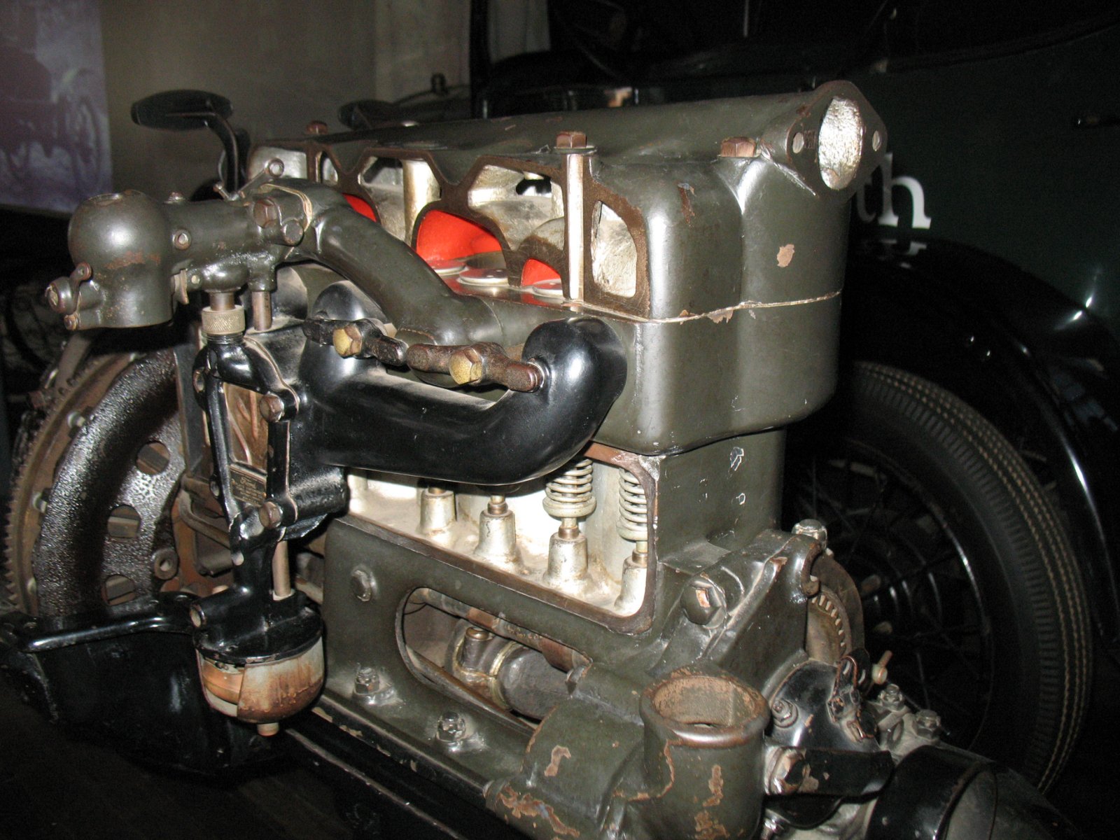

Danny, the serial numbers and dates are listed in Bruce Mccalley's Model T Encyclopedia. It also tells you about paints. As you can see here, yours would not be the only gray 1927 Ford.
This cutaway at Greenfield village shows the original engine color for 1927.
