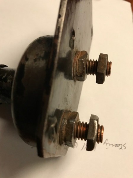

....Ahhhh....Nothing like a break in the weather to work on my old ‘Tin Lizzie,’ right?
So, I have a few forum members coming to have a look at my ‘26 Touring on Sunday to lend a helping hand-Something I greatly appreciate the camaraderie of the members of this club! Before they do head down, however, I have a question:
My starter switch had a bad habit of failing to do anything-I bought a replacement switch and installed it. Now, every time my heel depresses the switch, the sparks fly like sparklers and nothing happens. Naturally, it’s shorting out when the circuit is completed.
I’ve checked my connections. On tight. Is it possible that when I replaced the switch, I may have lost some form of insulating rubber/fiber washers to the frame that may have served as an “insulator?” As of now, everything is simply bolted metal-to-metal. Meaning the switch plate is simply bolted to the frame. Did Ford use any such thing? I’d like to help the fellers out a bit in advance-As well as possibly save them some diagnostic time! Thanks, gang!

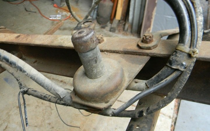

So, sparks at the newly mounted starter foot switch? Indeed you have a wiring problem.
The foot switch only interrupts the positive cables from the battery to the starter motor.
The battery cable goes to one terminal on the foot switch, the starter cable goes to the other terminal on the foot switch.
So, there must be a ground somewhere when you hit the button with your heel. The switch internals are insulated from ground, mounting the switch plate to frame won't make a difference. Guessing a dead short in the starter motor may be a cause.

May just be the cable heading to the starter is to close to the frame or something. I put a soliniod on the T pickup and it seems to work good. The foot switch will probably outlast me due to that.

Try unhooking the starter wire at the starter and then try the switch, if the sparks are gone...probably inside the starter. If not, the wire is grounded somewhere.
- Posts: 6609
Re: ...Holy switch, Batman!!!!!
You could have a short inside the switch or in the wiring from the switch to the starter motor. Discount the wire to the starter motor and then see if there is continuity from the starter post that it was connected to to ground. If so bad switch. Any other wires connected to that post? Should have insulators around posts inside and out. I'm using a solenoid too ever since I saw the inside of the FORD starter switch - afraid that I may shock myself stepping on that thing. When you step on the plunger a bar on it completes the connection across the two posts. Everything is surrounded by metal - think about it

Easy way to determine if the starter has a dead short is to remove the positive cable connected to the starter and insulating it so its not grounded, then hitting the switch briefly. If nothing happens, then the starter probably has a dead short someplace. If the problem persists, check switch or wiring for grounds and look on the positive side: your battery is good.
