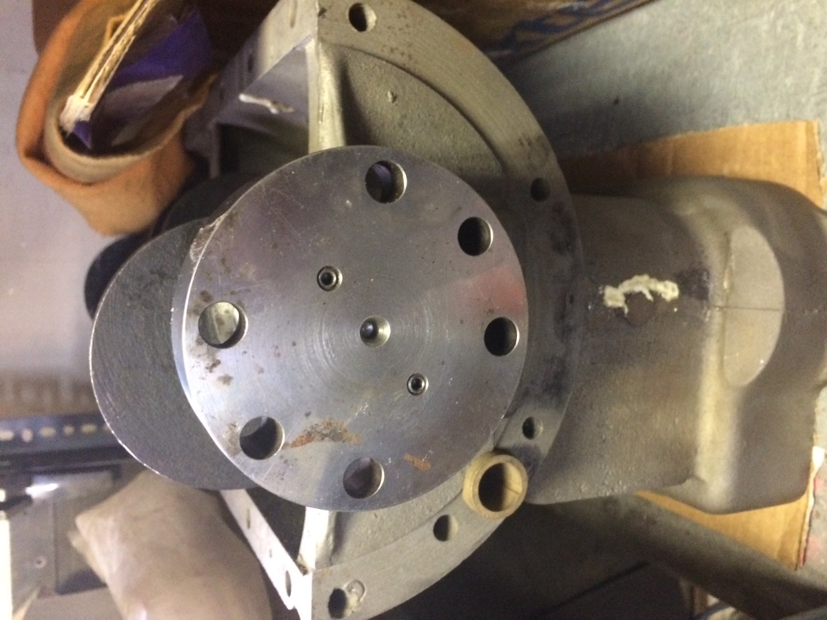

If you study the old “speed manuals” apparently over size cranks were made featuring 1-7/16” mains and 1/3/8” rods based on the concept that the stock main caps and stock rods could be used. I have tried the idea and it works okay.
A alternative to moving the block ahead is to shorten the back of the A crank using my taper and shrink fit approach. It does require shortening the rear main by 3/4”at the back

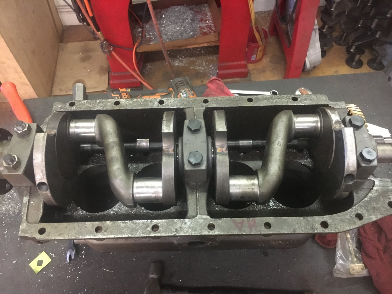

I'm not an engine builder but here is a picture of my 1926 Model T block with a Model A crank.
I'm having it build by a good friend. Hope this will help someone.

I got to thinking about the moving of the flange last night. What about threading it on, then using locktite and pins?

I’ve done 3 A crank conversions. I’ve always kept the mains stock A size and used custom main caps. I line bore the block right to the edge of the bolt holes. Then I use bolt dowel sleeves to have precision fit of the caps. I agree with Kevin on thin babbit
