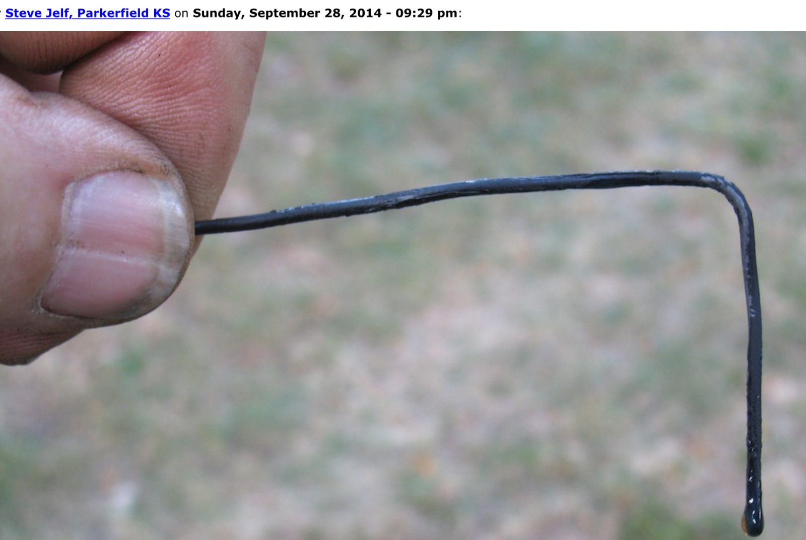

For early pumpkins with the fill hole high up, best tool for level measure is the ‘Jelf Check Wire’ ;)

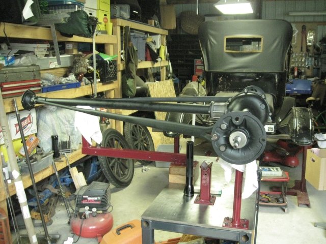

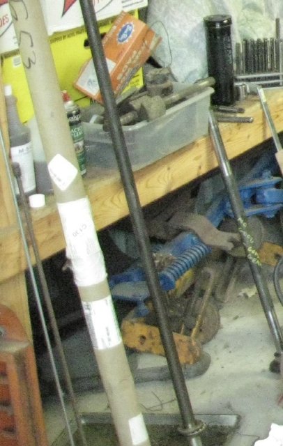

During the last rebuild I filled the axle while it was on the stand, before attaching the torque tube and radius rods. I was able to see the level inside the axle, I know that this does not help if you are refilling with the axle together and in the car but the amounts would be the same. This is a "later" axle with the fill hole/plug below the center line of the axle housing and it took just a little more than a pint of gear lube (1/2 a quart). Where the ring gear is in the bottom of the housing was covered with gear lube and the level was about 3/4" below the fill hole (looking from the inside). The differential had been rotated/turned to make sure that the lube was not just sitting in the bottom of the housing but was also covering all of the moving parts inside.
In the far left, lower corner of the photos above you can see the gear lube sitting on the shelf (next to the can of spray paint kind of hiding behind the cardboard tube from the new drive shaft), one full and unopened bottle and the one that is "half" empty that was used to fill the axle. Again, sorry for the photos, they are the only ones that I have.

I measured the amount of oil required to fill the pumpkin to 1.5 inches below the fill hole and came up with 20 ounces. I also pre-greased the hyatt bearings before installation. I made a Jelf tool to check levels and it has remained about where it is supposed to be. My rear end runs very quietly using Lubriplate APG 140 that I got from Langs. I'm using modern neoprene axle seals and so far no lube has escaped from the ends of the axle tube. Too much differential lube and lube tends to travel out along the axles.
