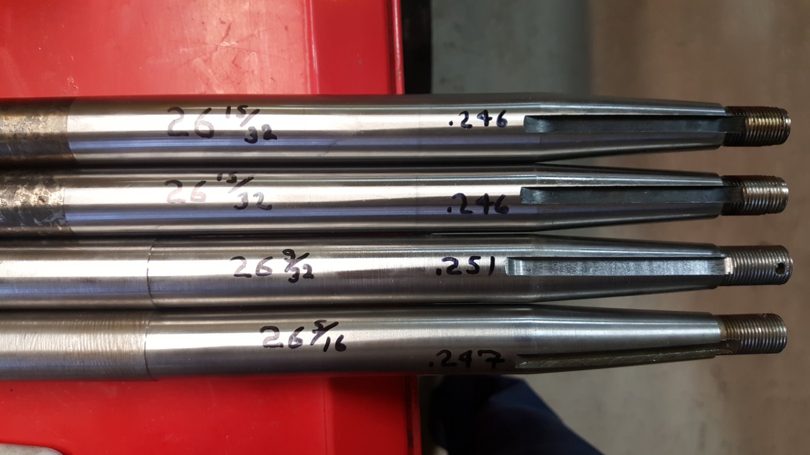

Re: shorten real axle shaft
A friend and I just made 4 axles (as we wanted them significantly longer). IF you have a good lathe WITH a taper attachment (I don’t mean the “compound”), the taper is 3/4”per foot radially (1-1/2” per foot diameter)(taper attachments I have seen will have one or the other of these scales).
Just to check try a chunk of surplus material.
Personally I would alter the inboard end.

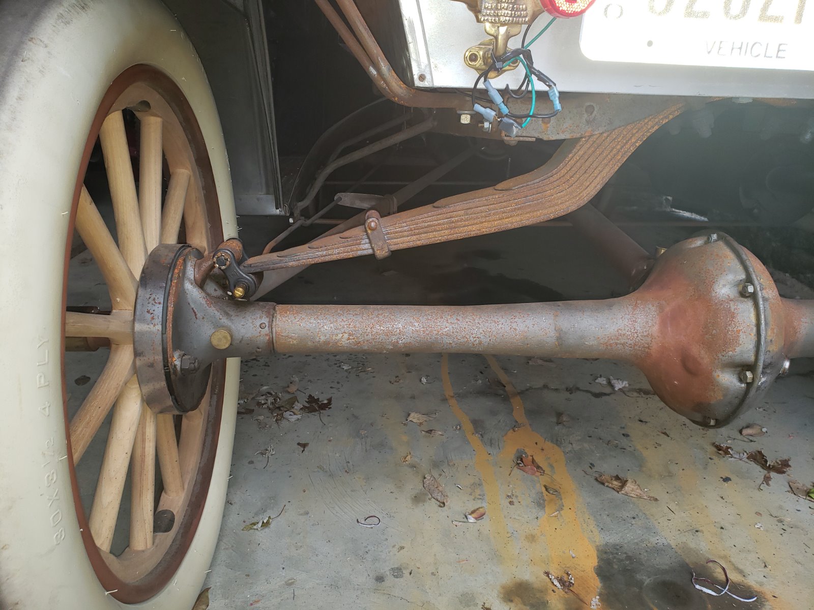

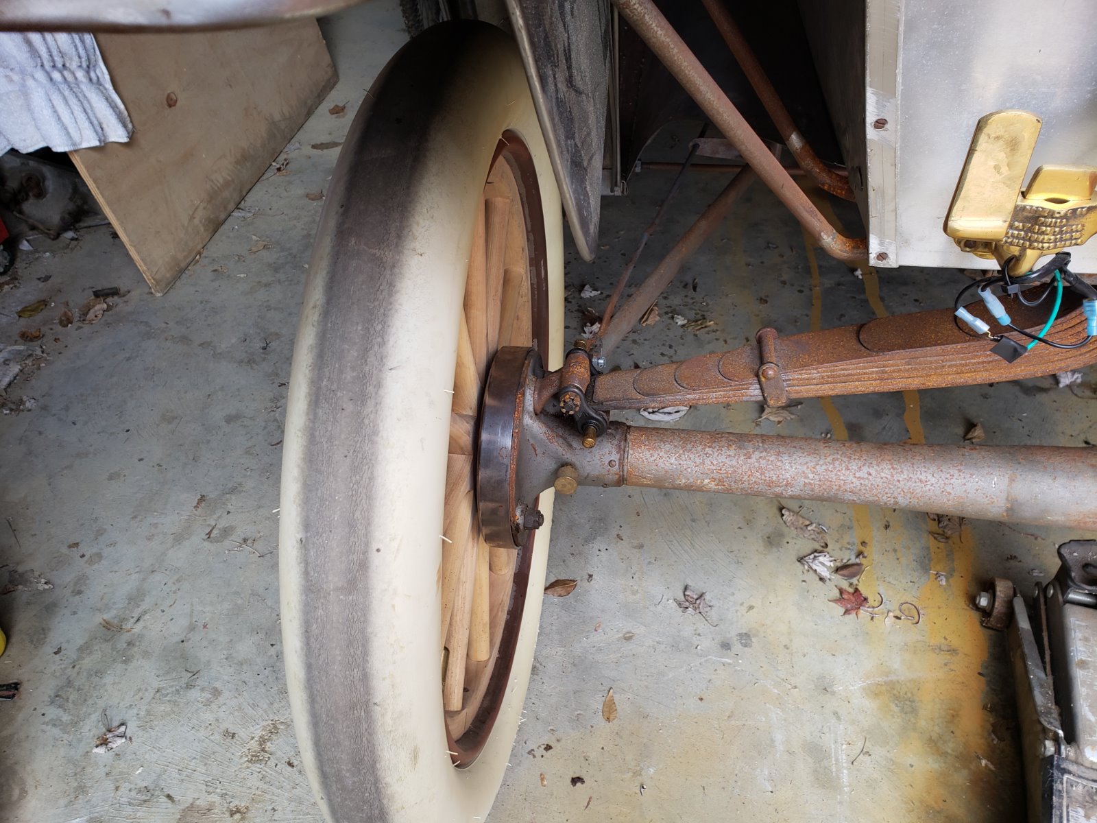

This shows the .16" gap. No it's not horrible, but no need to have these calipers showing if this can be addressed.
When shot in Brewster Green and pinstriped this would not be as conspicuous. However, got a ton of time in this rear end, and will have much more with the finishing work complete, so I'm wanting to work all of the cosmetics while the scrapes don't matter.
Regards,
Scott

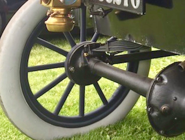

- Posts: 4046
Scott
With your photo can see that gap is a bit more than earlier cars show at the backing plate / drum junction.
Your fixes may be best, Would first double check all the parts are fitting correctly. Sometimes the grease retainer cup on the axle housing isn't seated all the way, that could let the hub stand proud of the backing plate. Could check again and fit the rear wheel without the brake shoes on, to be sure the drum and hub are all the way on the axle, and fit as they should.
Early axle with normal like gap.

Re: shorten rear axle shaft
A member here was kind enough to send this shot of axle length variations that are consistent with .16 overage that I'm seeing. Also notice the 3rd shaft down has the cotter hole aligned with the keyseat. If not mistaken, this Ford machine drawing shows this hole perpendicular to the keyseat ...not that this has any functional impact. Regards,
Scott
Scott

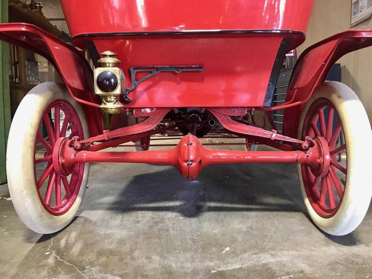

Much like my example, this early 09 rear end has similar random drum gap showing on both sides. This known car has the original style straight axles, where adjusting the gaps would be similarly complicated. I have to question whether these gaps would have been more problematic back in the day when this was an original driver, as the result of mud and debris accumulating inside the drum. I have retrofitted lined shoes with my drums, for improved E-Brake effectiveness, so cannot have the potential of some obstruction getting in there, that limits or prevents this performance.
Regards,
Scott
Regards,
Scott
- Posts: 6712
That '09 looks perfect to me
