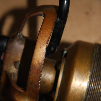

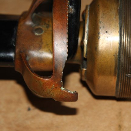

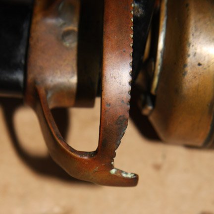

Hello, I am repairing my 1911 steering column for the upcoming driving season. The brass quadrant is extremely worn which allows the throttle and timing levers to move up and down at will. I thought about putting in a new reproduction quadrant, but discovered it is quite different from the original. So now I am thinking about building up the notched (worn) areas of the existing quadrant to their original height and then cutting new notches.
Has anyone done this? Is brass brazing rod an acceptable color match? Is there anything I should watch out for, like not melting the quadrant? I plan to protect the areas surrounding the notched parts with rags soaked in cold water. Are there other tricks, like somehow making a dam to keep the molten brass where it belongs before it cools?
One more thing: the brass case assembly with the gear teeth in it is slightly loose in the column. Can this be tightened up by carefully peening the long rivets that pass through the quadrant and hold everything together?
Any advice is greatly appreciated. Cheers, Bill

I will say, it’s tricky to braze brass without a meltdown.
- Posts: 4410
Re: Brazing the steering quadrant
Welding brass is quite tricky! Unlike steel, the transition from solid to liquid is fast, and with only slight color changes, difficult to see it coming. Also, because brass does conduct heat much more efficiently than does steel, a large area can be ready to simply flush away all at once without much if any warning. I have packed brass items in regular sand to support the item's shape with good results. Regular fine sand does get blown around by the torch'e wind, but still helps a lot. I also with a few tricky items set the piece into plaster of Paris keeping just the area to be welded exposed. That worked very well. Once the welding was completed and cooled, chip and break away the plaster.
I just use regular pre-fluxed brazing rod that I usually buy from the welding supply store. The color usually matches very well. Of course that could vary from item to item. I welded the brass headlamp rims for my '15 runabout with adequate success! Color was fine, final finish was fair. For those, I carefully shaped strap-iron inside and outside forms to hold the metal from collapsing.
It does take some practice to get used to controlling the puddle. Try it on some scrap or junk first.

I'd suggest crafting a patch piece out of brass, then silver-solder it in place. Silver melts a few hundred degrees below brass, so you won't risk a blowout trying to build up the brass like you mentioned, and the repair will be plenty strong. Polish it up, and the thin line of sliver it won't be too noticeable.

Bruce, I read down through responses before I posted mine and I would do as you have suggested. I'd remove all of the remnants of the notches back to their root, to establish the "baseline" and silver solder a piece of curved brass into place, and refile the teeth with a triangular or similar, file. Done properly, the repair will be all but invisible.
As far as the wobble in the column, the top of the column can be shrunk with heat and then if still slightly loose, shimstock between the quadrant casting and column will tighten it up. Do not expect the rivets to solidify two disparate sized parts.
