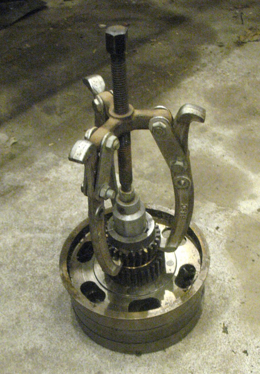

I've done this before, but maybe I've slipped a cog. Seems like this thing doesn't want to budge. Am I forgetting something?
Kerry
- Posts: 1461
- Last Name: van Ekeren
Re: Removing the #3317 driven gear: Am I doing it wrong?
Some can just be a pain, even using a puller twice the size of yours, lucky I have many spare ones because sometimes the only way to get the sucker off is with heat, even slicing with a hot stick.

Screw the puller extra tight, add a big hammer blow to the end of the screw. Repeat as needed.
I’d concur with Jack P suggestion.
When I was ‘young’ someone made the same suggestion to me. In for a nickle, in for a dime what did I know? They told me to go so tight it was just before the center wanted to cock...and then every time I walked by it rap it with a 3 pound maul. Same advice, do it as many times as necessary. I did it diligently and was fast becoming a non-believer.
While eating lunch the following weekend at a table just in the house with only the screen door between...there was a sound like someone threw a really big rock at the main garage door. I ran out, there was the 3 jaw laying lazy...mission accomplished!
They can be pretty stubborn at times. A Ford puller is best but. . .
Put pressure on it with your puller and heat the ROUND portion CAREFULLY and SLOWLY with a torch. Usually a very small amount of heat will allow the gear to pop loose, and from there its a steady pull to remove it.

My favourite tool is an hydraulic/grease filled puller.Their power is greater than a screw type, and it is applied in smaller, smoother increments. I have never found a gear which will not immediately succumb to its persuasion.

I have a ford driven gear puller. I put the puller on the gear and then clamp one of the arms tight in the vice. I had one gear so tight I had to hang on the end of my 3 foot long cheater pipe to get it to pop loose. They can be a bear to remove.

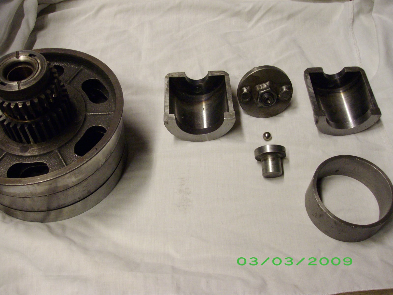

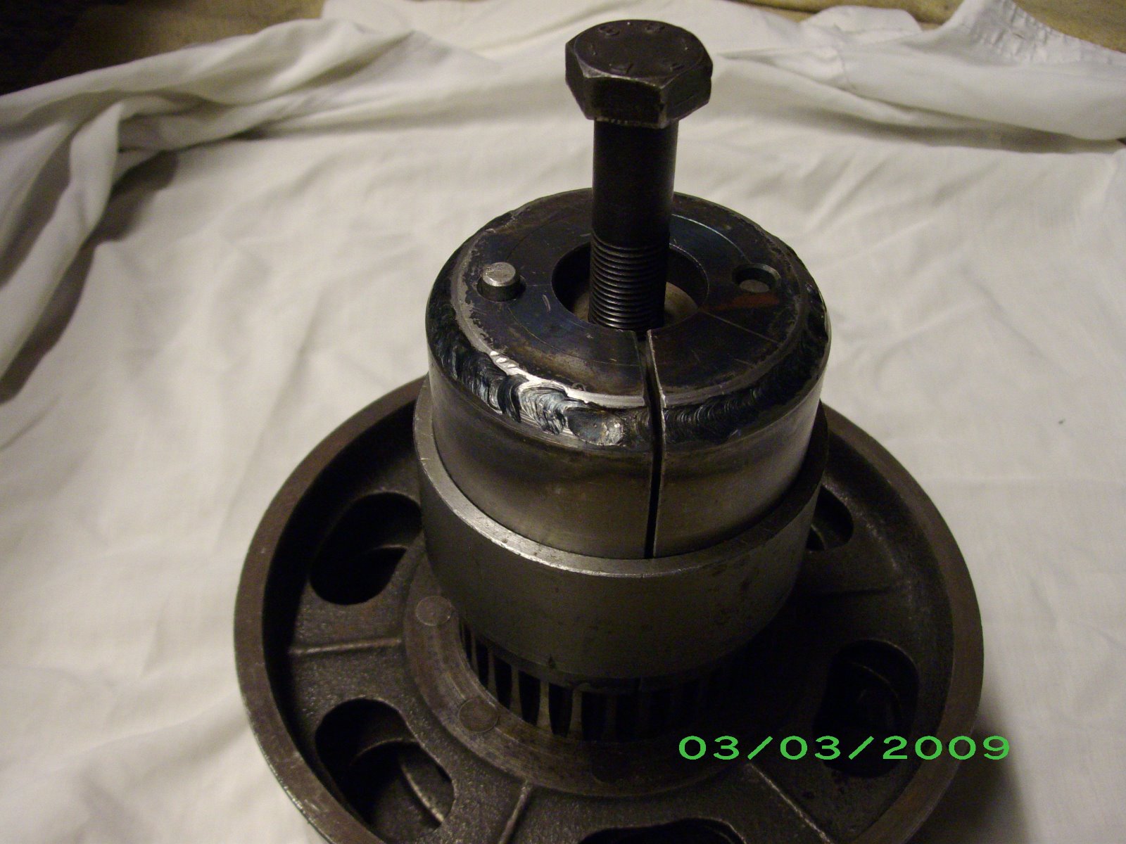

I use this homemade puller with great succes .
Toon
Toon

Like Dan McEachern says. The last past one I removed was in beautiful condition, so I wanted to use it and not damage the gear in any way. I put a LOT of pressure on it with a good (fairly large!) gear puller, and it wasn't budging a bit! And I hit the puller with one of the largest ball-peen hammers I have, and it didn't budge. So I got the torch out. Left the puller under considerable pressure, began heating the gear carefully with the torch, careful to not put any heat on the drum it was stuck to, then hit it lightly with a medium hammer. The thing popped loose. I shut off the torch, cranked wildly with a big wrench on the puller, and the gear slid of easily. It wasn't even hot enough to to not pick it up in my fingers (It has been measured! I can pick up something that is 160 degrees Fahrenheit.) Nowhere near hot enough to hurt the gear. It actually gets hotter than that in a running engine. It often doesn't take much of a temperature differential to make a big difference. And usually, once these type gears break loose from where they have been for a very long time, they go the rest of the way with ease. ("Usually")

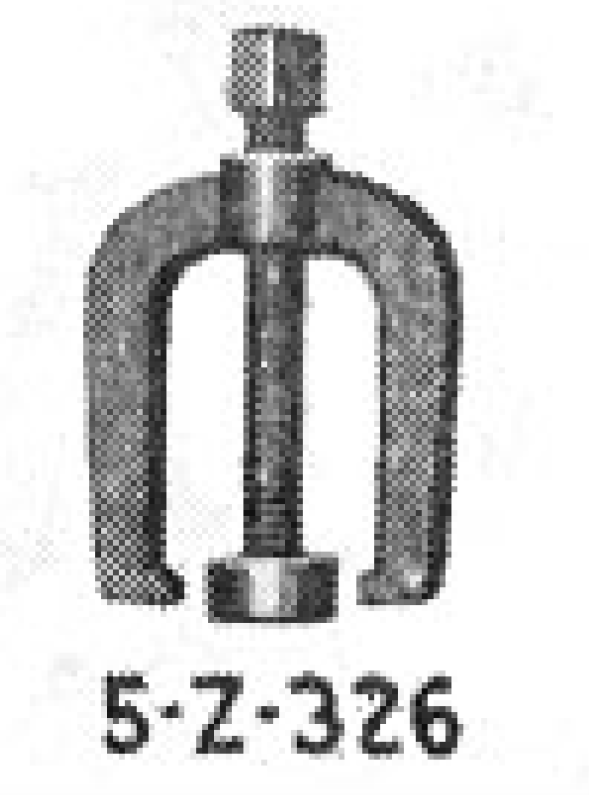

Topic author - Posts: 7394
The Ford puller is 4006, 1936X, 3Z-611, or 5Z-326 depending on when it was made.

Wow Anthonie, that is a nicely built puller. Steve I would definitely check the oil lines and all oil holes for debris. Good luck on everything.

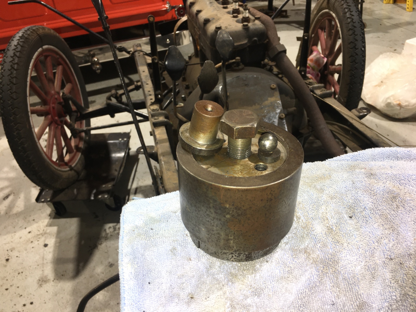

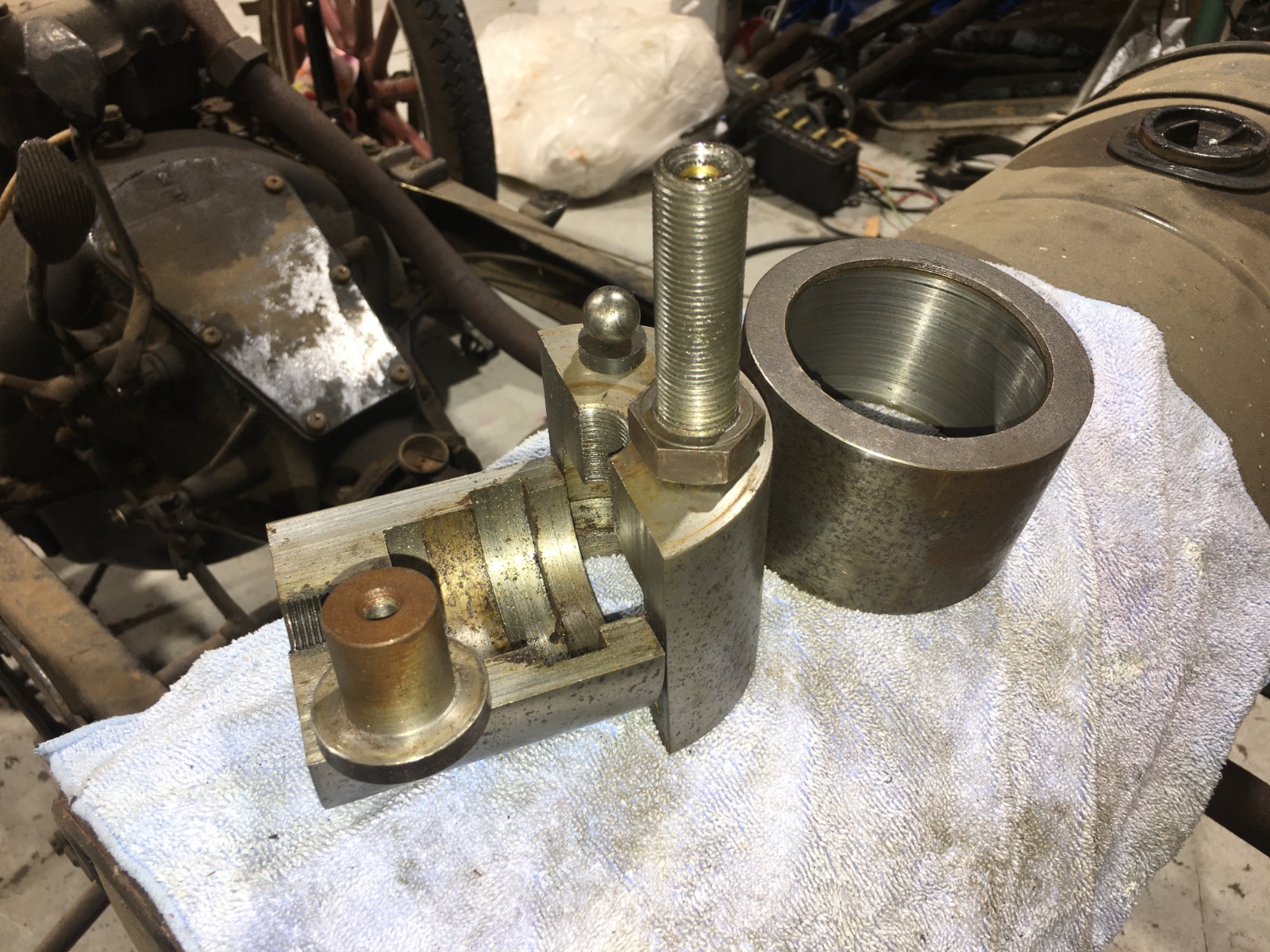

Hard to beat this type of puller !!
