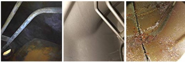

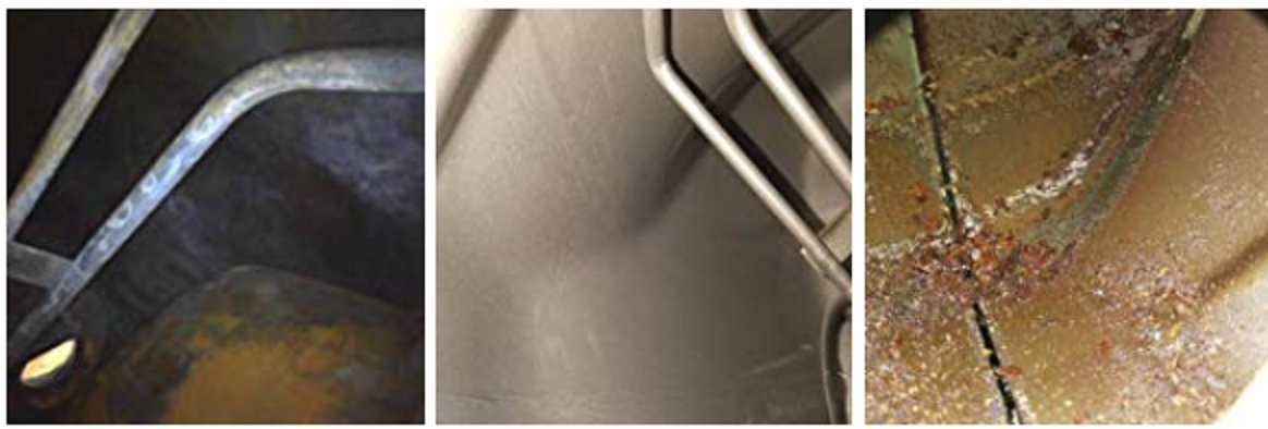

I understand what Dave is saying about removing the tank. But, to "solve" the problem long term, you will need to coat the inside of the tank. That requires the removal of the tank.
Rust needs three things to occur: ferrous metal (steel/iron), water, and oxygen. Even tanks that are kept out of the weather will acquire moisture in them. When the tank is less than completely full, temperature change will cause air to move into or out of the tank due to expansion/contraction. Moisture in that air will condense on the inside upper portions of the tank and fall to the bottom combining with oxygen will rust the tank. Thus a sealer is needed.
If you choose not to use a sealer, your best practices are: Keep the tank full whenever the vehicle is parked. This will minimize the air into/out of the tank and thus the amount of moisture getting into the tank. Drain the sediment bulb every time you fill up. Ethanol gas is a problem. The ethanol will absorb the moisture and lay in the bottom of the tank causing rust. Even the galvanized fuel tanks in vehicles today are rusting out due to ethanol/water accumulation. You can get ethanol free gas which reduces the moisture problems.
There are several tank sealants on the market. Some of the best are POR 15, Red Kote, and Caswell. Reviews have pretty well placed Caswell at the top of the list. There are very few negative comments about Caswell and I believe most of these can be traced to the user NOT following the procedure set by Caswell.

If you decide to do it yourself I can tell you I have had great success with gas tanks from cars and hit-and-miss engines by doing the following.
1. Wash the gas tank out thoroughly.
2. Fill the tanks with distilled white vinegar and let it sit. Over a period of days all the rust will be cut loose. You can save the vinegar, wash out the tank and examine how good it looks or if it need another treatment. If it needs another dose just strain the vinegar and pour it back in.
3. Once clean, wash the tank thoroughly then empty a box of baking soda in the tank and fill with water. The soda will neutralize the vinegar and stop the "cleaning" effect.
4. Once your tank is thoroughly dry we use a product called Kwik Poly, a two part epoxy made for this application. If your tank has baffles it is harder to do, but it will work. It is really important that you have the tank set up where you can spin it immediately after pouring the epoxy in, as it dries pretty quickly.
I have been using it over 20 years with great results and no failures.

Has anyone tried POR-15 fuel tank sealer and related products?
Here is a a buyers review with details on the steps he followed and pictures of the inside of the tank before and after
The same stuff I disliked about this product (this Tank Sealer sticks to EVERYTHING, and the preparation to use it takes patience and time) are the same things that make the results so spectacular! Yes, it takes a lot of time to do the prep (mostly clock time for things to soak), and yes the Tank Sealer is hard to remove from stuff (so wear gloves, cover the outside of the tank with painter's tape and plastic), but that means it seals your tank and you won't have to worry about it again.
The whole process consists of 3 or 4 steps. Step (1) is POR-15 Cleaner Degreaser (avail on Amazon) - removes any fuel varnish or other coatings from the inside of the tank. Step (2) is POR-15 Metal Prep (avail on Amazon) - removes rust, etches the metal for better adhesion of the Tank Sealer, and chemically adjust the pH of the surface, too. Each of these steps takes time, because you have to slosh the stuff around in the tank and then leave the tank in various positions to ensure that the "stuff" has time to work on the metal everywhere inside the tank. Then Step (3) is this stuff - the POR-15 Tank Sealer. This goes in and you spend a good while rotating the tank around slowly so this stuff will coat the entire surface of the inside of the tank. That took some finagling for me - because my tank has two drain pipes that run from up by the fuel filler neck to the bottom of the tank where they emerge near the fuel pump. So I built a special paint brush from a cheap 1" brush and a coat hanger so I could bend it into a shape to get to the pipes through the vacant fuel pump hole.
So what is the 4th step? Well, if you have a LOT of rust (see my first 2 pics, which is actually moderate rust), then Step (0) is to use Evapo-Rust to get it out. This takes time. I had my tank soaking with this stuff in it for 4 days, sloshing it around and leaving it in a different orientation every few hours to make sure every internal surface had its share of Evapo-Rust time.
So doing Step (0) took me four days. Yup, I let it really soak to get ALL the rust out. Then another day or so sloshing around doing Steps (1) and (2). Then you VERY CAREFULLY dry the tank (best to let it get toasty hot in the sunshine after you have dried it out initially). Then you do Step (3) - this POR-15 Tank Sealer. You do the same thing, you slosh it around in there until the entire inside surface is coated. Then you pour out the excess. I actually turned the tank upside down and used a spoon to get the extra paint out. Whatever method you use, don't leave any puddles of the Tank Sealer inside the tank. Then you leave it for 4 days! No Less! Make sure that stuff is completely cured before you put everything back together and put fuel in it. I spent about 11 or 12 calendar days (on and off, of course for soak time) from start to finish, and you can see the result in Picture #3! Couldn't be more pleased.
Some quick pointers:
1) Buy some Oatey or other pipe plugs to plug the tank holes. I used a conical rubber plug with a tightening screw in it for the fuel filler, and a cylindrical 2.5" pipe plug with a tightening screw for the fuel pump hole. Amazon has plenty of options, I am sure they have ones that will fit YOUR fuel tank.
2) Use painter's tape (not duct tape because it may pull paint off) and plastic sheeting to wrap your entire tank right up to the holes with the plugs. That way, any stray Tank Sealer won't get on the outside of the tank and mess up your paint job - which it will if you leave it for long.
3) Wear gloves, because this stuff sticks to your hands apparently just about as well as it sticks to the tank.
4) Do all the fluid changes and so forth OUTSIDE where you aren't going to make a mess inside your nice house or shop.
5) Don't rush it and make sure to follow the product's directions carefully - and you'll get great results

I have used it and have reported results to the forum. It is GREAT stuff. I'd suggest that you buy the kit, and if the tank is really bad, buy an extra quart of the cleaner and extra gallon of the etch, separately. This will cover a larger area inside while processing, than a quart and will speed the process.
Last time I used it, I used it on a large, round Torpedo tank. It had been terribly rusted and previous to 40 years in a museum, someone had soldered a large copper patch to the outside and bondo'd over. Old fuel still in the tank, rust and goop hid all of this. Using the cleaner, and rotating the drum into 5 positions on the diameter and one time on each end, for 2 hours each, along with tumbling to coat the baffles, it cleaned very nicely.
Same thing with etch, 2 hour soak in each position and then thorough flush. Took 10 complete tank fillings before it ran clear and no foam appeared. In dry Wyoming, I let the tank dry for 4 days. A hydrometer set over the filler opening showed elevated humidity for 2 days and stable for 2 days.
Filled with sloshing material then drained for 3 hours and let sit to cure just off kilter of the drain cock...I did not want a puddle exactly at the hole. I let it cure for a week before putting in fuel.
Results were excellent.
You may or may not be able to understand the level of corruption that continually percolated out from "outside" the tank and the "inside of the huge patch, but it was considerable and the cleaner and etch converted every bit of it and the slosh flowed into, through and out of all of the myriad of lacy spiderweb of holes in the bottom.
I support the above mentioned use of the Oatey expanding plug for the filler and a PVC pipe plug for the drain. These are mandatory.
