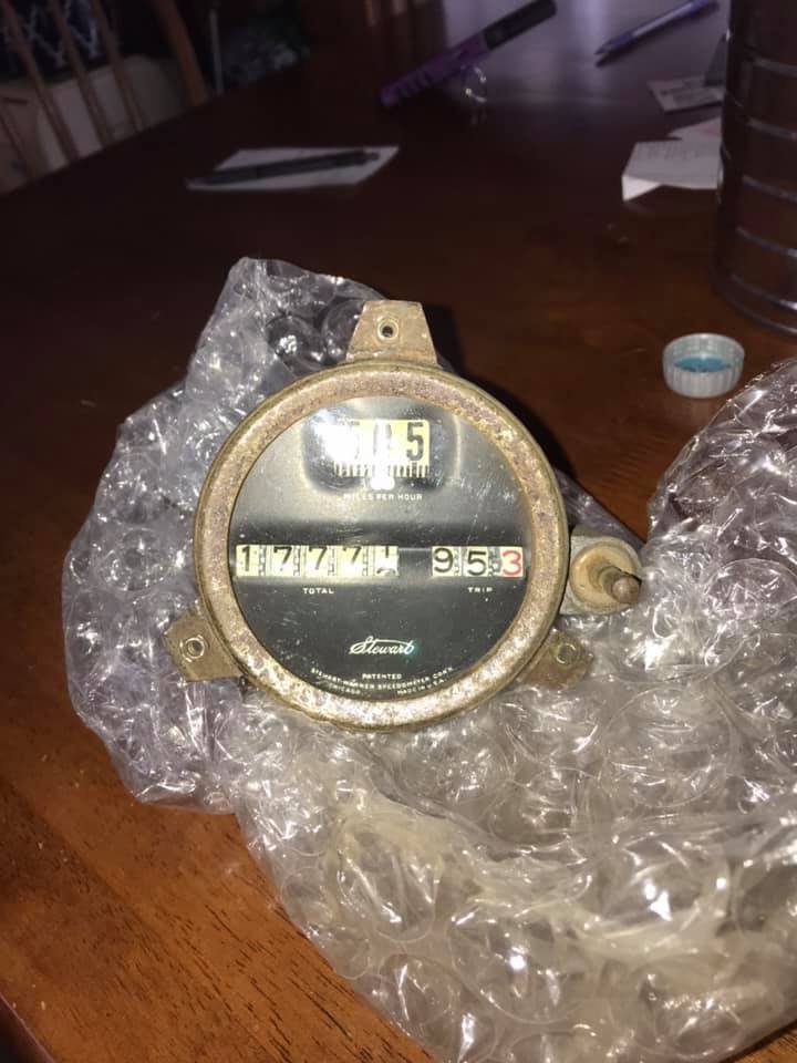

I received this in the mail today. It only cost me $20.

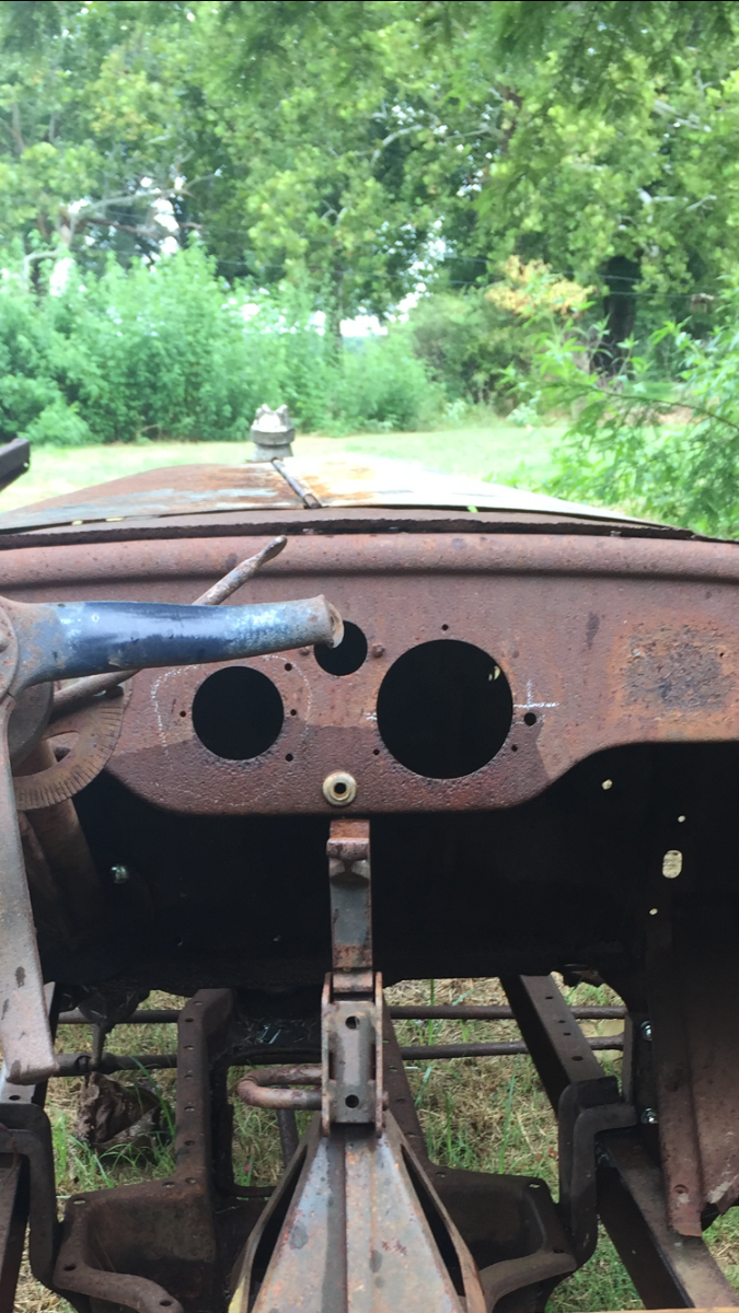

I think is a Model 160, but I am not sure. There are no holes in the case to mount it to my dash bracket.
My dash bracket has mounting points located at 10 am, 2 pm and 6 pm.
As you can see, the speedo has a removeable mounting bracket with attachment points at Noon, 4pm and 8 pm. This is the only way it will attach to the speedometer.
I opened it and cleaned the dirty glass (you couldn't even read it). The innards look serviceable, but what do I know. The Trip meter will not engage. The cable link does revolve. I can spin it by hand to 5 or 7 miles per, and a drill got it up to 35.

Will, two points on your speedo. That type of bracket is used to mount the speedo in a metal dash panel. The unit is mounted from behind, with the bezel protruding through the panel and the 3 mounting ears behind the panel. It does not require a separate mounting bracket.
It appears to have tumblers which have the numbers engraved/recessed into them, rather than painted on them. The painted on articles have potmetal tumblers which swell and jam. These units are mostly unserviceable. You have the good ones. I hope it works well for you.
Russ Furstnow is the go to person on speedos. I know he rebuilds the better type units with the engraved numbers, but if my memory serves me correctly, he told me at Chickasha that the painted number types are not worth bothering with, even if you can get them apart.

I’ve got that speedometer to go in a speedster with an Overland body, fits perfectly with existing holes. If you took that bracket off the back and turned it 180 degrees it should fit. You might have to drill more holes to attach the bracket back to the speedometer.
