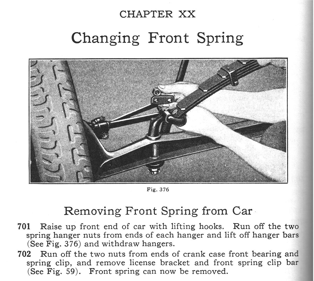

I wondered the same thing, and have been going to look through the Ford service manual to see which way they show them there.
- Posts: 2060
- First Name: Jeff
- Last Name: Humble
- Location: Charlevoix, Mi
- Board Member Since: 2006
Re: Which is correct?
Shackle forward, nuts behind. Thats what the service manual depicts.

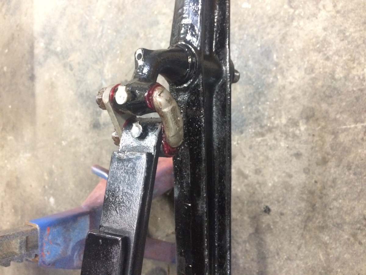

My earlier photos prove I have done it both ways.
I like the look of shackle forward. The way I did it this time.

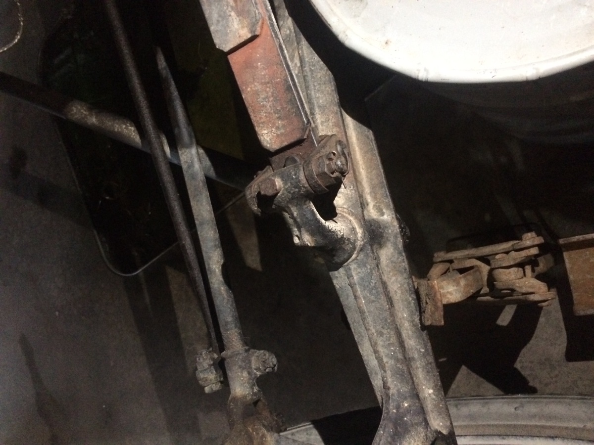

With our Canadian sourced cars, most came with forged L shackles, two pieces exactly the same. The question then becomes is the one nut at the front of the car at the spring eye or the perch?

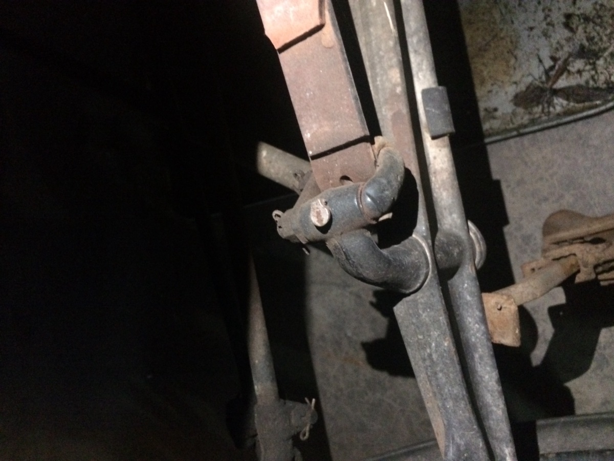

on early shackles with the twist oiler, there is in fact a correct and an incorrect way to install them. Not just aesthetics, but right and wrong.

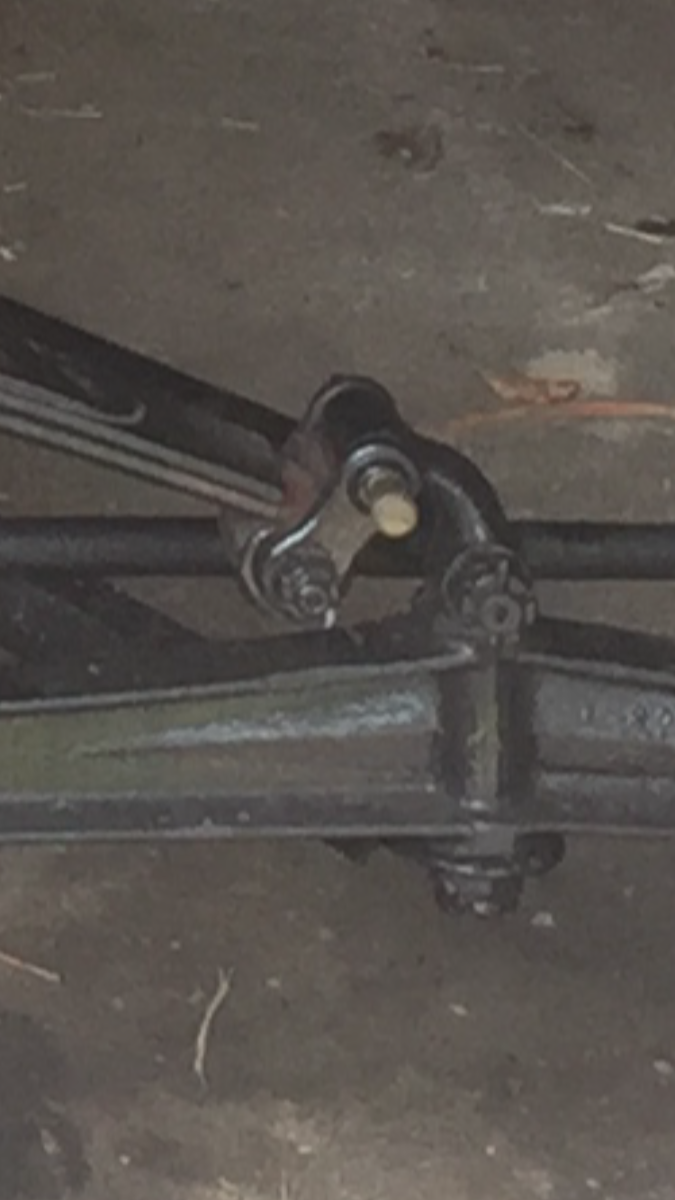

I turned mine around from how they are in this picture because I read on here the oiler facing the rear is supposed to be on top so you don’t have to climb under the car to put oil in.

From what I've seen on early brass twist oiler cars (my '14 included) is the oiler is on top at the rear and towards the bottom in the front so as Corey alluded to that makes oiling easier.

This is how the Model T Ford Service manual shows them. A photo of the rear axle shows the nuts toward the rear also. That makes the nuts more accessible to the mechanic that does the front version.
I would bet than more than one car came out of the factory the other way. Even more from out of the dealer after repairs.

The service manual illustrations show the nuts to the rear on both axles.
