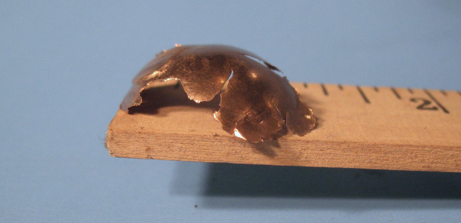

Post by Steve Jelf » Fri Feb 01, 2019 12:36 pm
This probably won't take long. :D
Posts: 5470
Re: Can you ID this part?
Post by RajoRacer » Fri Feb 01, 2019 12:51 pm
Remnants of the radius rod ball cap shim ?

It looks like the remains of a shim used on the front radius rod ball socket to take up slack resulting from excessive wear of the ball and socket. There was also a smaller version used in the drag link ball sockets.

I agree with Steve T. and Trent. That's what it looks like to me too. Where'd you find it?

I was right. It didn't take long. From a wishbone cap. This is the "before" version.

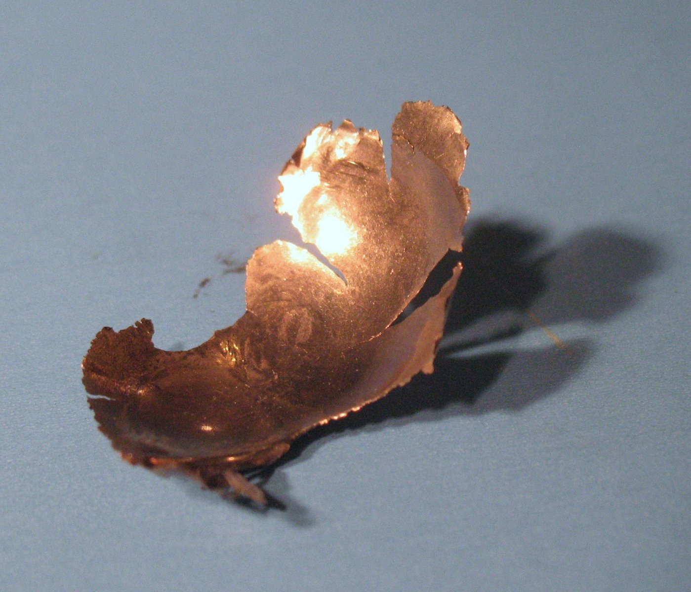

Funny, I just photographed this for my Anatomy series. This is what remains from an English penny, my coin of choice for the radius rod shim. It fell into several very thin pieces.
