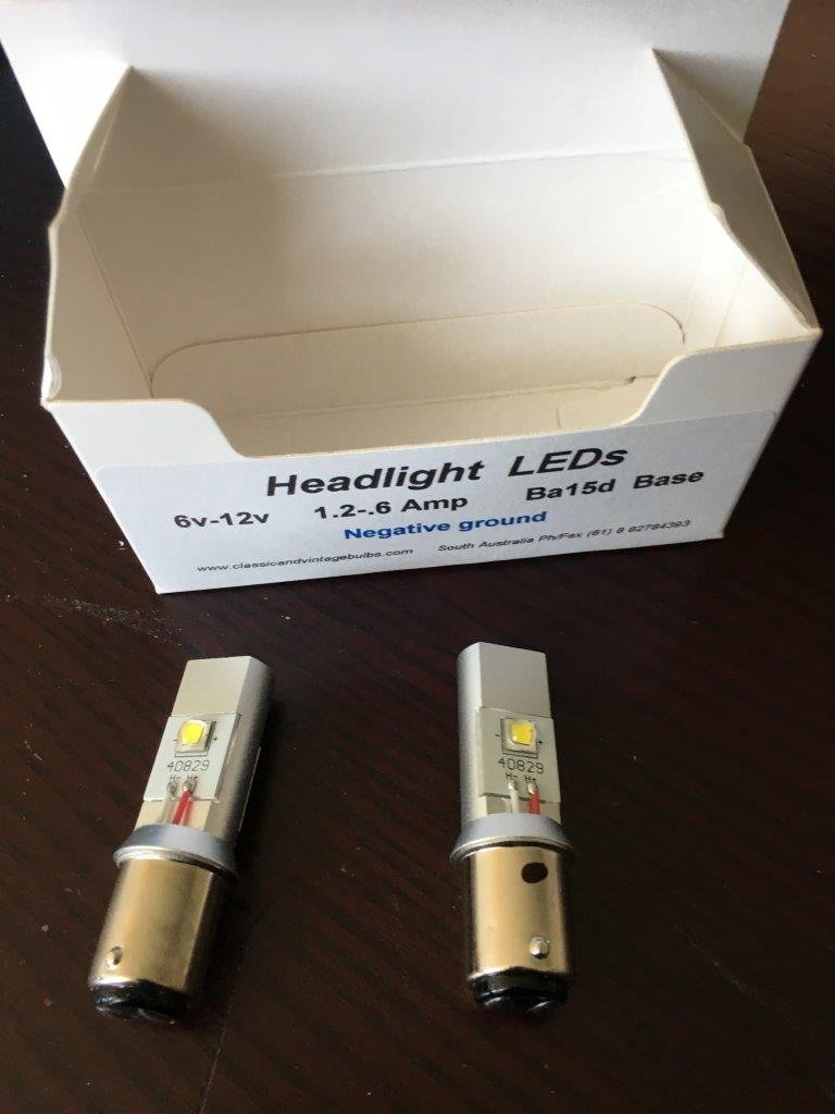

I noticed the topic of LED headlamp bulbs has come up a few times.
This is something that is available here in Australia. I purchased a pair last year but haven't fitted them yet. I'll post an update to this thread once I have. I expect beam adjustment (focus and tilt) will be more critical than it is with incandescent bulbs. One of the tests I plan to do is to leave them switched on and see how long it takes to drain a fully charged 6 Volt Optima redtop.
http://www.classicandvintagebulbs.com/page6.html
http://www.classicandvintagebulbs.com/page9.html
I have no affiliation with this company.

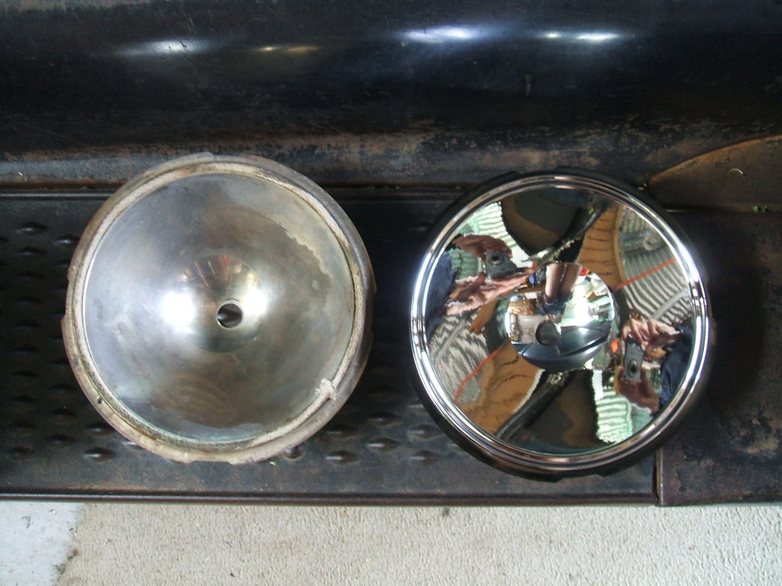

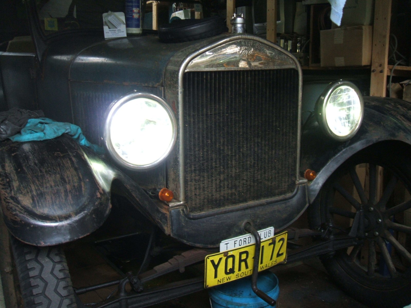

I have been testing some of the LED bulbs from Classic and Vintage Bulbs. First thing to note is that old reflectors are a waste of time with them (or incandescent bulbs). New reflectors make a world of difference.
The bulb positioning is important so that the beam points correctly with respect to low beam (it needs to point down) and high beam (it points straight ahead). Because of the symmetrical base, the bulb will fit in two positions, but only one is correct. In my instance I had to reverse one of the plugs at the back of the headlight so that high beam is activated when "Bright" is selected on the headlight switch.
The focusing adjustment seems to be somewhat more definite than with the incandescent bulbs.
The most noticeable difference is the whiter light. The difference between high and low beam seems more obvious than with the incandescent bulbs (but note that repro bulbs don't have the correct filament position anyway). Also, there's a huge drop in the current consumption of course; in theory a pair would run on high beam for about 40 hours with no charging. I did a quick test with a variable power supply which showed the bulbs have a proper switchmode driver for the LED's, not just a dropping resistor. If the input voltage drops too much (as I found when using the starter motor) the LED's simply stop working altogether.
I've become quite used to these bulbs and I do think they're an improvement for those that drive at night.

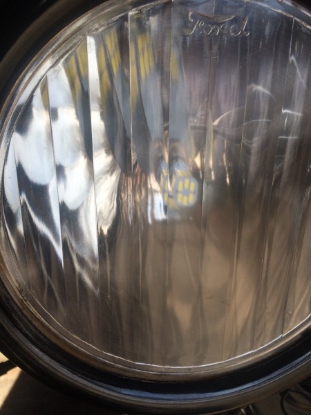

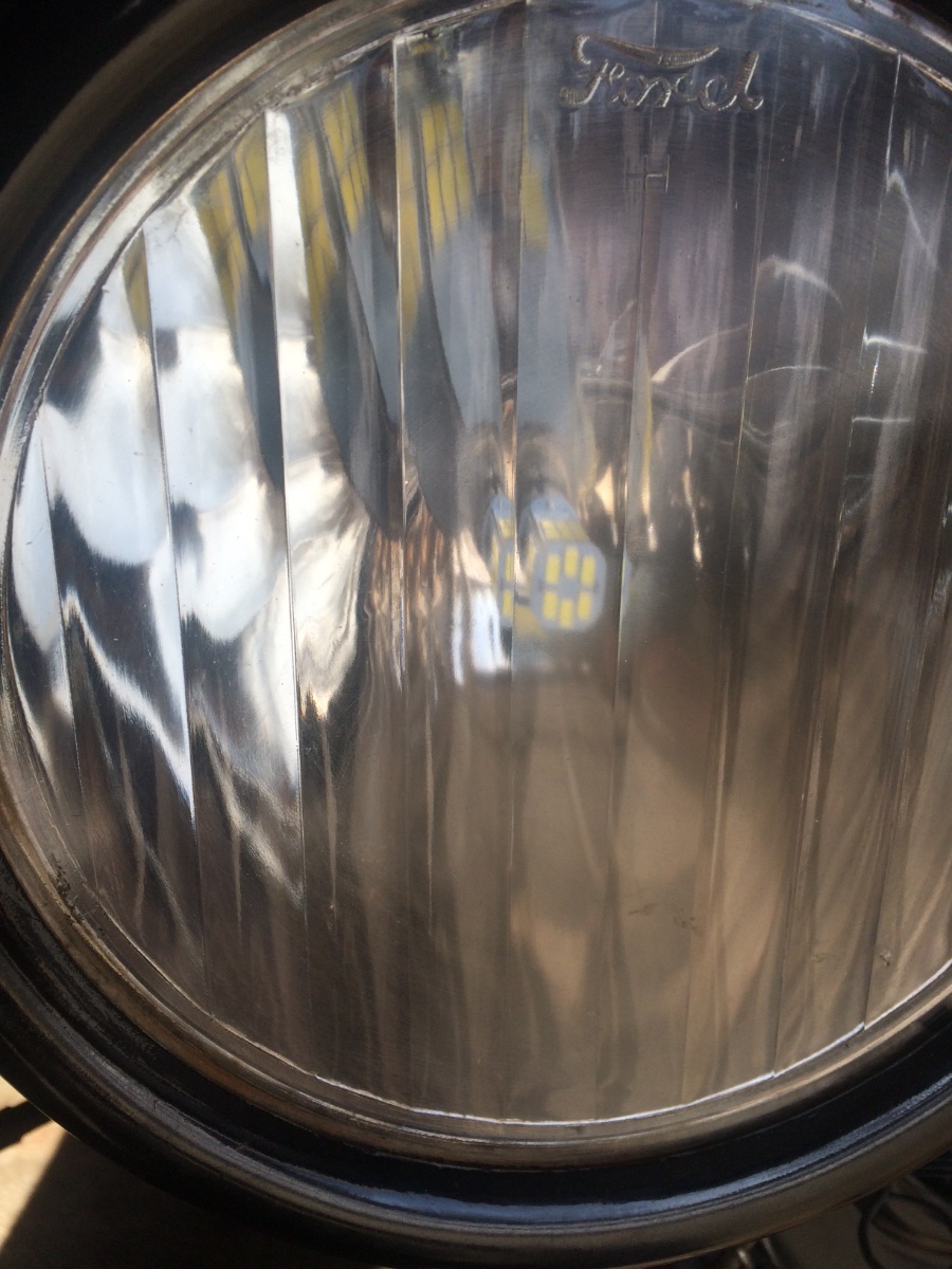

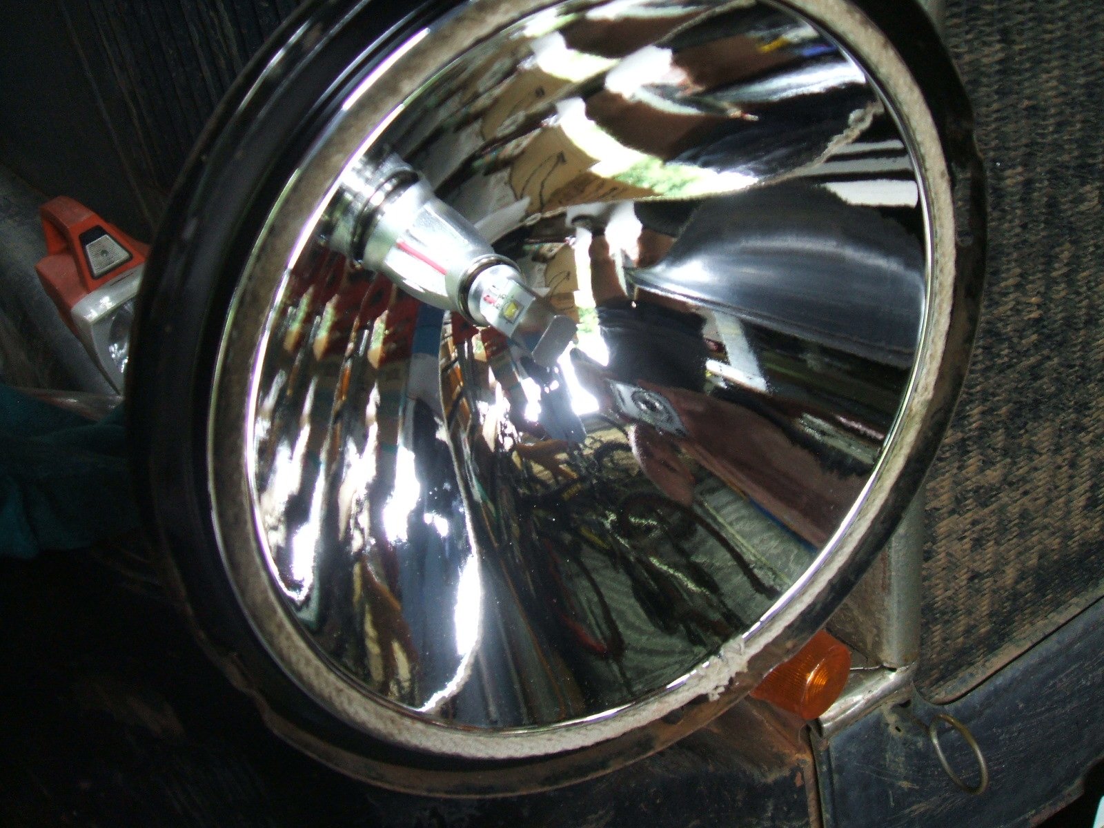

John, my reflectors, while not new, are pretty decent.
Here's a couple shots of just sunshine, you can see the bulb through the H glass, kinda.
I played around a little against the garage door today (inside), and the focus I had adjusted with the sockets all the way forward. I think that's about the best you can get.
I don't drive that much at night, but if you get caught up with something and wind up driving home after dark...it's nice to see and be seen :D

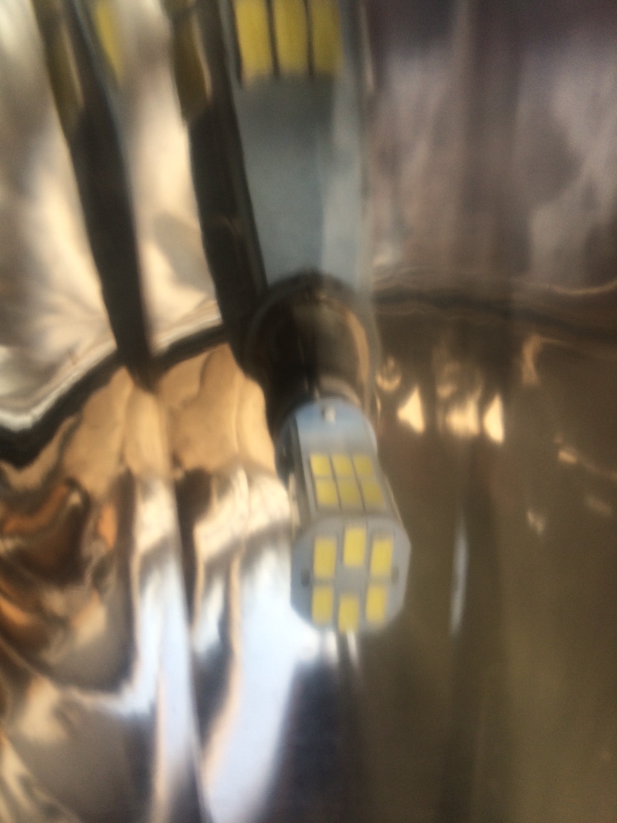

Ok i tested just one bulb with magneto headlights. They light up dimly at idle, and get brighter at speed. At full speed i fear the resistance starts dropping & they'll burn out so you may want to consider wiring a bulb in series as a resistor. I'm not an electrical guru so i don't know if you'd need a 6,9,12 or 24 volt bulb.
If you had the lights in series like magneto lights tend to be, I'd imagine you'd need a few more RPM to keep them lit.
If nothing else, try it & let us know.
These bulbs look befitting
Note the circuit diagram for them.

I finally tried out my 6 volt LED headlight bulbs. They light up the road really well.
This design points the light sideways and uses the reflectors to point the light forward which I think gives better control and avoids dazzling on-coming drivers.
