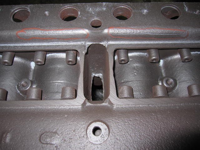

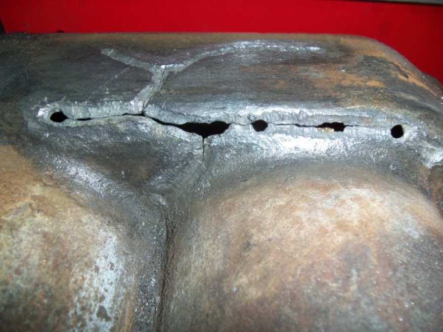

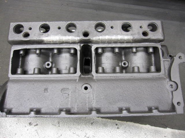

The crack can be reapired by metal stitching as seen in our pictures below even if it goes through th efreeze plug hole we can fix it permanently.blgitn wrote: ↑Wed Jan 22, 2020 7:08 pmI found some water in my lifter galley, and an old repair in the water jacket between 2 & 3. The repair is oil-colored and lifting around the edges. I can't tell if its JB Weld or Marine Tex. One of the freeze plugs is covered in white epoxy; pretty sure that's Marine tex.
it will be impossible to get the crack really (welding) clean, and I believe there will be too much rust damage in the crack area(s). I'm trying to decide whether to chip it off and use epoxy again or chip it off and go with good ol' Permatex #1. Reviewing old posts brings up the question of poly-glycols affecting the epoxies; I couldn't find a real conclusion to the discussion. What say Ye?
I've used both JB weld and ol' #1 successfully many times on the outside of the water jacket, but never inside the valve cover. I can see the chevron-shaped crack through the oval hole in the head-gasket surface: I intend to attack it with a long burr bit and then try to seal it from the top too. I'm happy to hear your opinions.
R/ Roger.

The “stitch” method is how I’ve always had it done. Never regretted it. Guys talk about it being so easy to buy another GOOD block for a $100.00. That sure hasn’t been my experience. Sure for a ‘16-25 maybe. Early and good ‘26-7 make in Canada are getting scarce. Just my experience

The previously brazed, then JB welded cracks around the freeze plugs above the valve cover got sanded down and re-JB-Welded. The center freeze plug still wept, but at least outside the engine.
There was one weeping brazed spot above the starter I sanded clean and JB-Welded.
Finally, I tried the sodium silicate. I even set it with 7 psi applied through a valve stem attached to the overflow tube. It seemed to work, but the weeping began again the next day. A second application with 10 psi and cardboard in front of the radiator also seemed to work, but wept the next day.
The good news is; no water in the oil anymore and just a drop or two on the ground. I'm calling it a win!

I know 1 fellow,that welded on a John Deere D cylinder head a couple times and never could get it to quit leaking.Got peod and happened to see 1 of the ads for Flex seal.Yep,that black gooey *$&# that loud mouth advertises on tv. Well,a brush,10 minutes,a week long cure of 2 thin applications inside the coolant chamber of the head,,and a reinstal of the head, in 2 years it aint leaked a drop and runs great.How long it last? who knows, The rest of the can of goo went around his plumbing vent pipe on his house. So cost was not much to fix the tractor.
Would I do this on a T? Doubt it,not a very large water passage in there for a thick layer of black goo to lay in.Would I try to solder the leaks shut? Maby,depending on where they were.I know someone posted soldering repairs on a crack years back on the old forum and I saved the pictures for reference.

Looks to be similar to a 26 block I have in the shed.Complete engine just has a similar crack with a small chunk missing. Repairable I am sure.

I’ve had 5or6 broken and or cracked blocks stitched by frank Casey of mill bury mass. All are running no leaks no problems
