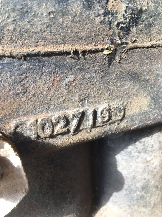

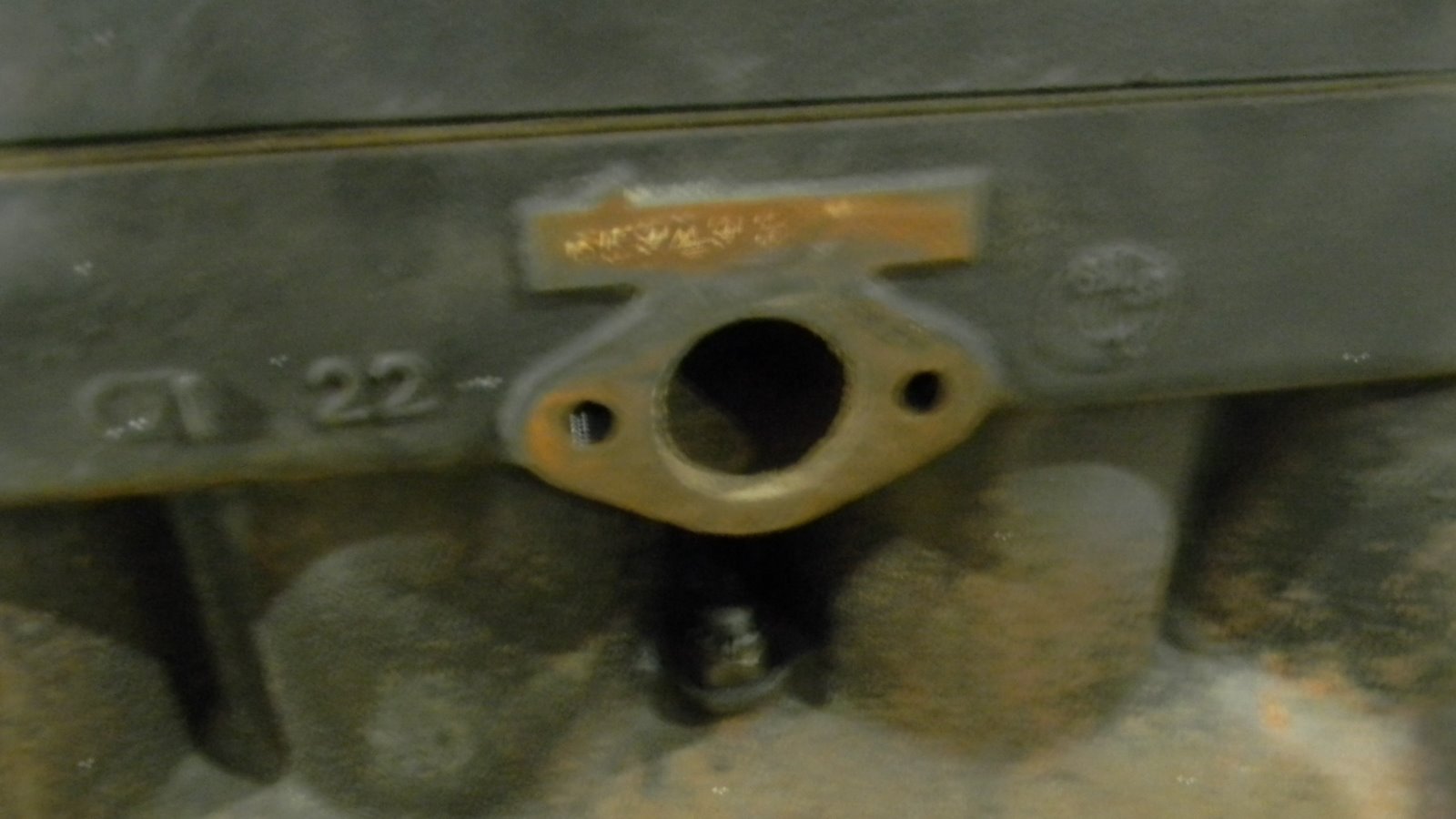

I got this engine from a customer, has been re stamped with a 1915 number also got title with this but the casting date is not what should be on the block, look at photos please, Bob
any idea of the year of this engine

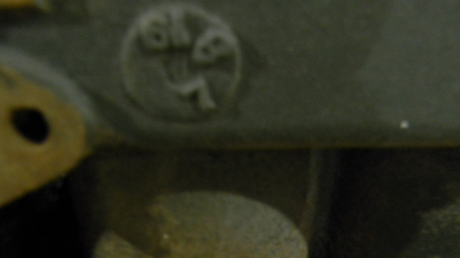

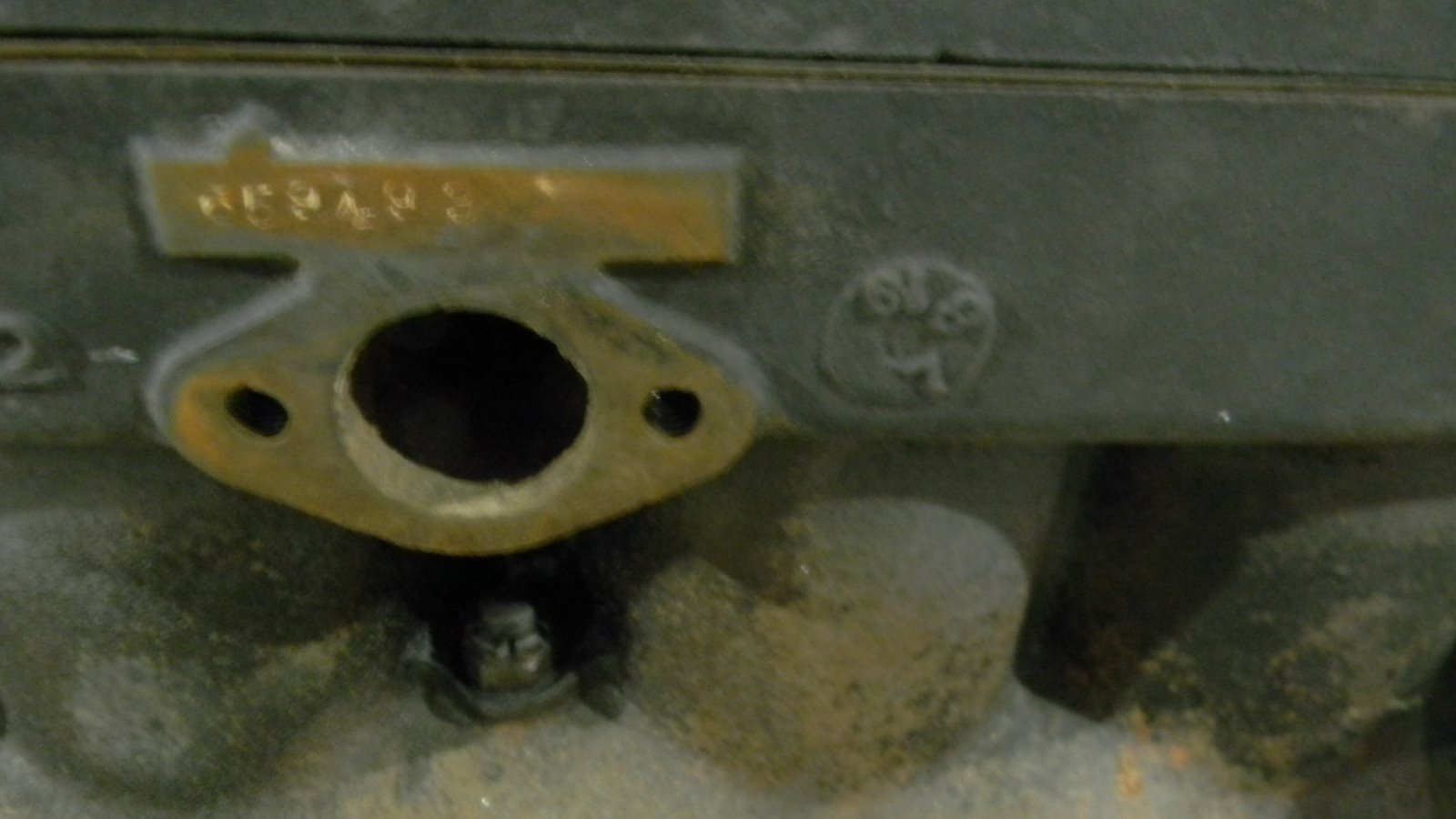

Bob, I will take a stab at it and defer to others far more experienced. I see a casting date of July 8, 1919 so it can't be a 1915 engine. But what about the fact it is a non-generator-starter block? In the CD encyclopedia the Ford Engineering drawing dates indicate that the cylinder block T 400C was obsoleted on July 24, 1919 and replaced by T400D, the starter type of cylinder block. The info in the encyclopedia also indicates that the actual change to the parts could occur before or after the dates of the engineering drawing dates. So my thought is that you have a 1919 engine that was cast during that change over period between non-starter and starter cylinder blocks.

You're correct, its a 1919 early without generator casting on block.
Bob's is dated July 8. Was re-stamped for '1915' numbers, maybe to sneak into HCCA early tours.

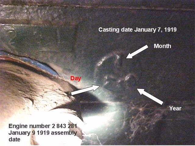

Diagram for reading dates on the clock face casting patterns of later blocks, saved off this forum.

Looks like it was a 1915 engine, but with a replacement block from 1919. US production used that "circle" casting code date for about three years, roughly 1919 through '22. After which US blocks stopped using date codes entirely. Canadian production blocks used circle date codes for many more years. Very unusual to find circle date codes on a "no generator" block! Most no generator blocks were early enough to still use the in-line date codes. It was not rare for replacement blocks to have no serial number from the factory, and then be stamped the the original block's serial number. Usually such blocks were used to replace original blacks that had been damaged beyond repair. Although that is not a given. It is possible for two engines to have matching serial numbers. I seem to recall hearing of it being found once.

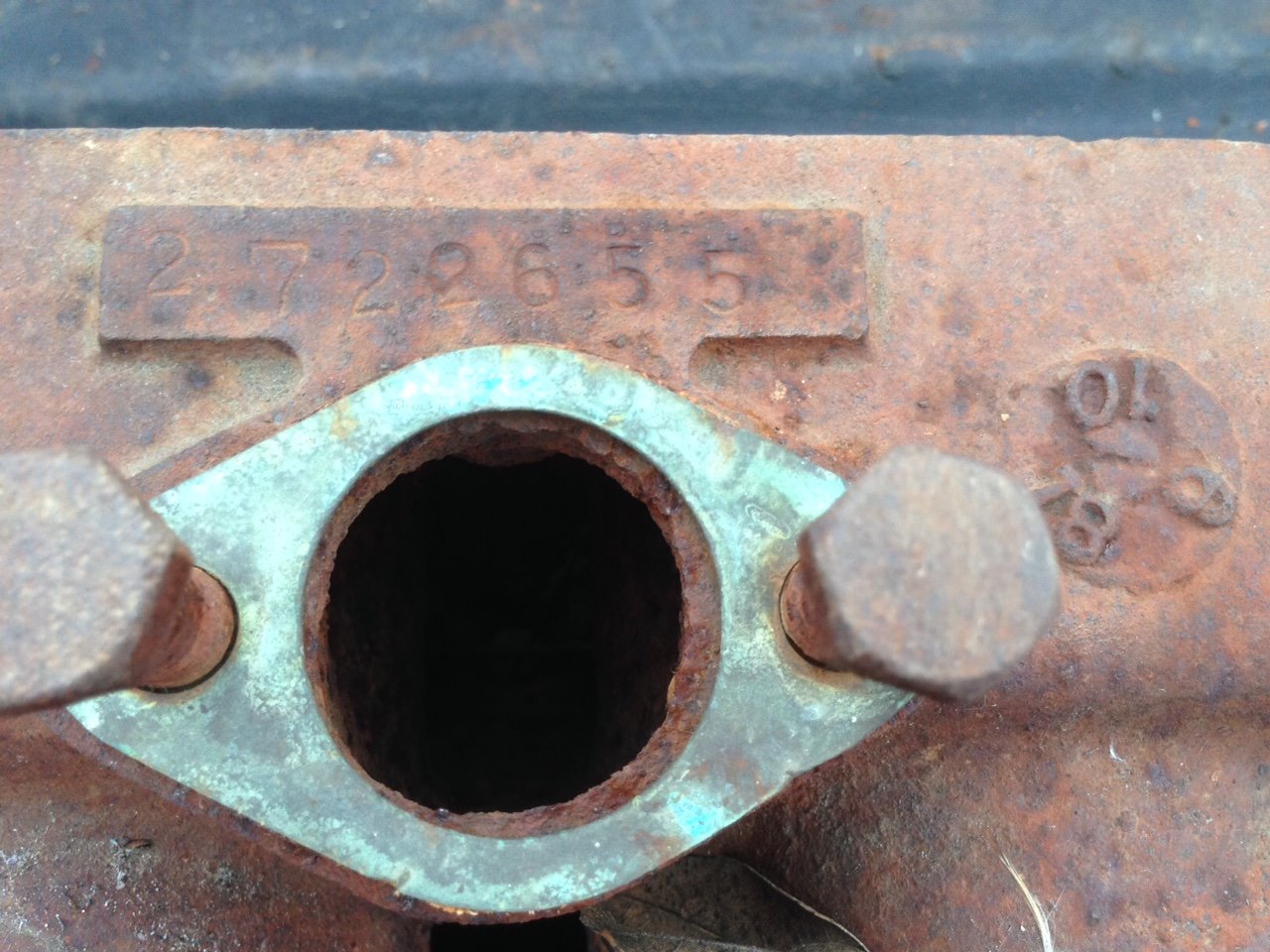

Although the circular casting date is generally considered introduced in 1919, they actually started showing up early as mid 1918. I have two 1918 blocks with a circular casting date, the earlier one (June) shown below, and have seen one other.
On the flip side of this thread, the inline style casting date survived on some blocks as late as October 1919.
The switch over from the inline to circular casting date apparently took a long time!

A question. Are both your '18 blocks with the circle date a pre-generator block? Or would one of them be one of the first generator blocks? I would wonder if the circle date somewhat corresponded with the change to generators. Also, could your late "in-line" date block be a late "no generator" block? The latest no generator block I have seen so far was in an early TT with an early '20 build (but I didn't get to see the casting date).

Wayne – both my 1918 circular casting date blocks, plus the other one I saw, were all pre-generator blocks. For 1919 blocks there are four different styles, if I may call them that. They are inline casting dates with and w/o generator provision and circular casting dates with and w/o generator provision. The latest 1919 pre-generator block I own is a circular casting date of 3-28-19 and built April 1, 1919. I’d love to find a 1918 generator block!
