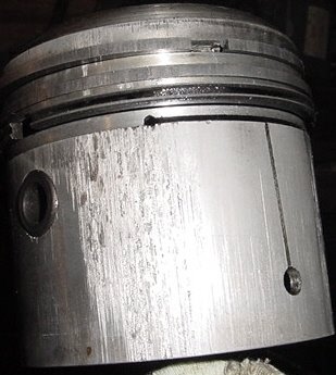

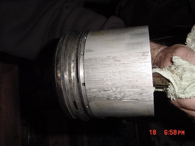

I bought a rebuilt engine,never ran,put it in my T, ran it 20 minutes total,and this was what number 3 and 4 looked like.
Scars the cylinders if ran to long. I buffed off the pistons, honed the cylinders and she is running fine now

There are several things that can be done to help prevent the pistons from seizing.
The aluminum pistons that are available today are not optimally designed and manufactured.
The areas where the skirts attach to the top part of the piston is comparatively large and lets a lot of heat to transfer to the skirts, which results in additional expansion of the skirt diameter.
This requires the cylinders to be bored with a .006 in piston skirt clearance just below the oil ring groove to accommodate the additional expansion. The piston skirt needs to be measured at the top edge just below the oil ring groove and at the bottom edge. Sometimes the pistons are tapered larger at the bottom. If so the clearance at the bottom edge can be somewhat tighter.
A modification I recommend is to smooth the sharp edges on the piston skirts at the top edge just under the oil ring groove and also at the bottom edge of the piston. The bottom edge of the cylinders is another place where a sharp edge may exist. That edge also should be smoothed. Doing that will allow oil to stay on the cylinder bore instead of being scraped off.
Adding dippers, x-grooving the rod bearings, and adding squirt holes like the Model A connecting rods have will help cool the piston and reduce expansion.
The piston pin can be easily distorted from tightening the connecting rod to the pin. Lightly honing the small end of the rod may help insure the hole is round. The clamping force at the pin does not need to be overly tight. The piston pin hole should be honed slightly larger to accommodate the uneven stresses applied by the rod to the piston pin.

My story: On the Not For Sissies Tour I let a friend drive my 26 RPU for a day. The truck had a freshly rebuilt transmission but I thought I had broken it in. At the end I’d the days ride my friend was waiting at my trailer with some bad news. He said “listen”, cranked it and there was a loud squeal. All Model T guys who walked by blamed a seizes triple gear bushing. Me too.
When I got home and cranked it up and started troubleshooting and for some reason I thought about tightening the bolts on manifolds and guess what....yep...the noise went away and has not come back.
