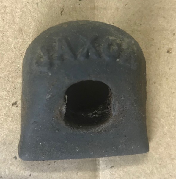

Yes. I know for sure Jackson made some. My uncles 26 touring has a set on it.

Jackson or Jaxon?

I think both were used. Jackson was the company name and the lugs had Jaxon on them.

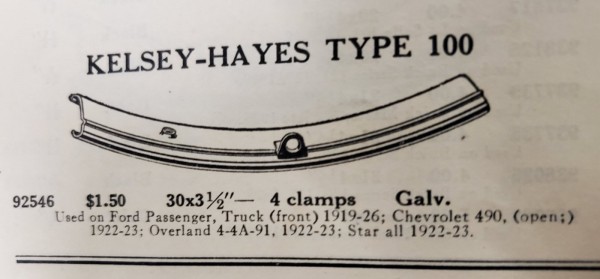

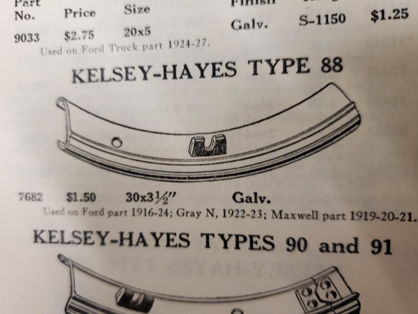

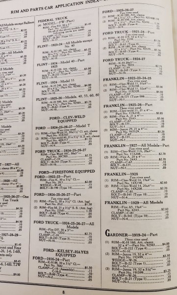

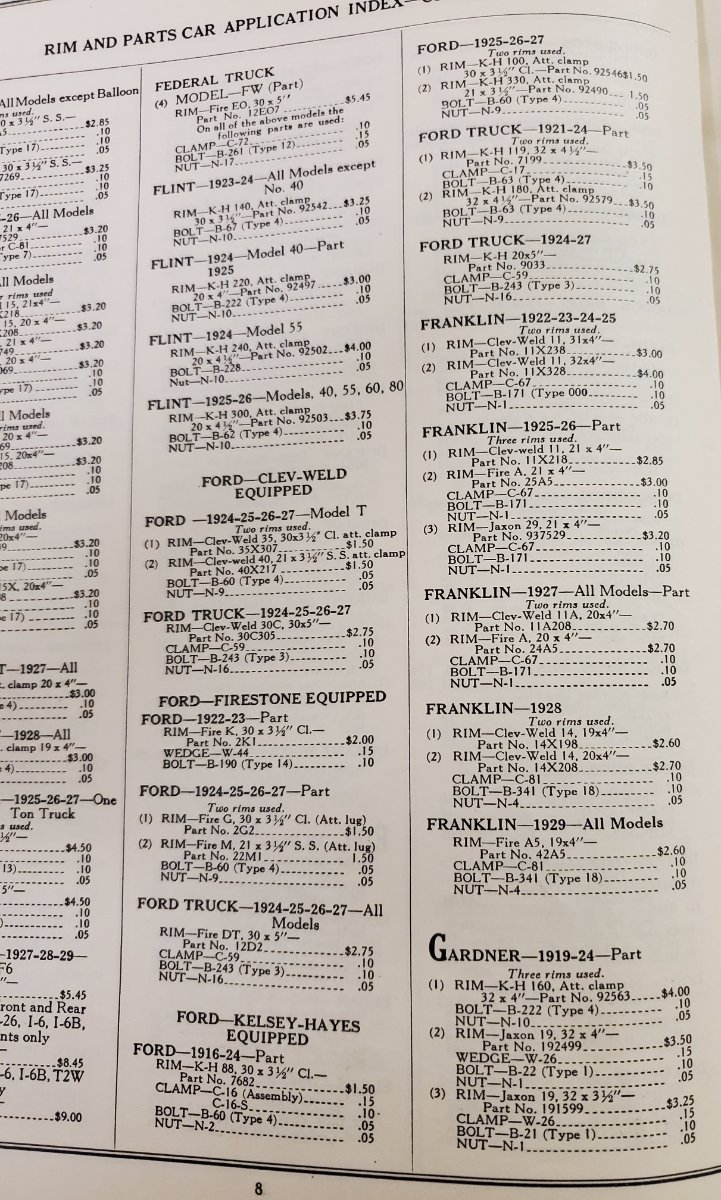

The other way to come at this question is from the part supplier end. Attached copies are from the 1929 "Official Catalog of Genuine Wheels, Rims and Parts" published by the National Wheel and Rim Association. Rim photos in the following posting.

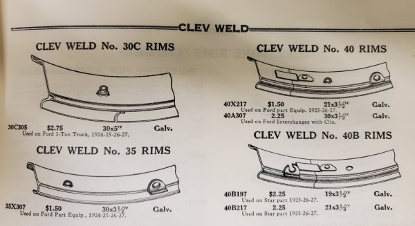

And here are the Cleve Weld, Firestone and Kelsey-Hayes rims:

Tim thank you for the information. What does it show for 21" Chevrolet wheels? Say 1919 to 1928. Part of this is trying to figure out what rims are needed for the wheels that are on Milford's coupe. I am fairly sure from what photos I have see, that they are Chevrolet wheels.
Speedsterguy2
Posts: 41
Joined: Tue Jan 08, 2019 1:58 am
Last Name: Knapp
* REQUIRED* Type and Year of Model Ts owned: 1919 Speedster (project)
Location: Wilsonville, Oregon
Re: Did any of the Ford 21 inch wood wheels come with loose lugs looks like maybe early Chevrolet, But?
Post by Speedsterguy2 » Thu Jan 30, 2020 6:42 pm
OK. The same catalog shows 33 different rims for 20 different Chevrolet models between 1919 and 1929. All were made by Jaxon or Kelsey-Hayes. However, there is only one loose lug rim in 21 x 4.5. That is a Jaxon Type 30 rim. (click on photo and it will turn right way up)

Big thanks again Tim. maybe by 26/27 Chevrolet was using the same #30 rims on both the wood wheel and disk wheel.

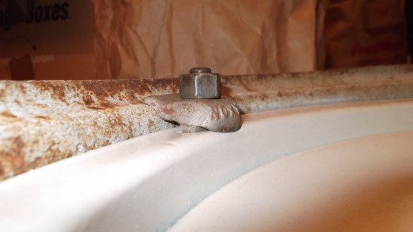

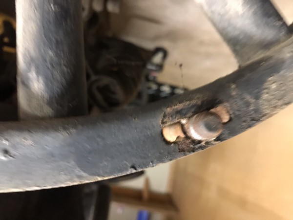

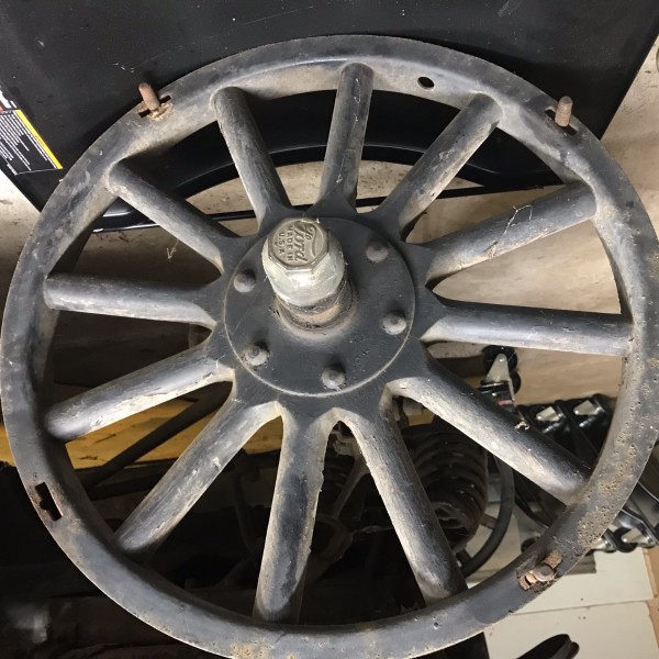

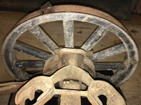

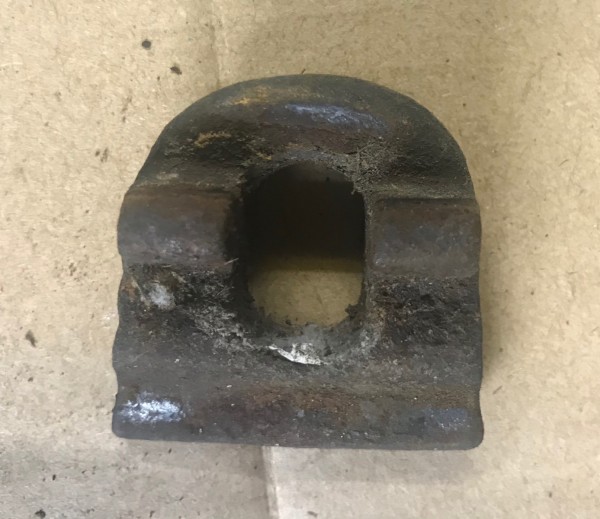

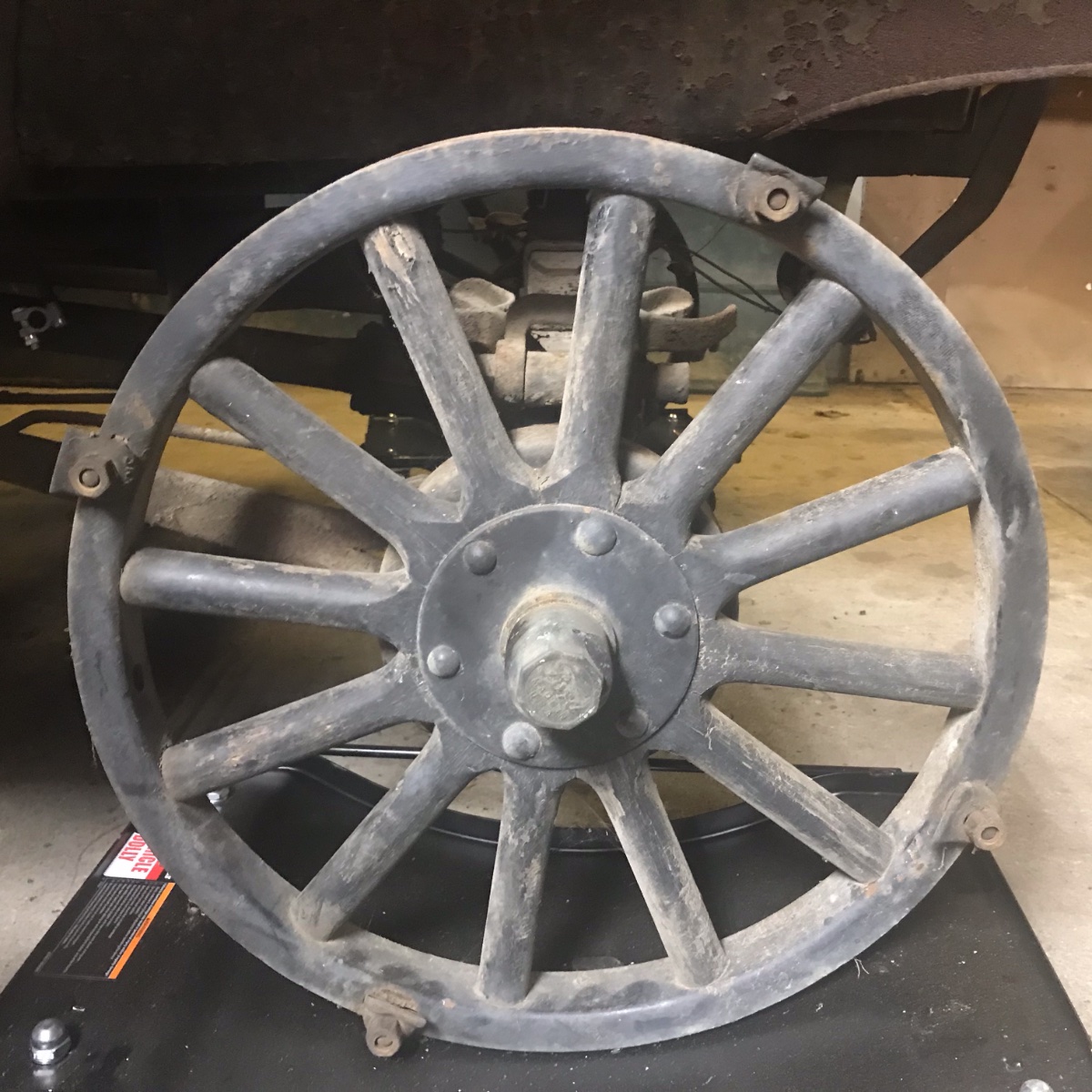

Here are a couple of other photos of the wheel. Unfortunately, I cut off one edge of the wheel, but I don't think it has a notch cut out of it like the ones in the EBay ad.
MHSprecher
Posts: 88
Joined: Sat Feb 09, 2019 6:37 pm
First Name: Milford
Last Name: Sprecher
* REQUIRED* Type and Year of Model Ts owned: 1924 Coupe, 1910 Touring
Location: Takoma Park, MD
Post by MHSprecher » Fri Jan 31, 2020 5:59 pm

Ok looking good so far. Do the fellows have a notch about 180ish from the latch holding the ends together?
Here is a photo of the narrower 26/27 rim on a 28 wheel with the wider fellow.
MHSprecher
Posts: 88
First Name: Milford
Last Name: Sprecher

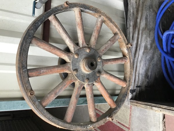

Post by MHSprecher » Sat Feb 01, 2020 1:04 pm
Here are some other pics of the whole wheel. No notch that I can see.

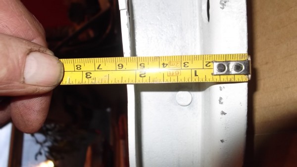

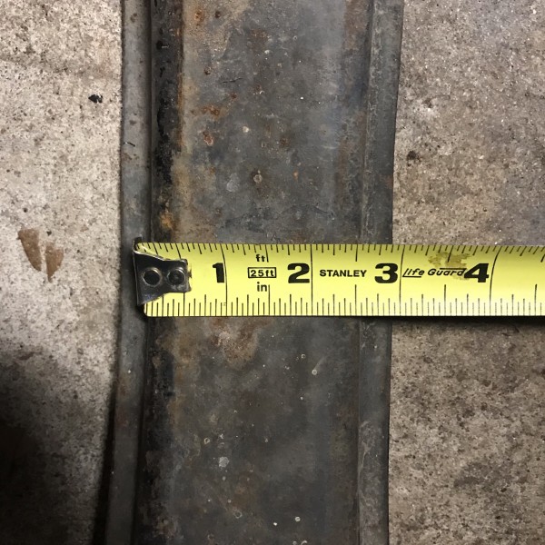

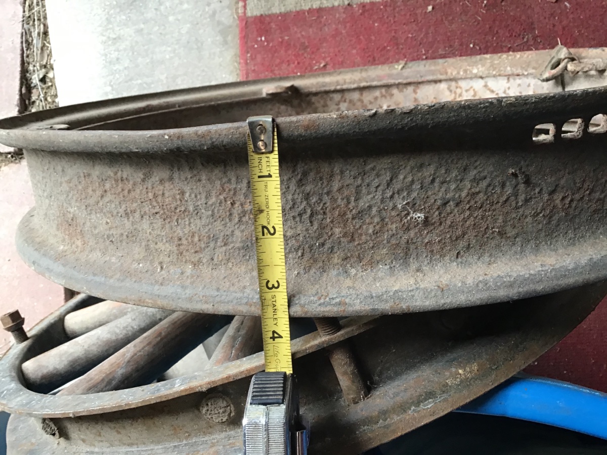

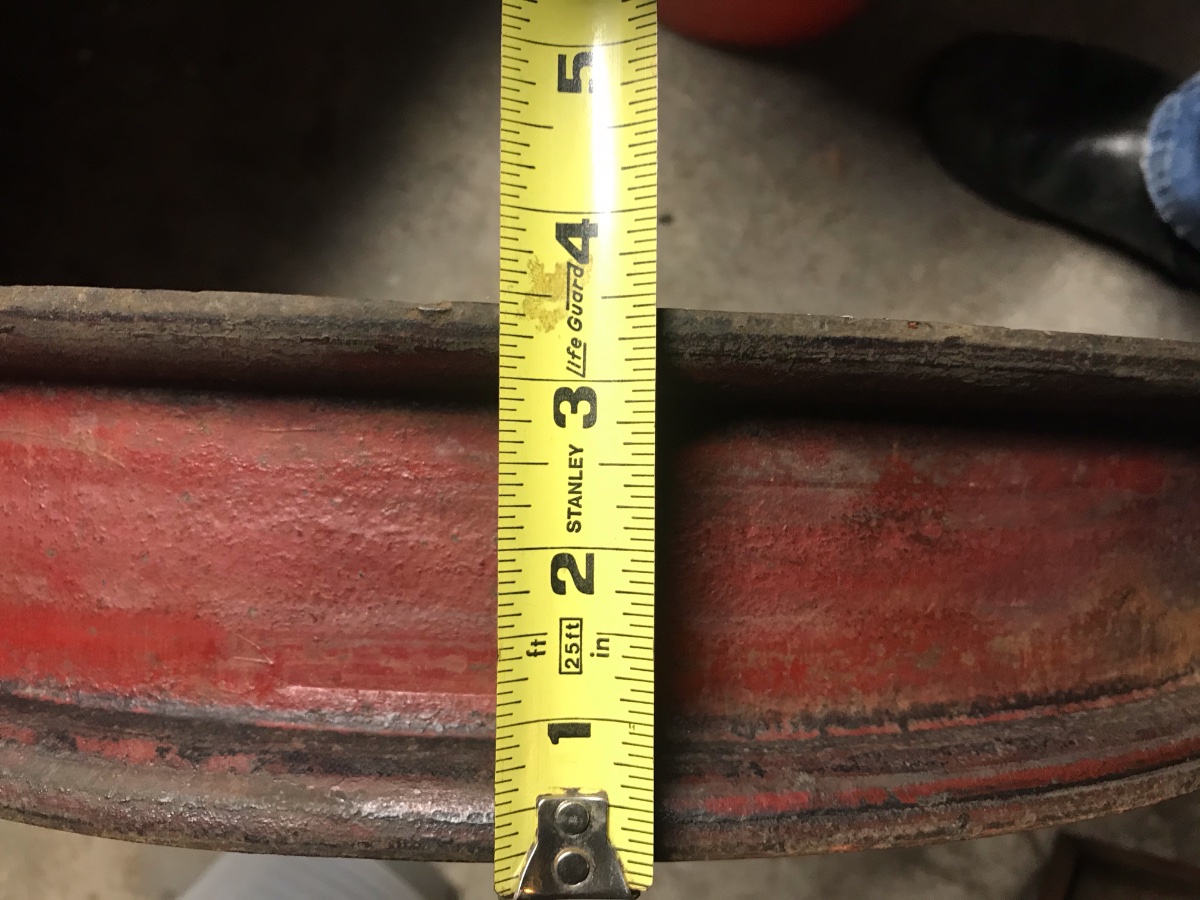

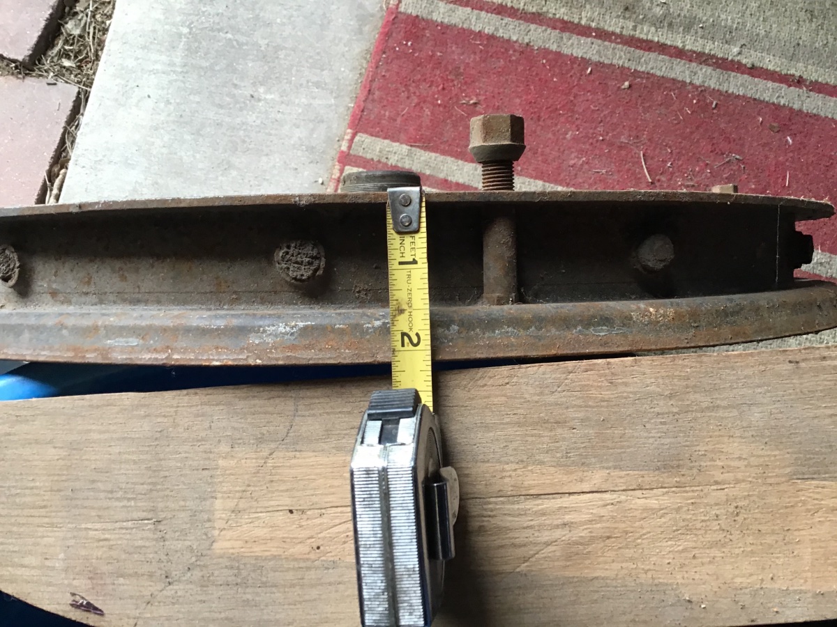

Milford, my first suggestion at this point is to find a set of proper wheels and rims for you car, the 30X3-1/2's.
Looking back over the photos I am seeing a mixed bag of parts, maybe.
In your ad for the rims, the photo shows one with the dimple which should be the 26/27 style that would need a notch in the fellow like I showed above. In your above photos, the first rim you show with the tape is 2-3/4 to 3" across the back, but from the other side is about 3-1/2" and the wheel shows no notch. Were they the same rim? The 1928 did not have the notch or dimple.
If you wish to continue with the wheels on the car:
Measure across the top of all 4 fellows and rims. Dose not matter where they are on the car just the measurements. Are all the rims/fellows about the same width?
Side by side; narrower 26/27 and wider 28 rims;
While I am no expert, I am learning more as I go along. Nice thing about Ford in the era they were mostly standardized, well except for rims and wheels but that is another story at this point.
Post by John kuehn » Sat Feb 01, 2020 5:52 pm

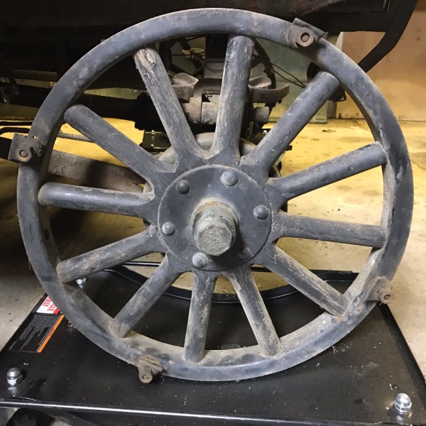

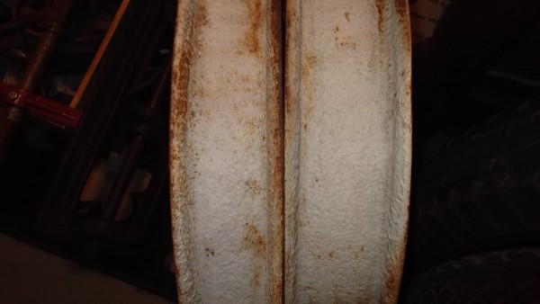

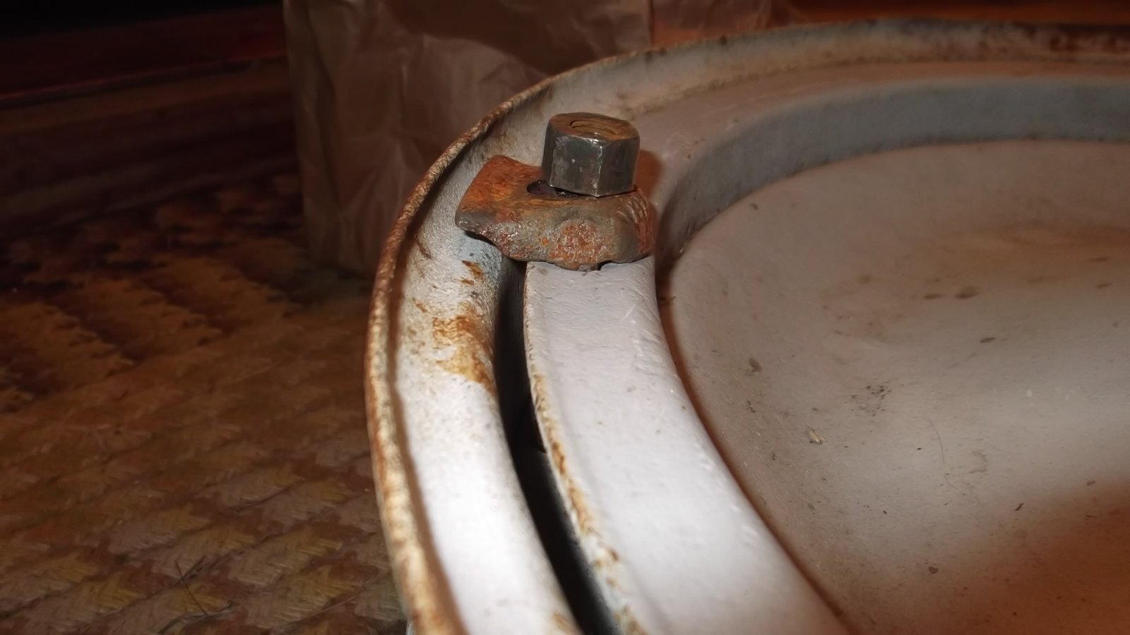

Just for comparison purposes here of some pics of a 21” Ford wheel and split rim. Looking at the Ford and Chev differences the most noticeable is the notch in the chev felloe for the lugs. The bolt hole is probably the same size in both fellows.
Other than that the wheels look pretty close.

Post by MHSprecher » Sat Feb 01, 2020 8:49 pm
I have already bought tires for these because, as far as I knew at the time, these were the right wheels. I think the easiest thing at this point would be to find a couple of the Jaxon rims, if I can find them. All new wheels and rims would be quite an investment. Apparently the car worked fine with these for a number of years. I do not know because the car had been stored in a basement since the early 1960's and the owner died long ago. In a way, I am intrigued by this situation because it was one of those "make do" situations that come up. As you could get Model Ts with 21" wheels starting in 1924, they are not incorrect.
One thing that puzzles me is the rear hubs. As you may be able to see from one of the photos, everything looks pretty good to my eye. I would think that maybe the Jaxon wheels wouldn't fit there? I have a Model T buddy coming over tomorrow and maybe he has some ideas. I will also try one of my 21" Model T rims and see how they fit.
I didn't pay much for this car, but I don't want to get too upside down on it if I can avoid that.
I do great appreciate all the suggestions and comments. It is great to have a community like this to get input and opinions from.

Post by John kuehn » Sat Feb 01, 2020 9:21 pm
Milford you might try the antique Chev website and see if someone has the correct rims for your wheels. Don’t exactly know the name of the site but they do have one I think.
Another way you can go with wheels is to buy the wheel adapters for 28-29 Model A wheels to T hubs. Decent used Model A wheels aren’t real expensive like the 26-27 T wire wheels are. Since you have 21” tires they would fit the 21” Model A wheels. Lang’s sells the adapters and occasionally they show up on the classifieds.
The thing about old or classic cars is that you have to pay to play and if your like me sometimes you have to pay a little more than you want to! I have a 63 Ford Galaxie hardtop that I learned that lesson the hard way!
