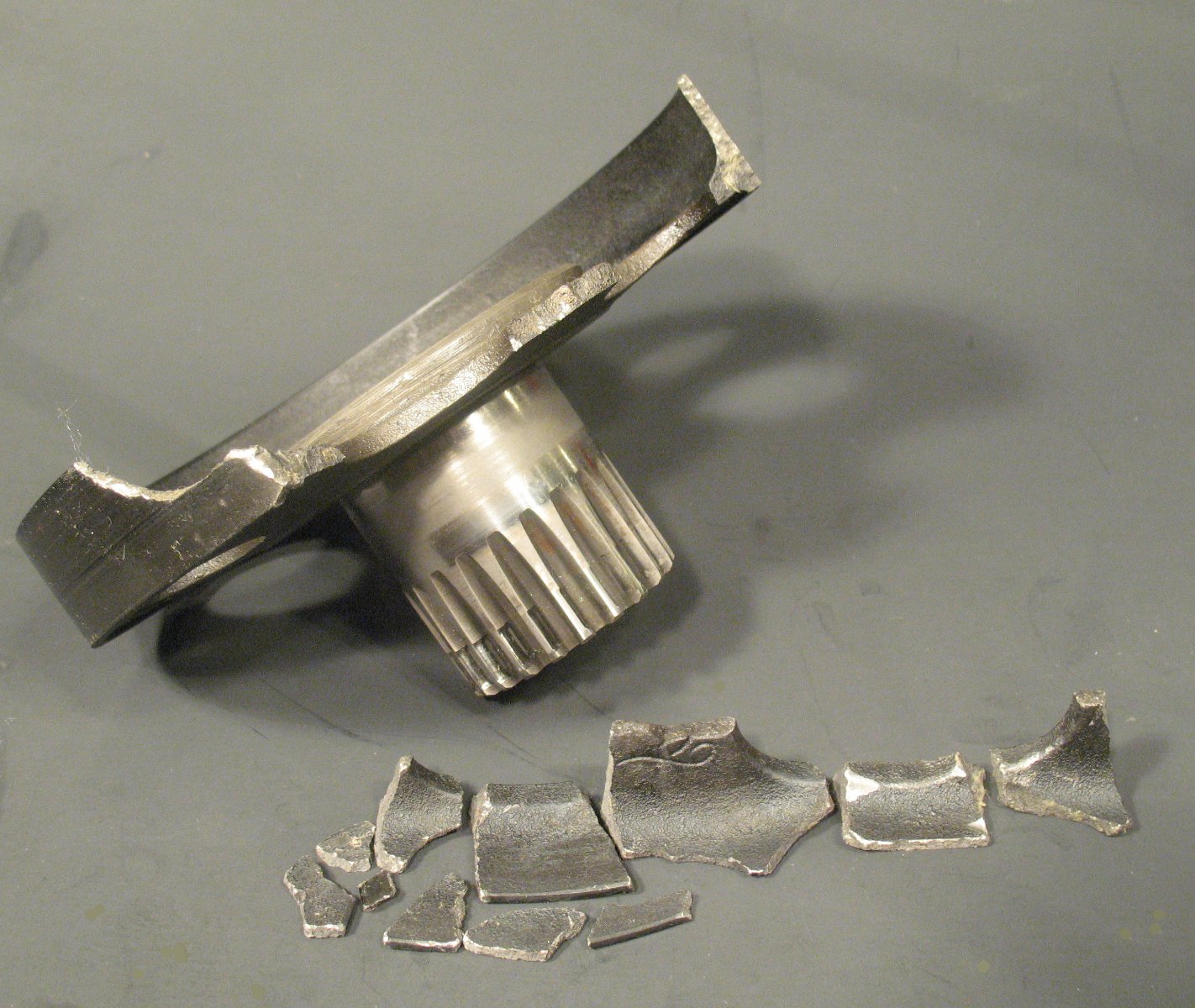

I always preach aggressive use of the pedals, tromping down and not letting the drums slip. But I'm afraid I may have been guilty of carelessness in that department. Today I cleaned up the broken low drum from my 1923 touring and collected all the little bits I could find.

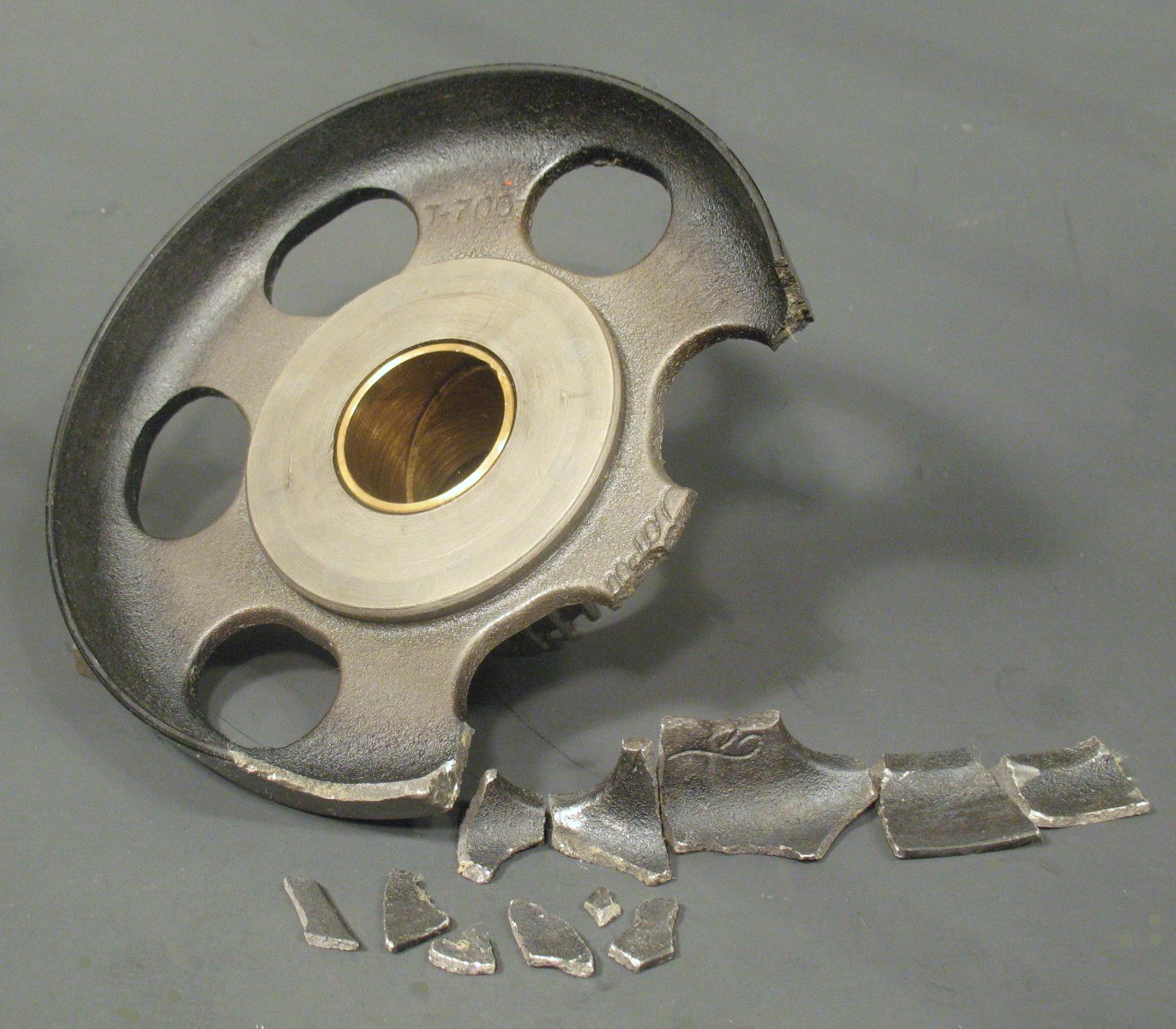

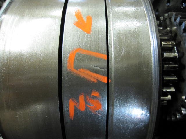

Looking closely at the remains, it appears to me that there may have been at least one crack in the web. But the dark color around the outside of the drum suggests heat, which makes me suspect that I may have been careless with the low pedal.

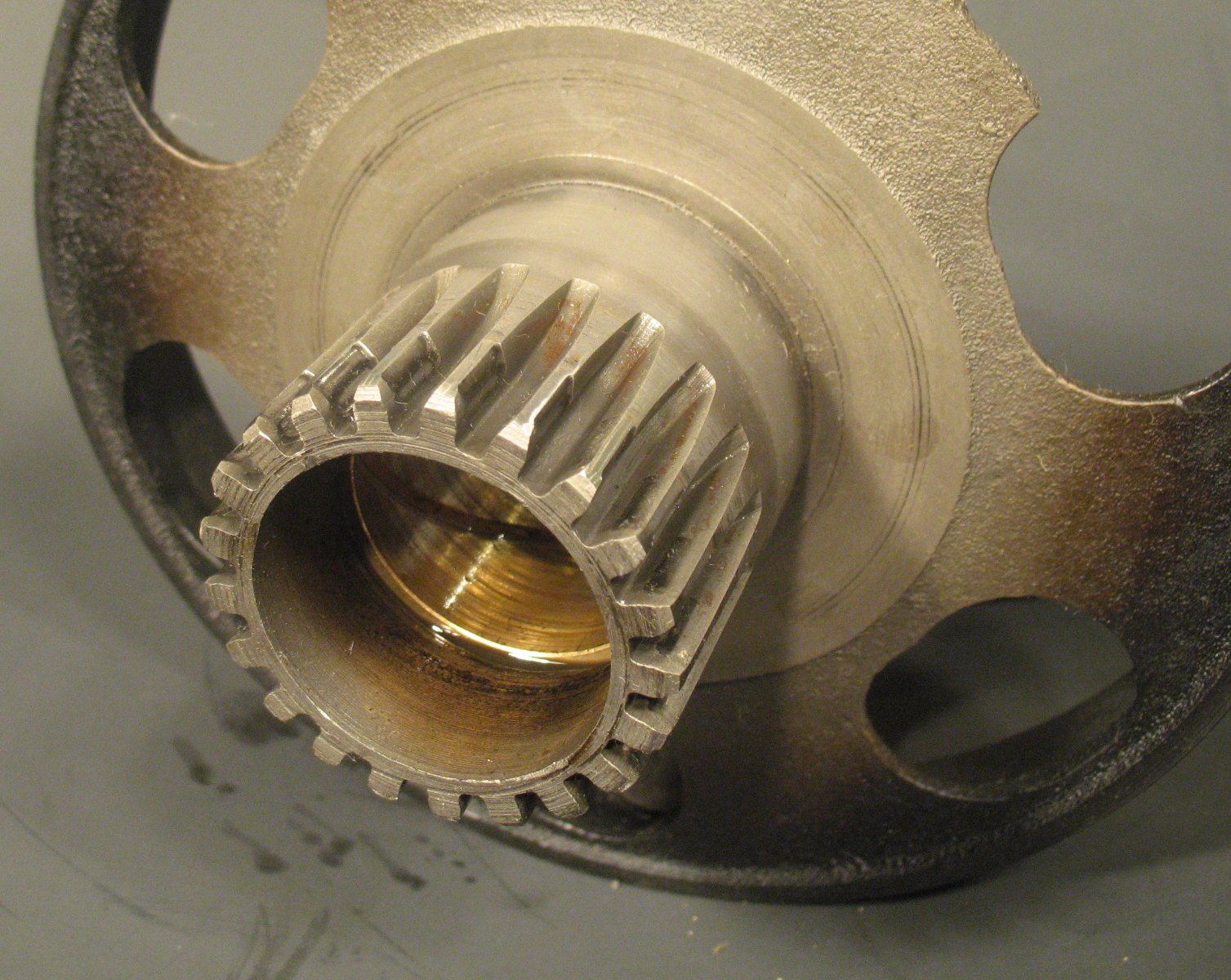

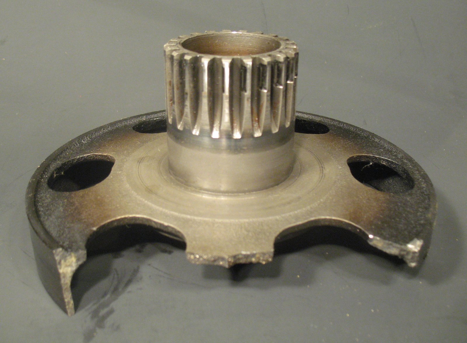

The look of the break at the far right side makes me suspect there may have been a crack there.

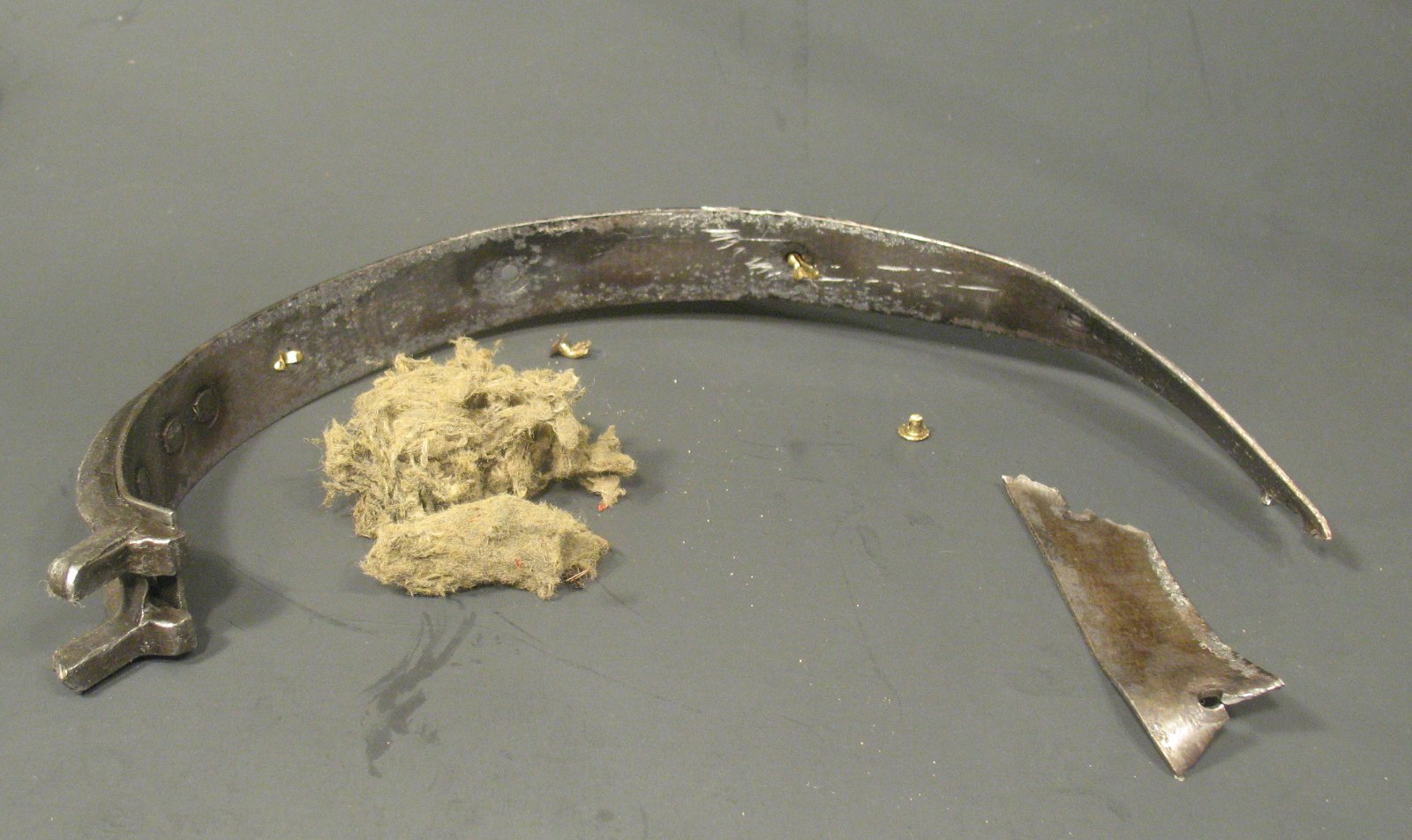

Whatever the cause, the bad drum totally shredded the lining and broke the band.

Here's another look at the break which suggests to me that there may have been cracks at that spot.

These teeth make me think I should look for a better hub.

Ah, bad luck there. Have yet to experience busted low drum, but know of several who have.
My guess is old drum, and old crack perhaps. Although treating the low speed engagement with my old T's, have tried to keep in mind the parts turning are 1908 technology, and worn and need respect.
Have always engaged low pedal slowly, but firmly, and then up to speed, 8-10 mph, withdraw the foot and work the levers to gain high speed. To me, heavy hard foot on initial take off from dead start, lots of strain on the trans and rear axle. Easy does it.
There are times to push hard and firm on low, when you are hill climbing and high is stumbling the motor, at that time going to low pedal requires a stomp. The T is moving already, slowly, but now low gear needs to be engaged quickly and firmly to get to the crest.

Steve, and old crack will show signs of the interfaces being somewhat polished, as the two sides 'work' on one another. When the calamity comes, the break lines will be clean and sharp. This may give you an idea of what happened in what order.
I agree that gear is worn too much for re-use.

By the looks of the discoloration towards the outside edge of the drum - looks as though there was "a whole lot a draggin' going on" ! That only comes from heat !

Any insight for us on how this happened? Pulling a hill?
One of the exploded low drums have viewed in the past, was due to hard stomp acceleration.
Launching on the sand for fast start at Ormond Beach, FL antique car speed trials. Owner said he took forever to clean out Kevlar shreds everywhere in the motor. The engine was hopped-up too. ;)

As Steve said the outer blue discoloration is indicative of a lot of dragging. Your low band has been too tight or slipped aggressively causing excessive heat which has caused the drum to crack and come apart. The heat came first then the drum was rendered asunder.

Steve, Sorry to see of your disaster. That definitely looks to me like heat caused the discoloration around your drum and that also looks like Kevlar lining material. I think the Kevlar is the real source of your problem. Perhaps your low pedal technique as well but it doesn't sound like it from your description. Kevlar is great from the standpoint that it doesn't wear out but it's terrible from the standpoint that it doesn't wear out. I would bet that your low band was dragging from either being set a bit too tight or from the band being distorted out of round when installed. Cotton linings will wear down if incorrectly adjusted. Kevlar won't.
Personally, I would never install Kevlar through the transmission inspection door. There is too much of a chance that the band could become distorted out of round and you'd never know it. Also, the Kevlar lined bands should be adjusted, once they are "broken/worn in", as loosely as possible and still be able to tighten on the drum. That way you'll minimize the possibility of dragging.
The "weak link" in the transmission needs to be the band linings, not the drums!! It's much easier to change linings.

After two broken low drums on the same T, I looked farther into the cause. I was and still do use Kevlar lining, but this is what I found. The low cam and low notch were very worn. The problem was that I could only get one inch above the floorboard by tightening the band so tight it would drag all the time the engine was running. Only time it would not drag was when in low when the band was locked. With a bit of experimentation, I found that the only way I could get it adjusted to run freely in neutral, reverse, or high was by adjusting it so the pedal would lock the drum lower than the floorboard. I replaced the shaft, notch, and cam. Now I get the proper adjustment and have not broken a drum since.
I would not think there are enough hills in Kansas to cause a problem with slipping band. But if the band is too tight, it will drag all the time.
When things are adjusted correctly, you should be able to put the parking brake lever in neutral on a level surface and crank the engine without moving the car. And you should also be able to push the car without turning over the engine. If it is too tight, the car will move in neutral. Note, in cold weather, the drag could be caused by stiff oil in the high speed clutch. But with the engine warmed up, you should be able to push the car in neutral without the engine turning over.

One thing no one has mentioned is the excessive wear on the low drum gear teeth. What caused that?? My 1st guess is the triple gears were not timed correctly, but. . . . . .

Believe it or not, I'm leaning toward Kevlar. The reason is that I think it was the drum that destroyed the lining, not vice versa. I was misled by this being a recent transmission rebuild. I assumed that having to adjust the low pedal was the normal breaking in that comes with new linings. But thinking back on it, I realize that it took too many adjustments. The pedal kept going lower as the lining was eaten by the bad drum. I believe this idea is backed up by the brake and reverse drums and linings being perfectly OK. The brake sees a lot more use than the low gear, so if the lining was the cause I would expect to find evidence of it on the brake.
John's comments and pictures show why I intend to bite the financial bullet and replace this broken drum with a new one.

Given your description, you're most likely correct that the low drum developed a crack across the face and that's what chewed up the band lining. Given the heat discoloration, please do consider the likelihood that a dragging band and the resulting heat is what caused the drum to crack in the first place. I've seen it several times before.
I'm sure you know the correct way to install linings on the bands. You may already know the following as well. If you decide to use Kevlar again, do be certain to form the lined bands around an old drum to make sure they are round, round, round! Install them around the drums and wire or clamp them in place before you install the pan. That will eliminate any possibility of distorting the bands. Plus, it's just easier that way.
Properly installed and adjusted, and with minimal slippage while engaging, Kevlar should be just fine.

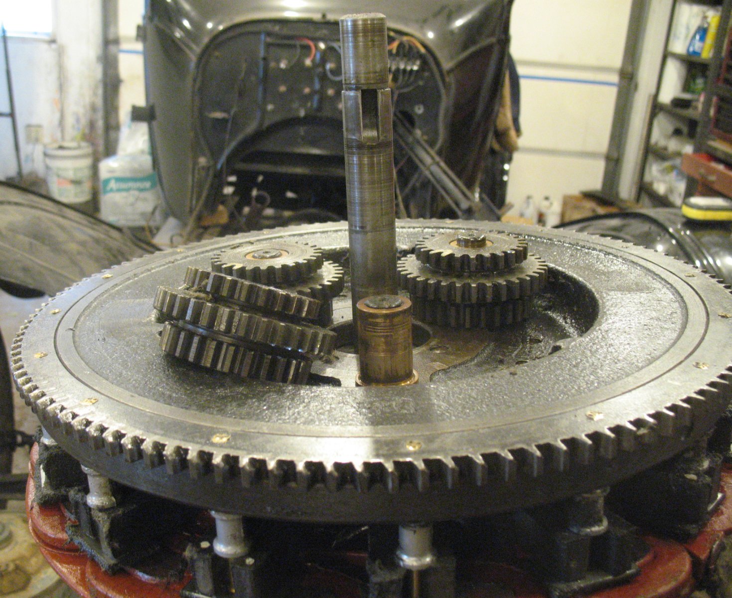

It just gets better and better. :(

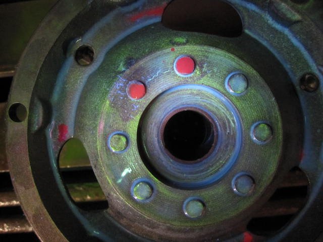

The seized bushing and untethered triple gear aren't the end of it. I also found this: https://www.youtube.com/watch?v=oNnh0acvDlY.
This is new territory for me. Is the flywheel toast, or can it be fixed?

That indicates the bushing was too tight on the shaft. Better too loose than too tight. That also explains why the gear teeth on the low drum were worn. Looks like you need a complete transmission rebuild.

Steve, the seized bushing can be removed by grinding out the side to relax it off the pin. My concern is the pin which is protruding from the other gear. This may indicate that the pin has moved in the flywheel, in which case I would indeed replace that flywheel.

Maybe it's my bad eyes, but it looks to me in Steve's video that the pin is loose in the flywheel and is moving with the triple gear when Steve wiggles it. :?
That is exactly the issue! The pin is loose in the flywheel.
@Steve, it looks like a new flywheel! It may retire for use in a HCCT though.
(You may swap one from a HCCT if you have one)

Mr.Jelf the flywheel is toast.
It's not uncommon to see bushings fused to the pins but another to see the pin moving!
I stated earlier that all parts should be crack checked and flywheel is one of those parts.
There is one triple gear pin hole that lines up with two other holes on the flywheel and this is where they crack.
While you have it all apart I would also check magnets to see if they're broken by hitting them against edge of table, don't be surprised if some break.
It's not rocket science to rebuild the flywheel you just need some tools to do so.
You need to remember to push the pins out the right way towards the magnets, not the other way.
Other thing you'll need to check is the pin hole size and size of triple gear pins as there are some oversize ones floating around out there on parts shelves. If you don't you'll crack the flywheel. I believe Bob's has the correct bushings and pins unless you want use Dan Mceachern's needle bearings and pins.

Even when I asked if the flywheel is toast I was pretty sure of the answer. Fortunately I have a few others, so finding a replacement should not be a problem. I also have several low drums, so it should also be no trouble finding a better gear. I believe this hogshead has a new low pedal notch and cam, but it's been over two years since the work was done, so I'll check to be sure.
I suppose replacing the flywheel means I'll need to pull the crank shaft and balance it and the flywheel together after the magnets are installed. I guess I should look at this as an opportunity to get some much needed mechanical experience.

What kind of band linings are going back in your fixed up transmission?
Steve
Could have been the drum, as you posted. On tour last year a fellow's T kept loosing low pedal, so it was adjusted continually until the T just couldn't move in low pedal.
Examination showed the Kevlar lining on the low drum was thinned so much, and closer view showed the culprit......a crack across the lining surface, that ate away the lining. The un-detected crack was the reason low band had to be adjusted so frequently.

Steve Jelf wrote:
Wed Jan 29, 2020 10:51 pm
Not the flywheel and crank together.! Who told you that? You'll need to rebalance the flywheel and weight match the triple gears .
You don't need to balance the crank to replace the flywheel : Unless you want to.
Nobody. I've just seen it done that way. If I can do just the assembled flywheel on the balancer, that's what I'll do.
I'll be gone for a couple of weeks, so this work will have to wait.
