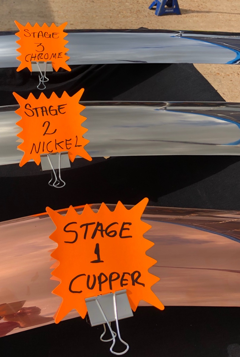

On ferrous metal the plating process is copper layer, then nickel. To chrome, the chromium is layered over the nickel as oxidation prevention. The chrome gives the whiter shine to nickel layer.
Yes those oval medallions were nickel, the steel clamps behind were painted, have seen original oval pieces with nickel remains.

What I have read over the years is that the nickle used under the chrome overlay is different then when used alone.
By David Dewey, N. California on Friday, August 24, 2018 - 03:41 pm:
Most modern platers put on a very thin coat of bright nickel, then add the chrome. It's called "bright nickel" as it comes out of the plating vat shiny, unlike "grey nickel" which has to be polished to shine.
what you want is a very thick coat of nickel, so it will last through many polishings AND prevent corrosion from passing through it. A good solid copper plate underneath also helps longevity.

It was my understanding that the first copper layer was to enhance adhesion. Chrome plating is porous, so nickel was applied before the chrome to seal the surface.
