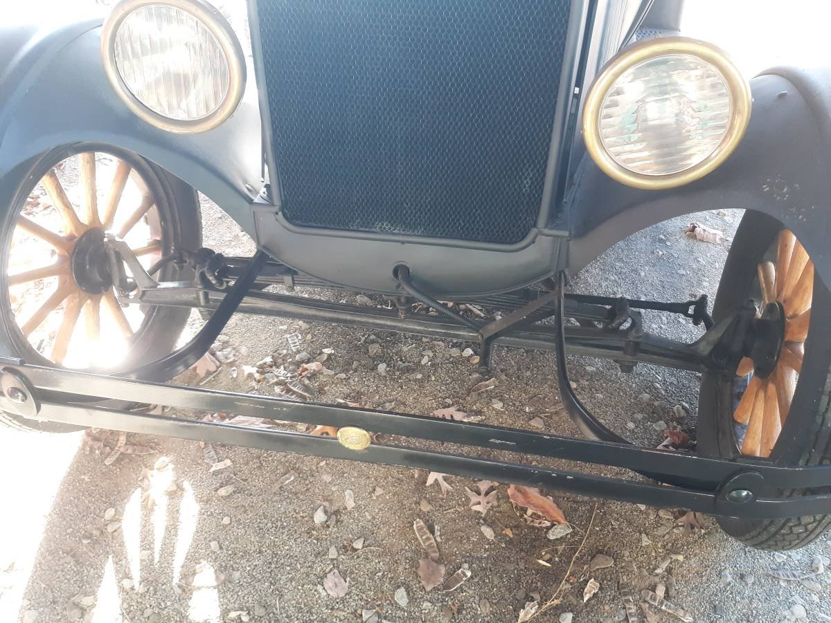

im going to look at some wheels that have new spokes. they were done prior to the current owner. what should i look for
to tell if they are hickory

Color and grain, but if you are not a knowledgeable wood guy you may not be able to tell. Older usa made hammers, axes, and similar wood handles were typically hickory. Find an older tool and scrape the surface of the wood and compare the color and grain against known other species of wood. If you can see a difference you should be able to do the same to the wood spokes.

For those who are new to the subject I'll point out that Philip's question is important. Some folks have made the mistake of using oak or other unsuitable woods for their spokes. If I was at home I'd post a picture of the unfortunate results that can have. Don't do it.

As stated above, hickory tool handles are good examples, if you can find a hardware store that sells hickory handles, stop in take a look, the wood is distinctive once you've examined it. Good luck, jb
