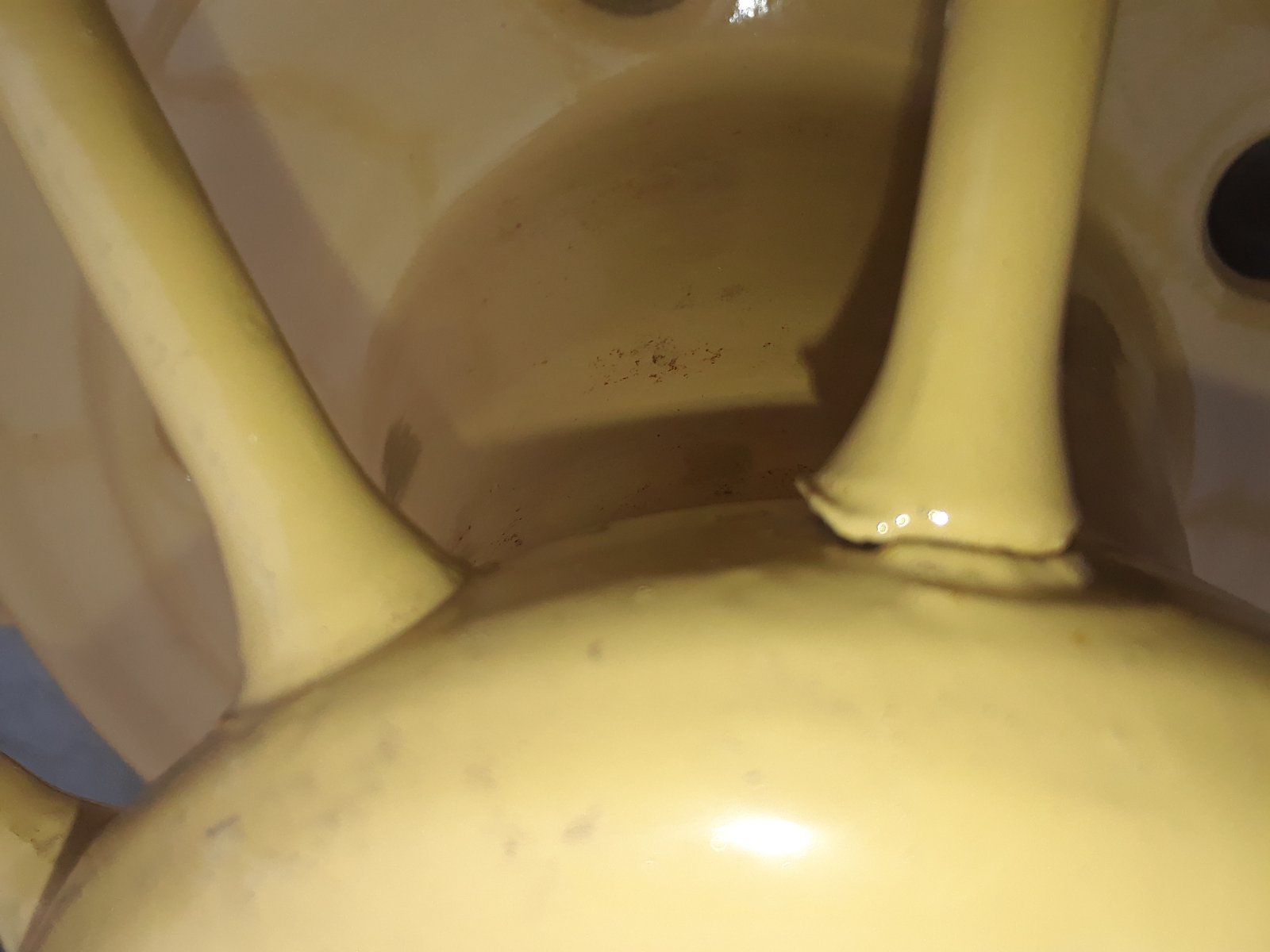

Today, while getting ready to mount a new 21" tire on a previously powder coated wheel, I found a separated weld on a spoke that I had missed before sending them to be powder coated. The weld is on the end of a long spoke going from the rim to the hub, and is on the hub end, right next to the hub cap hole. I know that if I have it re-welded, the powder coating will be "toast'. I, also, know that left as is, even if I don't have an accident, the loose spoke may weaken the wheel by putting extra stress on the remaining spokes. I won't do the welding myself, but leave it to my professional friend. What are some suggestions from owners who have encountered this problem, previously? One thought that I had, was since i could get to the inside of the hub where the spoke is welded to the hub on the outside of the hub, I could drill a hole through the side of the hub right on top of where the spoke was originally welded on the outside of the hub. The arc welding rod, could then touch the end of the spoke with the broken weld and then fill in the drilled hole. That way, no repair would be visible from the outside of the hub. What do you think? any other suggestions?

Terry, I have done exactly as you suggest a number of times, but always on the rim end at this stage. The hub end should be no different. If you can't get a line up to use a drill, the same effect could be achieved with a 1/4" burr in a die grinder. I use a MIG to do the weld. The trick is not to get so much penetration that you upset the appearance of the hub on the outside. The hub spokes appear to be in a slight machined depression on the outer spoke end, and it would be nice if this is preserved. The inner spoke end is just like the rim end.

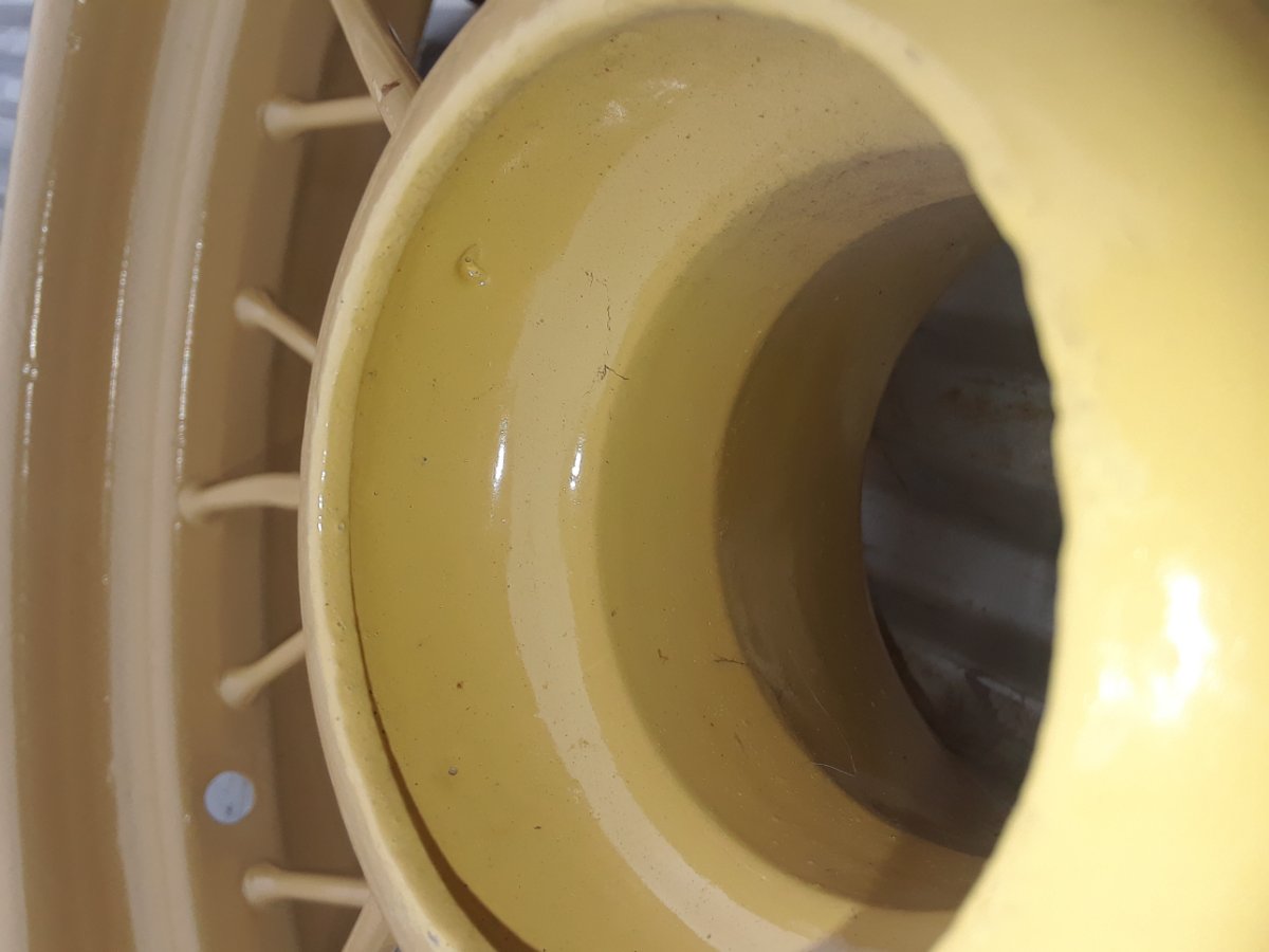

Spoke in 9 o clock position in first picture has broken weld at hub. I propose to drill hole on top of loose spoke to weld it from inside hub. Broken weld is clearly visible at hub/right spoke in second picture

Terry, if it is possible, tap the spoke aside when you drill the hole. That way you will get a clean hole which will give you a stronger weld.
Two points to mention. I tap the spokes with the wooden handle of a hammer to check if any spokes are unsound before doing any other work. The duds will not ring like sound ones.
