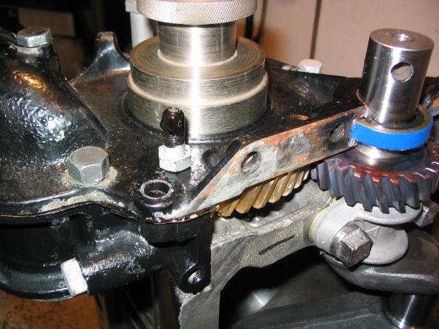

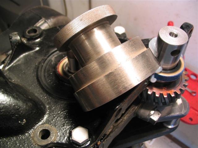

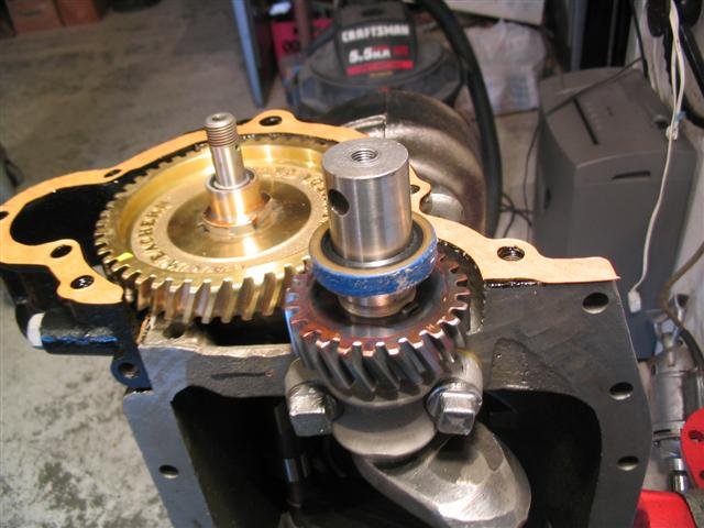

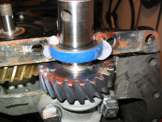

Bill , I use the rope style from Lang's # 3012 R
and I glue a seal on the outside like in the picture Toon

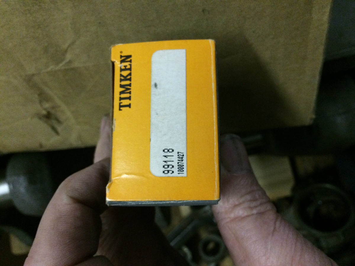

Another option to consider is to install a “SpeediSleeve” where the packing runs.
I’ve built up the worn area with “plastic metal”
and turned it down to size. Then drive on the Speedi sleeve (Timken # 99118). Now you have a surface that is BETTER than new and totally invisible outside!

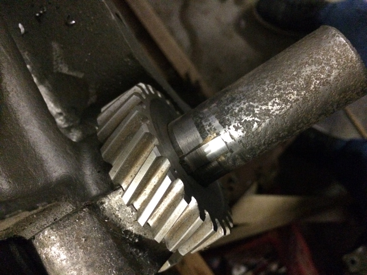

Thanks for posting this.I am at a point that this is important info.I was looking at the seals and thought of geting the neopreme.But Thanks Norm for reminding me that I would have to take the engine loose to get it out.
There are some pits in the crankshaft on mine ,tiny but there.I was thinking of using Liquid steel or similar to give a smooth surface for whatever seal to ride on .I don't know if I can still get that brand.I used it on a new hydrolic cylinder that got gouged and it worked great to fill a groove.

Speedi-Sleeve is the way to go, and that is what Scott's link to Lang's appears to be. I have used them for this and several other applications and there is no substitute. I do not have one handy otherwise I would give you the part number. Measure the size of the crank seal surface and look up Speedi-Sleeve and determine what part number you need. Then search for that part number on the internet, nothing against Lang's but you may be able to find it for half of what Lang's (or any parts house) is asking (I usually do).
If the surface is badly worn, I build the surface up with JB Weld then use a file to dress it down to correct size before installing the sleeve using unworn adjacent surfaces as a guide.
Terry
Terry

Thanks Les for that part number,
https://www.oreillyauto.com/detail/b/na ... 18/2552594
I can stop in and get the store to order me 1.I like talking to the gal in there anyhow.

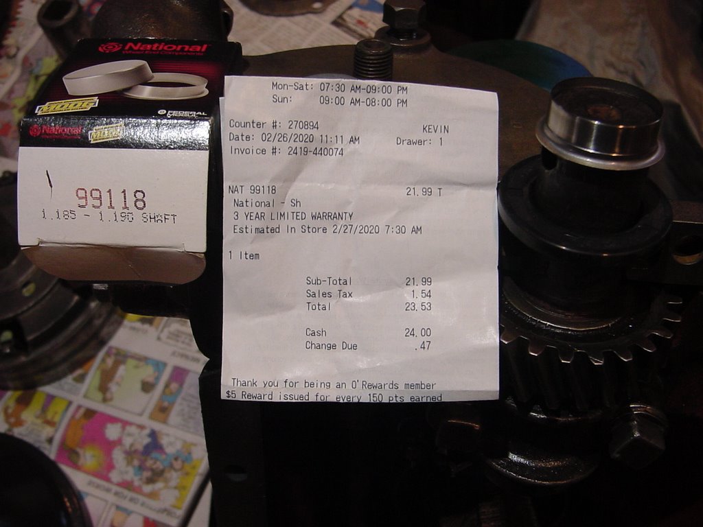

For this price,I would rather go ahead and use the speedy sleeve.I used 1 of a different size on the right rear axle of my 66F100 that would just not stop dripping rear end oil on the brakes.Fixed the problem!

Just ordered a 99118 speedi-sleeve from Rockauto with tax and shipped to my door for $22,69 (with discount code 129534791118895320). Thanks for the info!

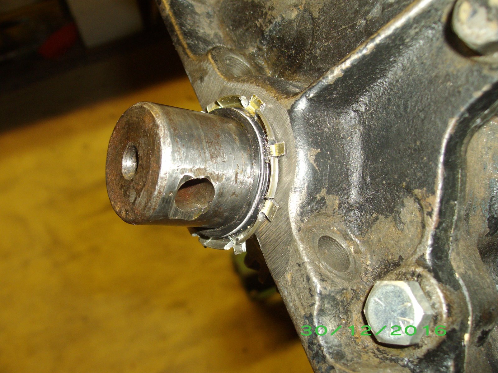

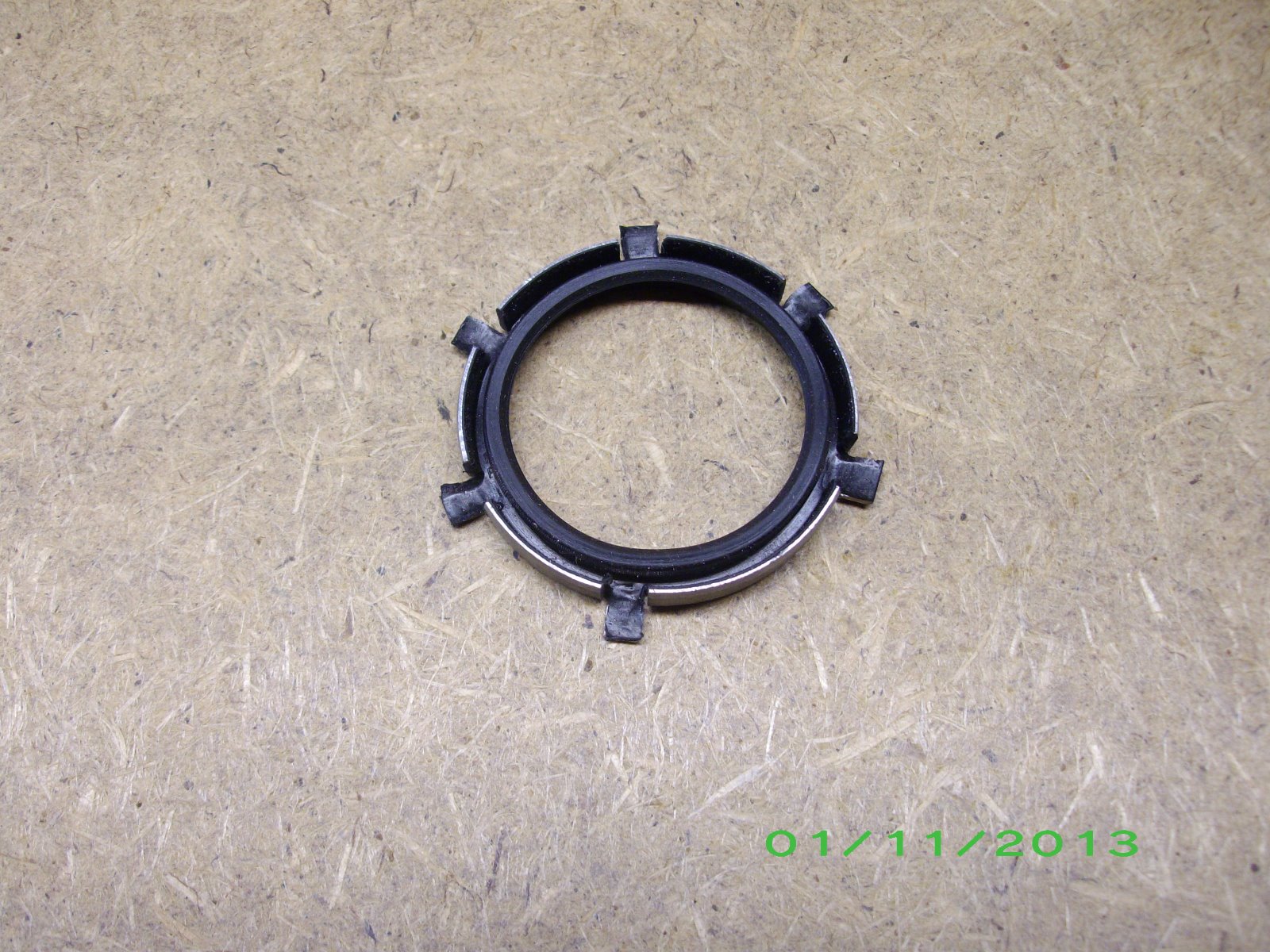

Use a 30 X 50 X 05 AO - VBR modern seal on the outside glued on with Ultra Black for a leakfree crankshaft. If your engine is in the car you can not replace the stock seal. this seal is very thin and will fit between most crank pulleys and the block with no interference!
You may also install it like the pictures Toon posted. I like to cut all the web and flatten it like a daisy flower to allow a fit between the alum pulley.
This is a must do anytime you have the radiator off or the pulley off if you have any evidence of an oil leak.

https://www.metricsealsinc.com/30x50x5- ... 0-x-5-baof
Gene ,is the seal you speak of like this? I had a bit of trouble translating the numbers using google.

Mack, Yes The seal with a spring is designed for low pressure. You can look at Harwal Rotary Shaft Oil Seals. after the size the "ADL" designation is with a seal and a dust lip. It is a VBR which means Viton Black Rubber. On their site you can search the different sizes and the 30 50 05 works on most T's because it is one of the thinnest at 05 thick. hope this helps

I did make it by Orielys and ordered the sleeve!. I am still going to fill the small pits on the shaft and smooth it up so this modern seal will have a smooth surface to ride on. The pits are not large but when oil is involved it seeks out the tinyest of places to escape.

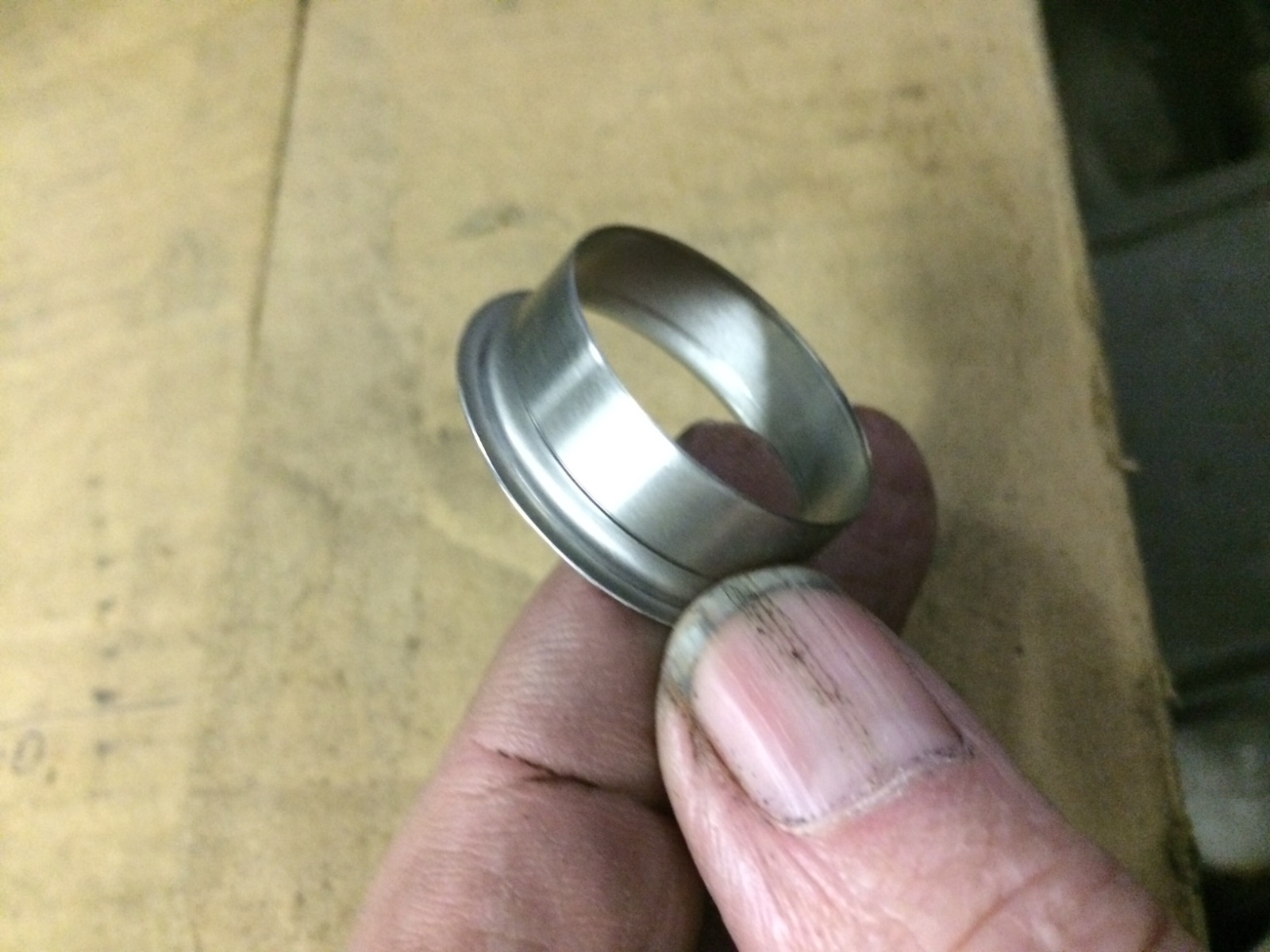

Question. The lip on the speedy sleeve,considering the crank seal is not all the way back against the gear on the crankshaft,the lip of the speedy sleeve would need to be removed once it was on the crank shaft because the seal runs a 1/4 inch or a tad more ahead of the gear right?

I thought I would bump this because of the question about the lip of the speedy sleeve.
The seal is out from the gear a bit and I don't understand what to do about the lip on it.

Bumpty again OK I was sent a Email from a nice fellow that explained the lip gets broken off after install. So that clears up the muddy water for me.Thanks folks the help I do get here.Without help from folks and affordable parts when needed,I couldn't enjoy this hobby.
