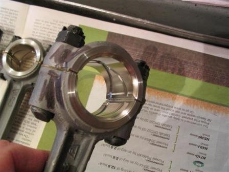

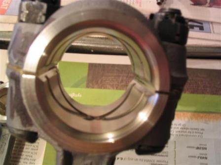

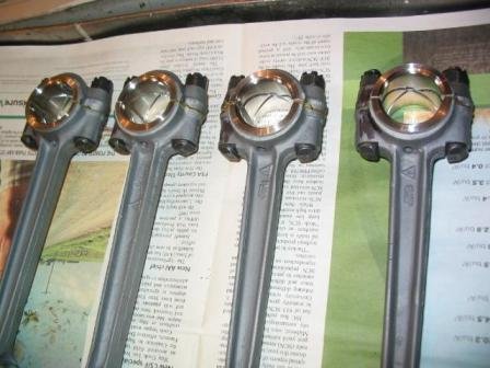

Rod should be, an 1.500, wide. Side clearance has always varied, from crank, to crank, on Model T's.
At that, side play should should not be under .005, and not over .008. .010, and .012 is getting loose, although, many are, but it still doesn't make it right.
We always cut them to fit the crank, on the engines we built.
Just make sure the rods are in Aliment for, Twist, Bend, and off set. There is a large percentage they are not, or not done we built.
Herm.
