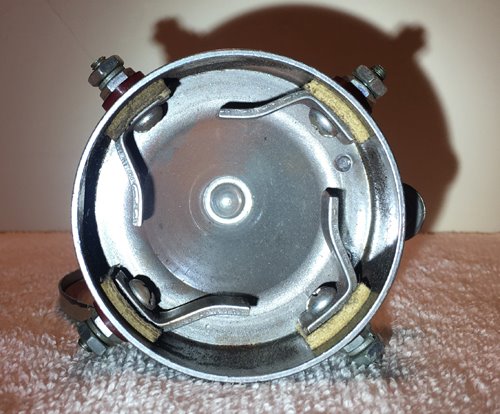

Which part of the flat contact gets touched by the flapper first? The butt end or the ramp?

The flapper contacts the end of the segment first and then rides down the ramp.
(The cam turns counter-clockwise if you are standing in front of the car. The cam turns clockwise if you are sitting in the car.)

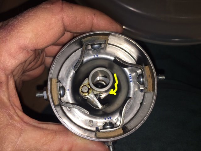

Like this? Keep in mind that this view is reversed from what we normally see.

Yes, that is correct.

All of my Model T life I have assumed that the flapper touches the ramp first, then "flaps" off the butt end to get ready for the next strike. That just seems more logical to me. Now, a project that I'm working on has me looking closely at the mechanics of the timer, and I thought "no way". After talking to several others their answer was - ramp first. So that is what brought up my question.
