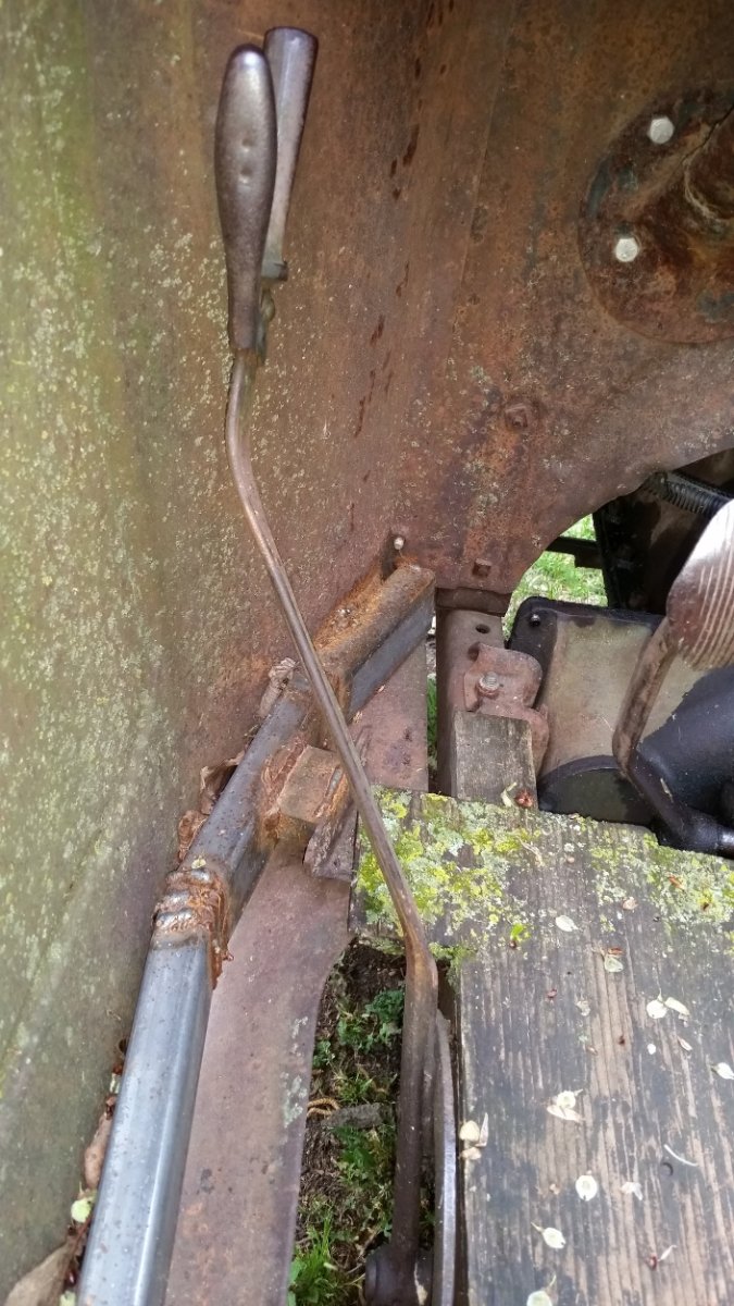

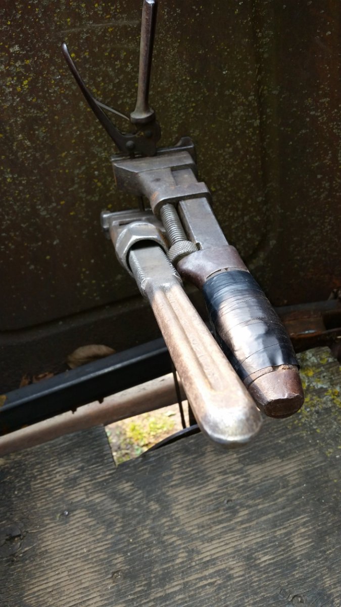

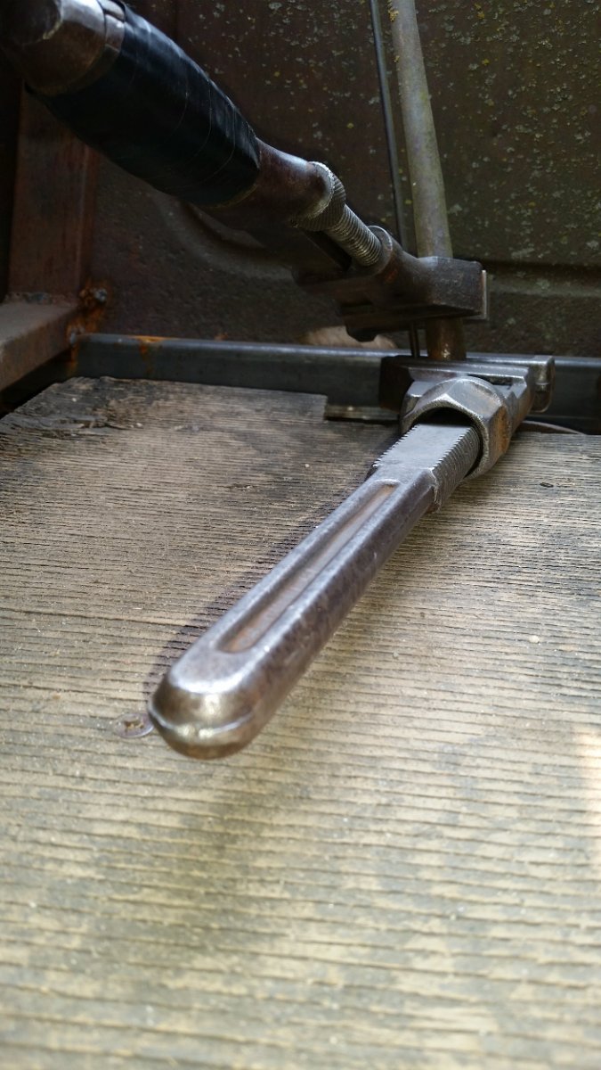

Forming the control shaft handle into a Z shape. They bugged me poking at my leg incessantly! One for 20 years! Ahhh. Better now.

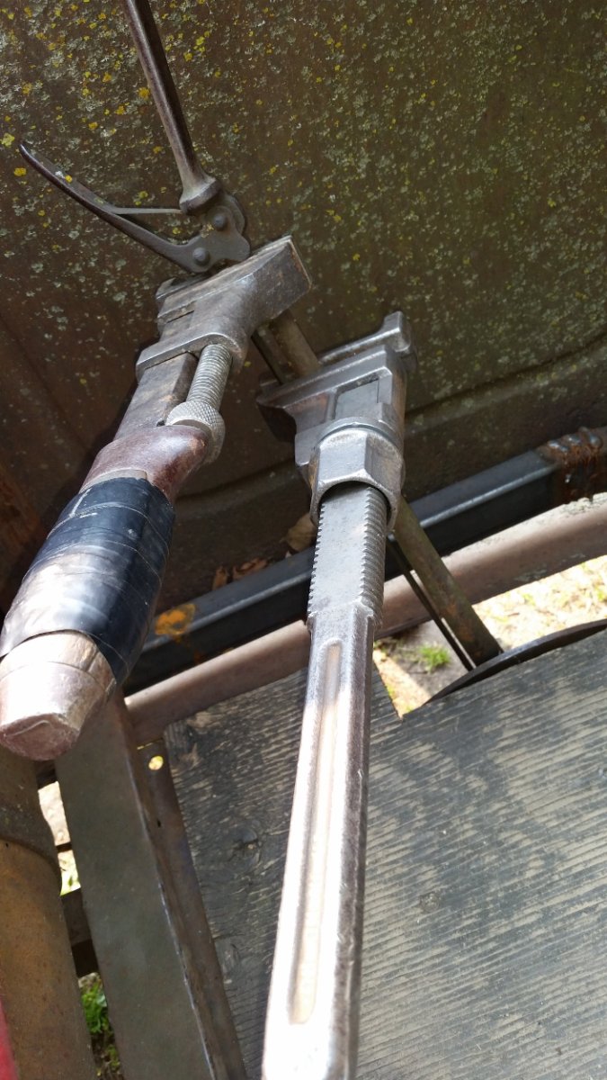

Tools: Two Monkey wrenches/adjustable spanners, Stillson's?, 90 degree railroad wrenches and not Crescent wrenches.
A fella could weld some bits together and make his own forming wrenches also. :)
No torch. No muss-no fuss. Shown is the short box '24 Runabout pickup. Please do not chastise me for the details in the background.
If you feel the need to throw up at said background details? Turn away from your keyboard.
Maybe I'll run across the pics from the original '18 with the PsychOdelic paint. That one is way nicer.
I borrowed a railroad wrench from a friend for this. Mine is the taped-up, wooden handled NPR wrench. Not National Public Radio.
Start at the bottom and work UP. Go back and Z the 1/4" rod for the pawl. Larry, these may not be correct part names. Sorry. :)
Bend yours to suit your T. Remember, the books ask us to turn our left hand around and grab from the inside of the lever so...
Voila!

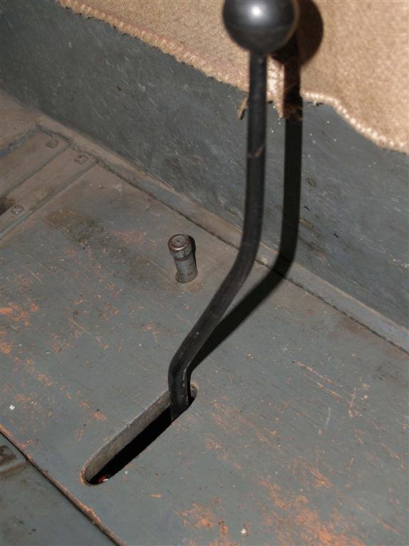

I have done this to both of my T's. I used the oxy/acetylene torch and heated it just shy of red. I first bent the upper part of the rod inward, then bent the lower part outward. I bent them in the car, bending both the lever and the release rod at the same time.

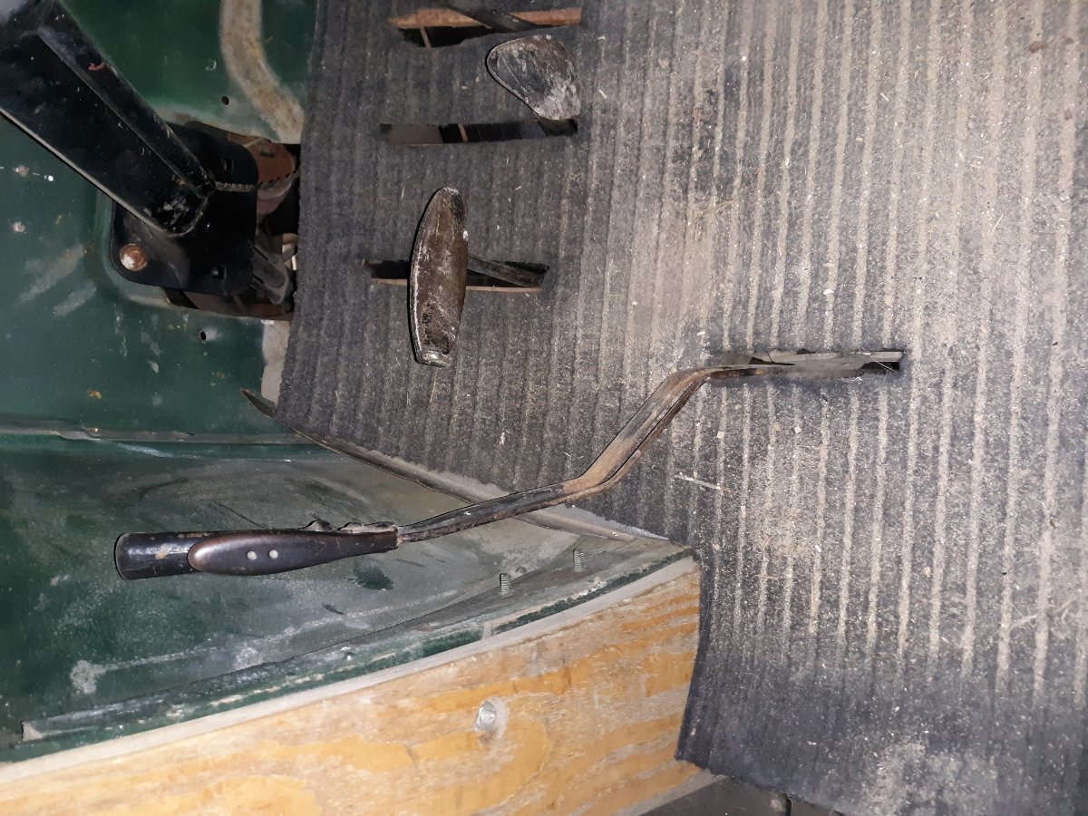

This is the woody wagon T built from a Fordor cowl.

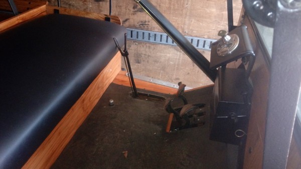

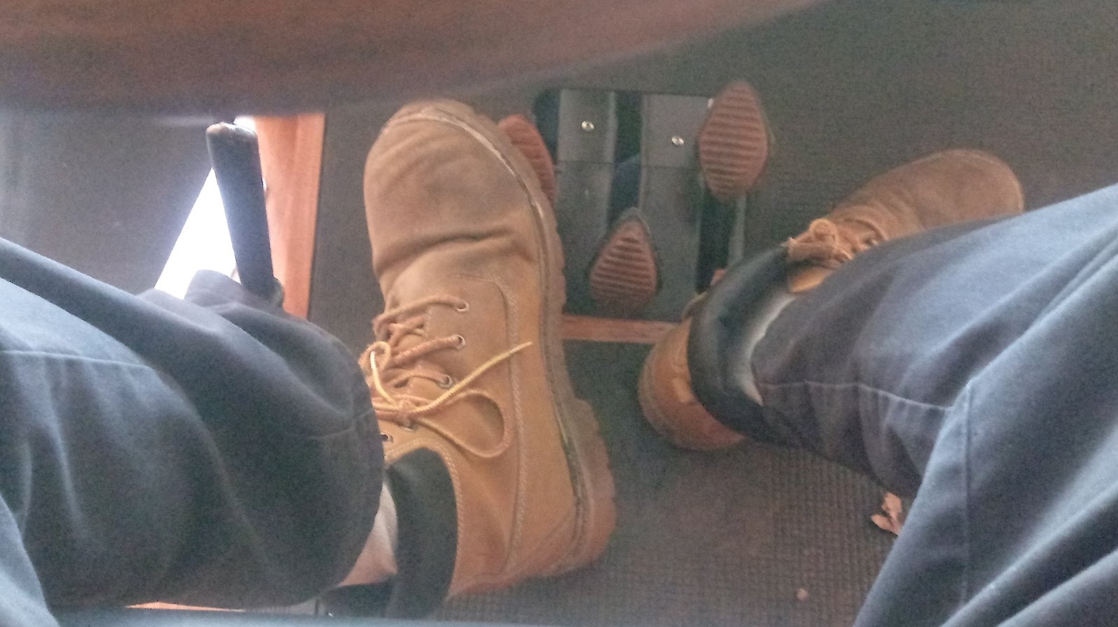

I finally got around to taking a couple pics.I don't think I have enough lever to zee and still be able to reach down to get it. I could use the room though!
Yes,I know,my shoe bottoms back on! :lol: Referring to that frugal thread the other day.

Mack, if the photos are of the same car with which you have a parking brake issue in another thread, it may well indicate that your linings are well worn, or the drums too. Your lever is at the back of the floorboard slot, and touching the seat squab. New linings will see the brakes applied earlier, with the lever much further forward. However, this may not apply in a custom build where the floorboard slot is in other than the factory position and the seat squab is not standard either.
When I put new linings in Henrietta, the handbrake is fully engaged just over half way back.
hope this helps, Allan from down under.

I have to really pull hard to make the lever go all the way back.It holds the car 3 or clics back from midway.I just always park it with the lever at max.I made everything according to the measurements in the plans but the seat cushion should have been shorter. A member with a similar body on a 26 frame told me to do some checking about size and to modify the plans a little but did i do that? No,I had to try to be Mr. Smarty pants and follow the plans to closely on the sizes. Now my horizonaly challenged self is shoehorned in the truck! :lol:
Posts: 6800
Re: Zee-ing the parking brake lever.
Post by Scott_Conger » Sun Feb 23, 2020 10:52 pm
Mack
Allan is right. Your handbrake is at an angle that no mere human should be able to attain. Your linkage is slack or there is something flexing dreadfully. That's far farther back than "3 clicks" from setting neutral, which by the way should already be engaged on the handbrake cam slightly BEFORE it is perfectly vertical. On my cars, the difference between "neutral" or vertical and having brakes hard ON is just a little more brake lever movement...not throwing it into the seat. This is a vastly different scenario than you provided in your "parking brake" thread.
The difference in brakes between vertical (not on) and absolutely socked down should be something like another inch + of travel at the handle. Not progressively more handle and progressively more brake. Your brakes should be either ON of OFF with very little spare movement of the brake lever.

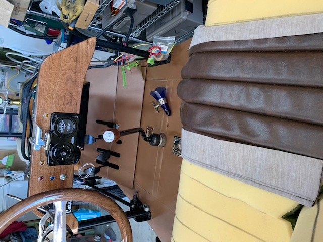

Z'd Warford lever

David, I bet that helps a bunch, especially with the gas pedal! Cool cruiser. 8-) I like your thinking! :lol:

The lever is all the way back in that 1 photo because I get on the side of the truck and pull with both hands to get it there.No way I can put it there sitting in the truck.I do that so it won't roll or move and if some some ding bat trys to steal it it will be harder to move.
