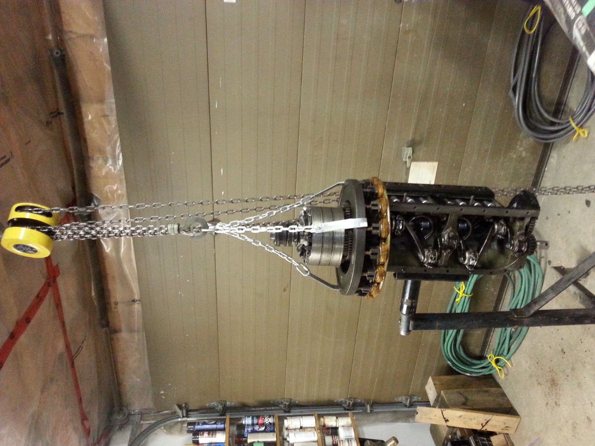

In 2010, I made an engine stand for holding the engine vertical, on its’ nose. See www.mtfca.com/discus/messages/118802/152658.html. This was especially useful in gapping the magnets and mag coils. I had to lift the transmission on and off a dozen times as I added and removed the shims until I finally got the gaps perfect on all magnets. What a job! But it as made much easier with the stand I made.
Tip: As you remove the mag coil from the block, carefully keep track of the shims you remove from between the mag coil and block and label each and where they go. Take care. There may be a number of very thin brass shims under each hole. If the engine is on its’ nose, they will not fall out as easily and can be re-used. This may make gapping easier when you are ready to reassemble. Jim Patrick

PS. Regarding the vertical engine stand I made above, being that it holds the flange at about waist high, it is the perfect height for the average man to lift the heavy transmission on and off the flange, as you gap the magnets using a set of brass feeler gauges. It also allows you to easily move the engine around your shop, using a hand truck. Jim Patrick

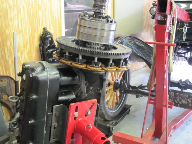

Hi All

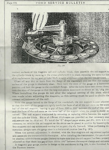

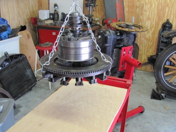

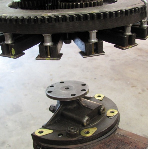

Alternate method of transmitting fitting. From the MTFCA engine rebuild manual.
Way easier when it has to come on/off a few times when checking coil ring shims.
Drive Safe
Jeff
Nova Scotia

The reason we have to adjust the gap, using various thicknesses of shims is to compensate for many years of wear that cause the magnet to mag coil gap to vary from when it was new. Since time was of the essence on the assembly line, not much time was allotted for time consuming adjustments, so I’m inclined to believe that, since brand new parts were being used, with all of them being pretty much identical, that, once the various components were assembled by very experienced technicians, the mag/mag coil gap was automatically within the tolerances allowed when the transmission was mounted onto the flange. Jim Patrick
