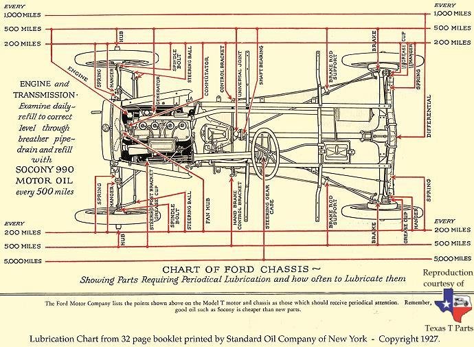

Sealing the shafts is a good thing IF you understand that the prevailing trick using O-rings will starve the low pedal shaft of lubrication. It's an inelegant ad-hoc solution relying on uncontrolled compression of the o-ring.
A better solution is to machine the outside of the hogs-head bosses for small lip seals.
In either case, you will also want to watch your reverse and brake cams to see if they get any, or enough oil, or have to provide additional lube as necessary during operation.
- Posts: 6542
Re: Pedal Shaft Seals
Point well taken. Not indicated on the lube chart.Scott_Conger wrote: ↑Tue Feb 25, 2020 10:06 am..... In either case, you will also want to watch your reverse and brake cams to see if they get any, or enough oil, or have to provide additional lube as necessary during operation.

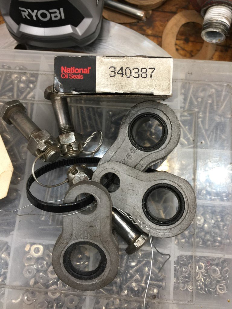

Here are the shaft seals I put on mine.
Respectfully Submitted,
Be_Zero_Be
Be_Zero_Be
- Posts: 1497
- First Name: Keith
- Last Name: Townsend
- Location: Gresham, Orygun
I have used a large tapered reamer and chamfered out the pedal cams and used regular O rings in the past.
Bob, please tell us about the seals you use and your installation technique.
A machinist friend put them in a 4-jaw and cut the recess for the seal.
The seal is a snug fit installed with Loctite.
It's good to have friends with skills.
