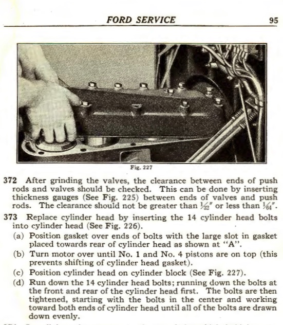

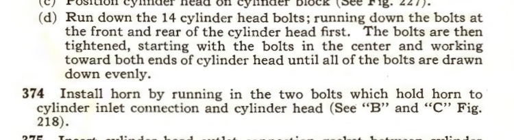

Page 95, 373 (d)
- Posts: 4046
Re: Head bolt sequence: Is it in the Bible?
As noted in Ford Service, always torque first the center bolts, gasket has thinnest walls between #1 & #2 and # 3 & #4 cylinders, helps prevent common blow out there. Sequence the others on perimeter.

Aha! A description, not a chart or diagram. That's why I didn't see it. Thanx.

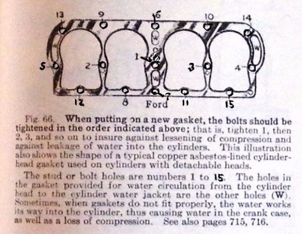

I had replied with a copy of the head bolt sequence from the manual awhile back and it was corrected by another member. Couldn't find his name but here is his corrected copy.
- Attachments
- Head bolt sequence.jpg (76.44 KiB) Viewed 7259 times

The fifteenth bolt is utilized for the electric horn bracket !
- Posts: 5474
Check out the illustration that Dan posted - you can see the where the missing #15 bolt would go !

So the missing head bolt is where the horn bracket would go? It does seem odd that the bolt hole in the head is shown without it. So it would be assumed that it would be that bolt would be tightened down last? Maybe it’s shown that way since the service manual shows a later black era car in it and that’s where the horn would go.

Then reexamining Dan's illustration and fig 226 on previous page of Ford Service cleared it up for me.

The above illustration is for the '19 - '25 horn bracket which utilizes that head bolt & one of the water inlet bolts - the '26 - '27 horn bracket utilized both water inlet bolts.

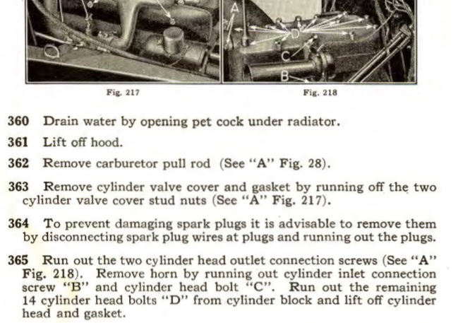

Yes. The horn holding head bolt is #15. Just cropped the Ford Service page too much. Note next line about the horn head bolt.
Earlier in the Chapter the one head ‘horn’ bolt 15 is removed and the paragraph continues about removing the balance of the 14 bolts!
