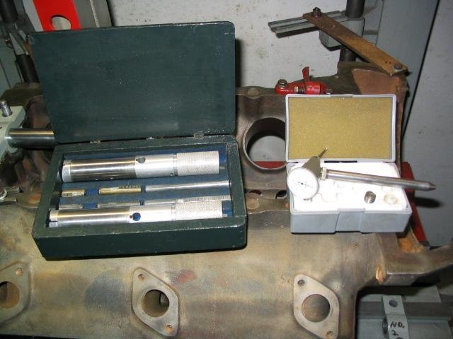

Dan's Model A, Center, to Center distance, is correct. As you can see, it is plus, or minus one thousandths.
The Model T is 3.936-70 to 3.937-80.
Never did I see those Spec's over one thousandths, and I know 4.155-00, has nothing to do with Ford Spec's.
I have never had any luck with boring bars with fixed center distance arms getting a perfect centered crankshaft in a block.
To do that, you have to have to have an independent way to adjust the boring bar side ways, and then up, and down, after that. If not, you have rear main oil leaks, on a model A's, and B's, and others. A model T, rear main, off by .010 thousandths will put the transmission tail shaft off more then that in, the ball cap area.
On Model, A's, and B's, the shaft will hit the Aluminum seal on one side, eating it for more clearance, and the other side will have a .010 thousandths gap for oil. The pilot shaft also will be out of alignment by .010 thousandths, not good.
I have had many different Brands of Align Bores, all had the same problem. It doesn't do much good to get a crankshaft ground on the center line, and then Align bore it off .010 thousandths.

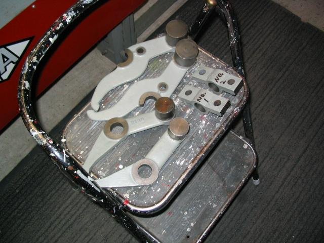

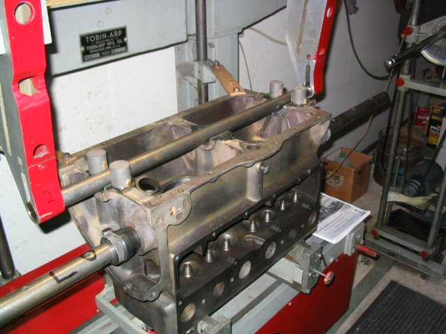

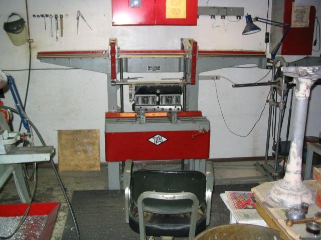

The way I fixed the problem in the Tobin-Arp is I cut 4 plugs, for, front, and rear, main holes. Between each plug, and boring bare there is about a .000-50 thousandths clearance, and they hold the bar in the middle of the main bolt holes, until the set up is done.

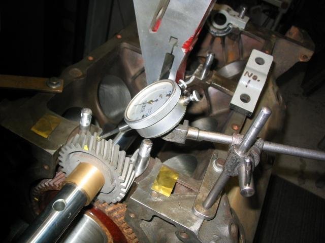

The up and down part of the setting is to Mici the out side of the cam bar, and the boring bar. That is center distance, Plus half of cam bar, plus half the boring bar. You can also confirm lash with gears, and a Dial Indicator.
