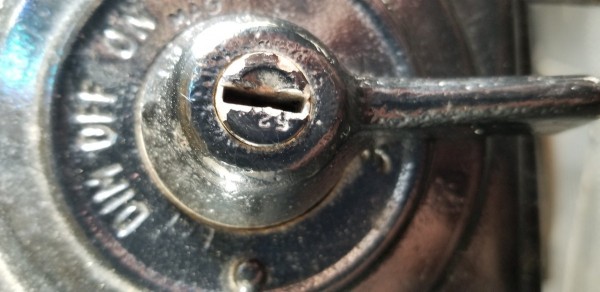

It looks like 52 to me. Anyone concur?
Posts: 4658
Re: Ignition key stolen!
Post by Norman Kling » Sun Mar 01, 2020 3:25 pm
Looks like a 52. If you know someone with a 52 you can borrow the key to see if it fits. If not, the price is not too great, so you buy one and see.

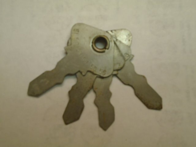

There was masters available at some vendors key nos. 51 - 56, 57 - 62, 63 - 68 and 69 - 74 all in a crimped set.

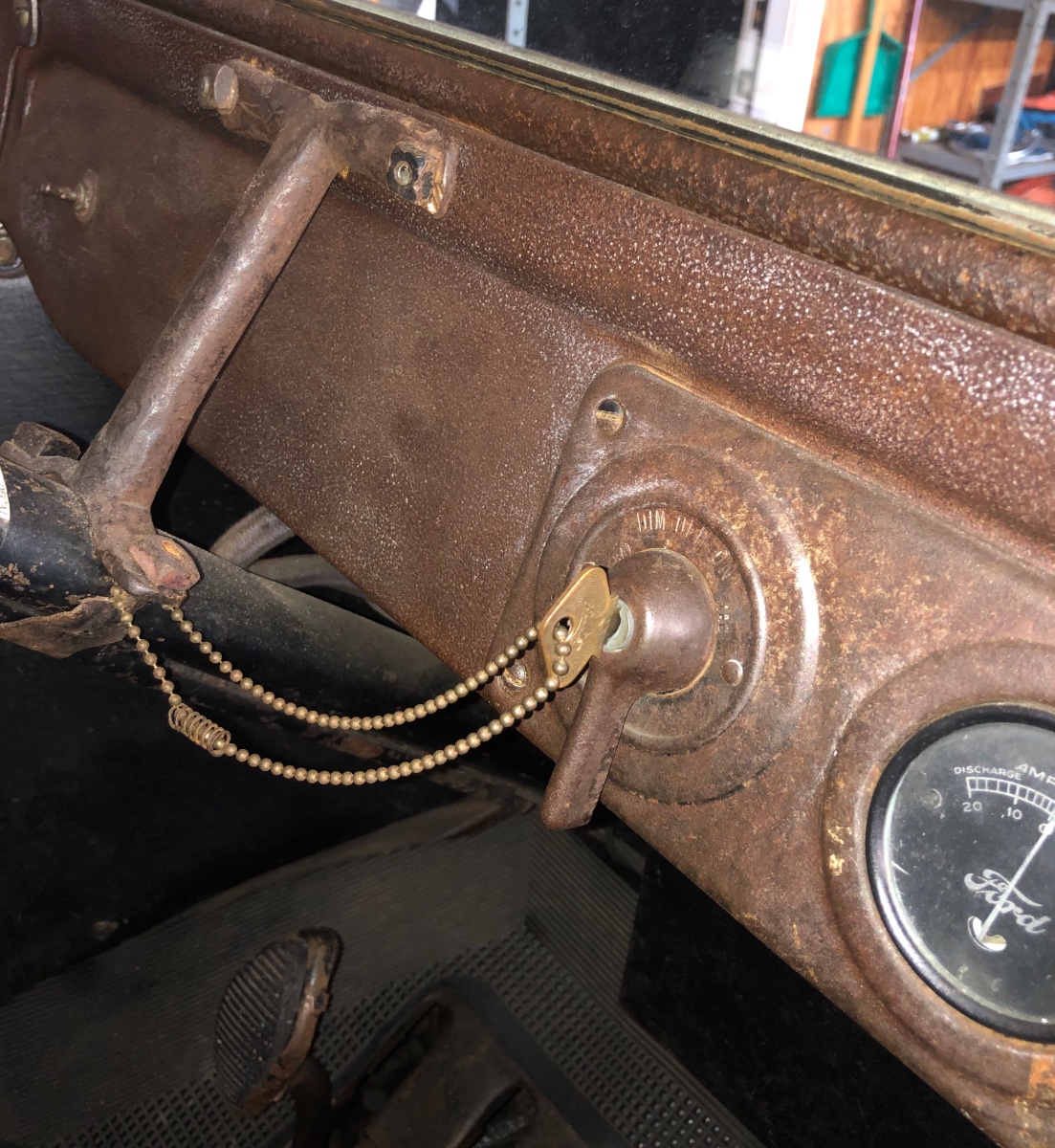

Key is chain secured.
Keeps quick passerby from pocketing 'em. :) Always in place for fast get away. 8-)
Never known to fall into the transmission abyss when adjusting the brake and reverse bands. :o
