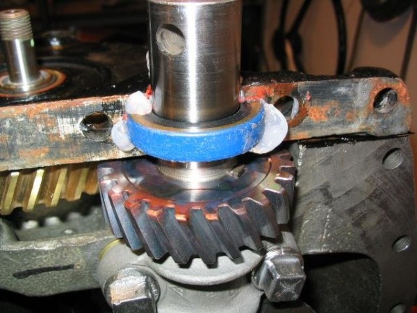

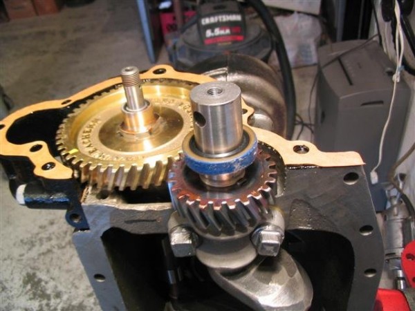

Bill , I use the rope style from Lang's # 3012 R
and I glue a seal on the outside like in the picture Toon

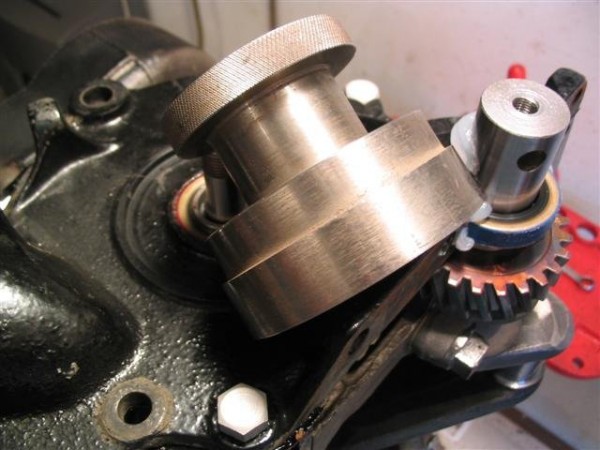

I believe the white rope seal with the little black core is stocked as an A model part. As such it is too long for a T. This is good because it allows each piece to be trimmed leaving the ends a little long to provide extra crush. They will not work on the earlier Ts with the narrow seal groove.
When installing each piece, I oil them first, and use an appropriate sized socket wrench to seat them in the grooves.

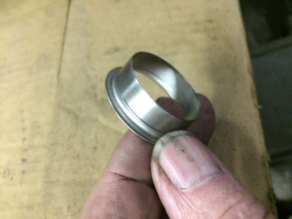

Another option to consider is to install a “SpeediSleeve” where the packing runs.
I’ve built up the worn area with “plastic metal”
and turned it down to size. Then drive on the Speedi sleeve (Timken # 99118). Now you have a surface that is BETTER than new and totally invisible outside!

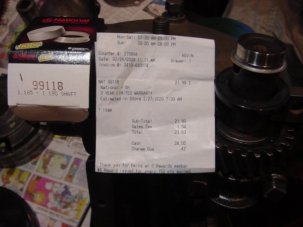

Re: Crankshaft Seals
Thanks Les for that part number,
https://www.oreillyauto.com/detail/b/na ... 18/2552594
I can stop in and get the store to order me 1.I like talking to the gal in there anyhow.
For this price,I would rather go ahead and use the speedy sleeve.I used 1 of a different size on the right rear axle of my 66F100 that would just not stop dripping rear end oil on the brakes.Fixed the problem!
Just ordered a 99118 speedi-sleeve from Rockauto with tax and shipped to my door for $22,69 (with discount code 129534791118895320). Thanks for the info!

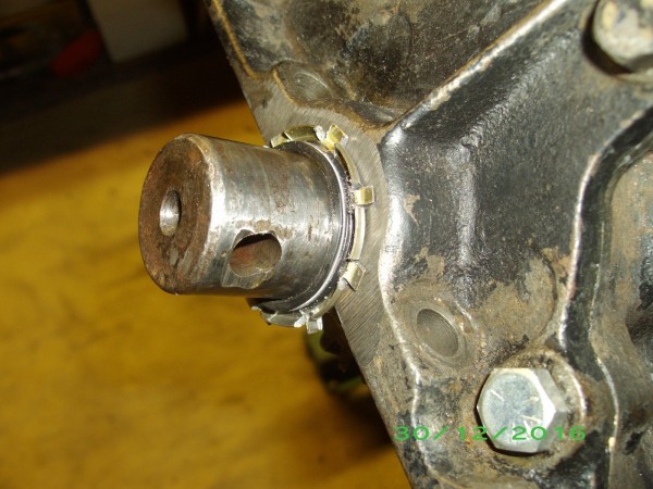

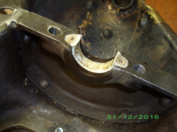

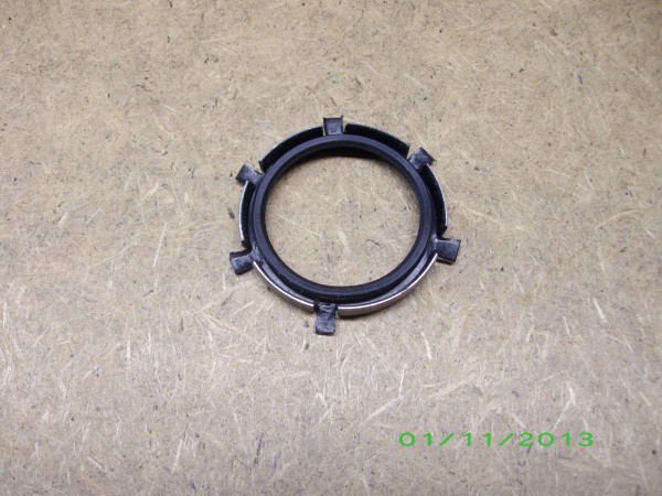

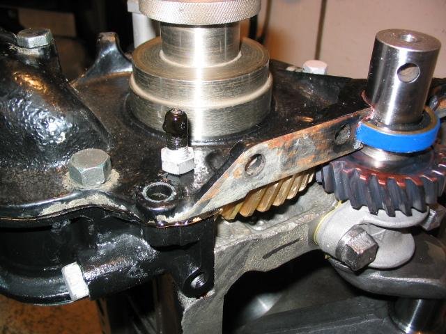

Use a 30 X 50 X 05 AO - VBR modern seal on the outside glued on with Ultra Black for a leakfree crankshaft. If your engine is in the car you can not replace the stock seal. this seal is very thin and will fit between most crank pulleys and the block with no interference!
You may also install it like the pictures Toon posted. I like to cut all the web and flatten it like a daisy flower to allow a fit between the alum pulley.
This is a must do anytime you have the radiator off or the pulley off if you have any evidence of an oil leak.

https://www.metricsealsinc.com/30x50x5- ... 0-x-5-baof
Gene ,is the seal you speak of like this? I had a bit of trouble translating the numbers using google.

Mack, Yes The seal with a spring is designed for low pressure. You can look at Harwal Rotary Shaft Oil Seals. after the size the "ADL" designation is with a seal and a dust lip. It is a VBR which means Viton Black Rubber. On their site you can search the different sizes and the 30 50 05 works on most T's because it is one of the thinnest at 05 thick. hope this helps

Well I ordered my speedy sleeve yesterday and got it this morning.Gene,your envolope should be there monday.It is in the turtles bag and headed your way.

Question. The lip on the speedy sleeve,considering the crank seal is not all the way back against the gear on the crankshaft,the lip of the speedy sleeve would need to be removed once it was on the crank shaft because the seal runs a 1/4 inch or a tad more ahead of the gear right?

Bumpty again OK I was sent a Email from a nice fellow that explained the lip gets broken off after install. So that clears up the muddy water for me.Thanks folks the help I do get here.Without help from folks and affordable parts when needed,I couldn't enjoy this hobby.
