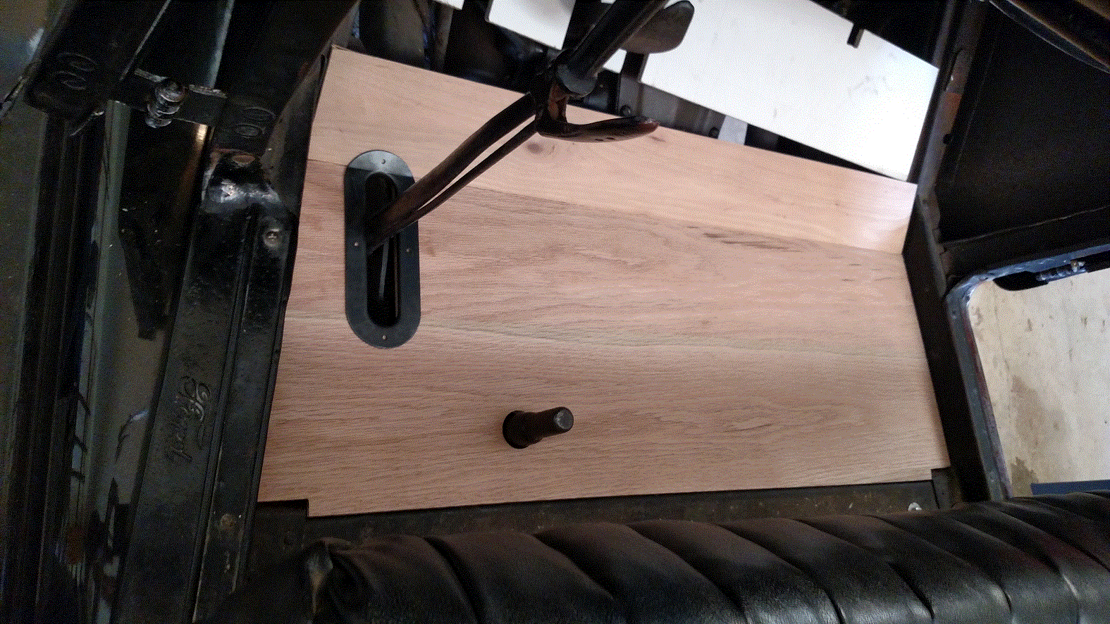

Don't expect dimensional lumber to fit. For my '26 Runabout I had to plane the boards to 9/16" to fit into the body's flanges and under the front board hold-down. The white panel in the photo is a piece of 1/4" hardboard that I used as a template for the upper board.

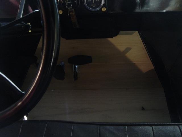

Re: Front floor board
Here's mine made from Poplar. So close they'd only fit this car. Your problem is no eng/trans in place. I'd definitely wait for it to be back in place. Anything else would be a crap shoot.
