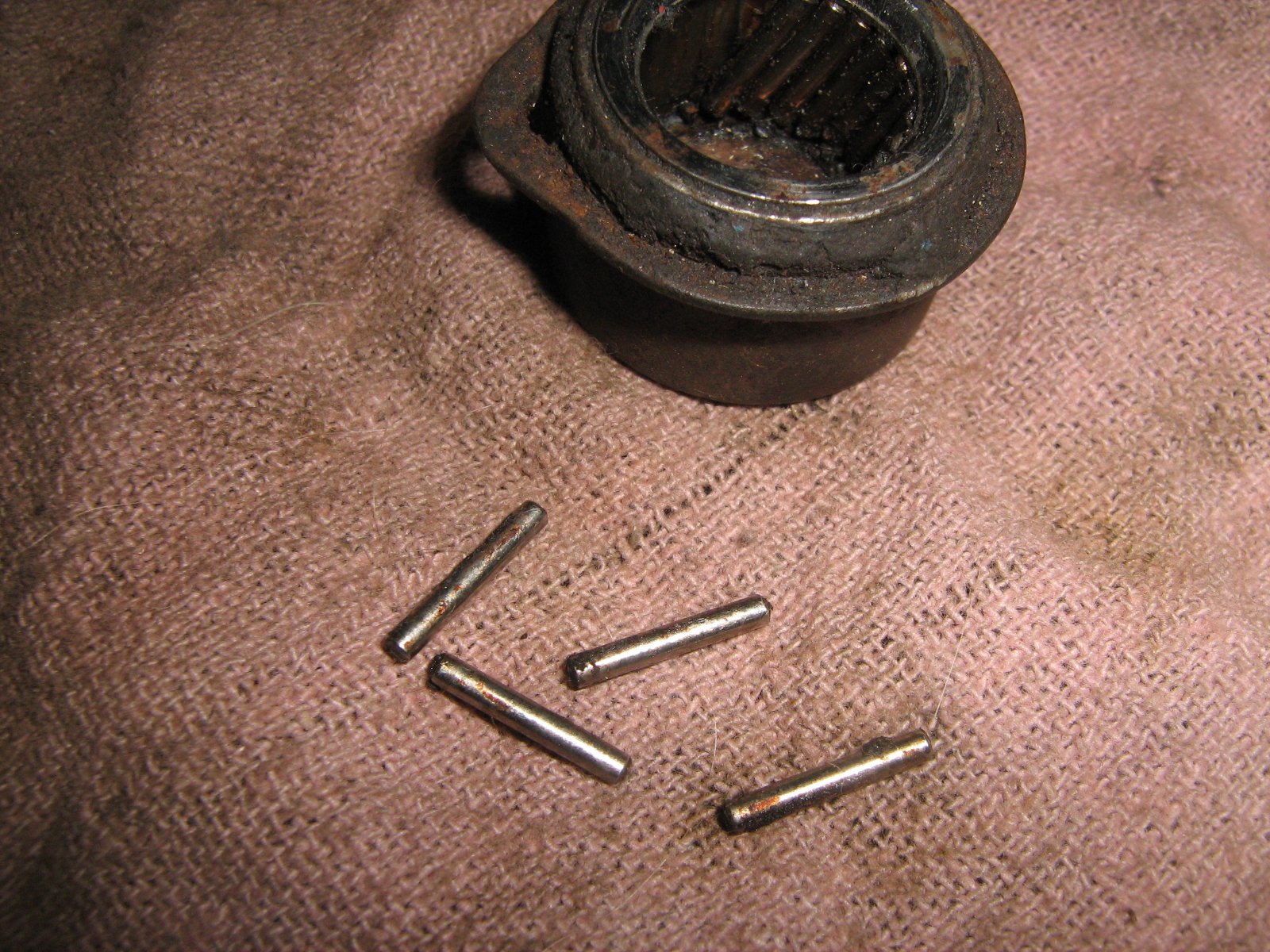

It is maddening when that one little part vanishes from the planet and you don't have a spare. In this case the part in question is the little valve spring seat pin (#3057). In my 3000 parts drawer I found plenty of seats, but not one pin. So I'm wondering if a piece of the same diameter drill bit would be OK. Hard enough? Not too brittle?

A nail would probably work for awhile, but have you tried drill rod, or better yet Langs?

Yes, I can get it from Lang's or any of the parts dealers. But I want to use the car this weekend. I'm sure a nail would be too soft. That's why I asked about drill stock.

Chinese metallurgy is a crapshoot at best, IMHO. If I was in a hurry, I’d use the end of a drill that is snug ( drill rod) and still sleep at night. Grandpa would use a nail and sleep good at night, too.

Yes, a quality drill bit will be fine. I know someone here in Sydney who has had drill bits as retainer pins in his tourer for the last ten years/20,000 plus kilometers without any issues. He did this as he found the repro pins were to soft. I don't know if the current repro ones are better or the same.
You could also use Silver Steel which may end up cheaper if you have to replace every pin.

It's very likely I have some originals somewhere, but it will probably be weeks or months before I find them. For now I'll go with a piece of drill bit.

You could take an ungalvanized nail of the right diameter, cut it to size, heat it red hot with a torch and temper it in oil. Jim Patrick

I have used snug fitting nails for a long time. I did have a few about thirty years ago that the nails were too hard, and fractured. No problems since.

The cheap chinese drillbits are too brittle, but an older US made one is probably o.k., you can allways check by clamping the drillbit in the vice with the cutting tip and give it a light rap with a hammer, if it breakes readily, toss it, if it holds up, cut to length with a cutting disk and presto ! it'll probably outlive you

I have used drill bit ends for valve pins and they work very well. In a pinch I cut off the end of bits that I use every day and now they are just little shorter. I put them in a vise and placed a white rag directly under it on the bench and the small pin falls on the rag. A dremel tool works great for cutting

Steve all you have to do is go ahead with the drill bit piece and button the engine up. About 5 minutes later that box of missing pins will show up.

im not a metallurgist but the end of a good drill should work great they are hard on the outside about 60r and still
have some soft core to prevent breaking. again good ones not harbor freight go to fastenal and buy a pack. philip

If a file "zings" off the pin it is likely too hard/brittle. If if scratches the pin it's too soft. If it just marks it, I think it would be fine. Personally I'd find a drill bit that fit, polish it and anneal it to JUST blue and test it. It should be fine for the trip but I would plan on eventually replacing with a good correct pin eventually.

The reason I switched to quality drill bit stock is when I redid my motor the pins I bought from a supplier lasted only about a month until I had to replace them. Some were bent and other broke. If I remember the suppliers were having an issue with the manufacture at the time.

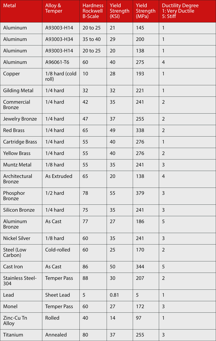

So in looking at the chart that Tim posted is that saying that Red Brass and Phospher Bronze would be good choices for pins?
I ask because I have 16 valve Roof heads that uses stock T valves but have heavier valve springs and a very high lift cams. I have not run these engines yet and have always thought about this a being a very very weak link. Dropping a valve in one of these might cause a grown man to cry. There is no room for larger valves and I have been unable to find a replacement valve with a more modern keeper that fits.

there is no material shown on that chart which would be good for pins
It is generic in information and does not include a multitude of alloys nor various treatment states for those alloys
For example, the category "steel" is even missing, which would include Hot Rolled, Cold Rolled either of which includes a myriad of alloys, uses and tempers
You'd be well served by consulting anyone of several engine builders and Horsepower guys that frequent the forum, with your question. I'm with you, it's not a subject you want to guess at.

I made a pin by just cutting a piece off the top end of a 7/64" drill bit. Today I stopped at the Fastenal store to order a 36" piece of drill rod, priced at $3.13 on the Fastenal website, just to have the material on hand for future use. The manager informed me that it would come from the manufacturer with a shipping charge several times the cost of the item. No sale. I'll pick one up sometime when I'm in Wichita.
