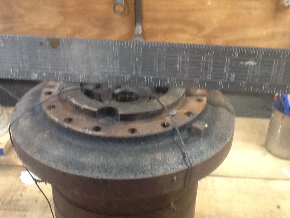

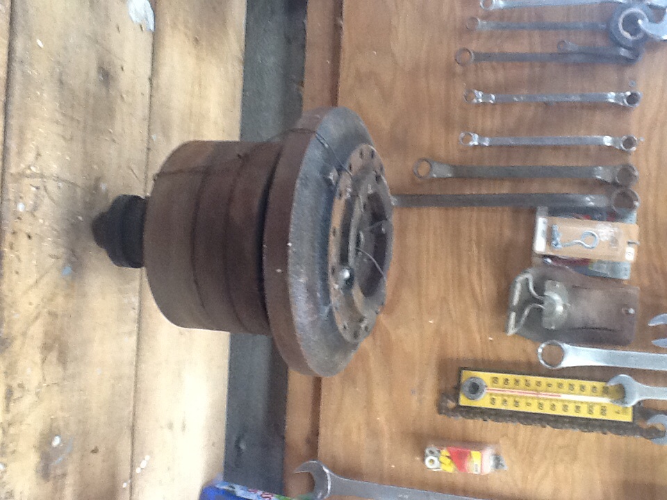

Re: Where & how much to lighten flywheel?
Here are two photo of my cut down flywheel. The diameter of the flywheel is about 10".
I LIKE IT!!!
But... do you have pics of the cut down magneto to go with it???
Kevin this all got when I bought my speedster.
Fitz
Thanks for those pics Ralph. That is quite the flywheel — gonna be tough to mount my magnets though...
