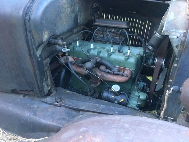

I have pulled up a video you might want to look at regarding a vaporizer problem. Click here: https://www.youtube.com/watch?v=OPfzFRipNkc.
About 5 years ago I had a problem with the carburetor running badly. You can see the carburetor squirting fuel out at 1:36 on the video. This is leaking out the vent in the bowl. In addition you can see a fuel leak out the connection nut above the heat exchange chamber at 2:04 in the video.
At the time I didn't really understand what was happening. I found a cracked exchange plate and changed it out which solved the fuel leak. The carb ran well for the next 5 years until the plate again cracked (see photo in earlier post).
I now know there was a crack in the tube inside that chamber. If your vaporizer is squirting fuel it is a symptom of simultaneous broken tube and plate. Replace the plate and it runs fine. But there is still a crack in the tube! The unusual fuel leak is due to the heating chamber pressure experiencing increase pressure pulses coming from the exhaust through the plate crack then blowing through into the emulsion tube. Once a pressure wave enters the tube it blows fuel out the bowl vent and the top of the emulsion tube... causing the car to be hard starting and very poor running.
At the end of the video you can see that even with a cracked plate and tube it still runs! I actually took me 5 years of daily running to finally getting around to spotting that cracked emulsion tube!
So now if the car is having a problem running I know to check both areas. In my experience a vaporizer carb is a good running unit but you need to fix any and all leaks. It's not rocket science, they ran well on inferior fuel in 1927 and if you do simple things they will run well on the inferior alcohol mixes we have available today.
