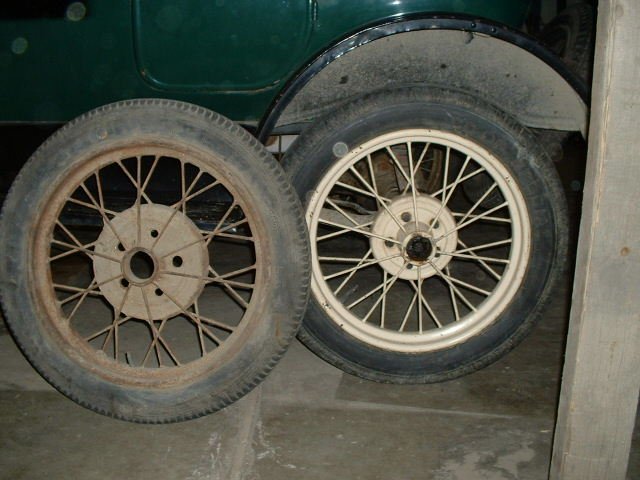

The easy way to identify any A model rim is to check the hub.
A frequent problem with wire wheels is cracking between the stud holes on the flat base of the hub
The A model wheels have a teinforcing ridge, pressed outwards beteen each stud hole. That ridge is common to all A model wheels.

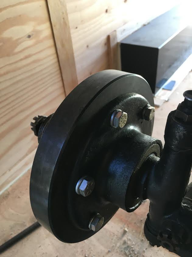

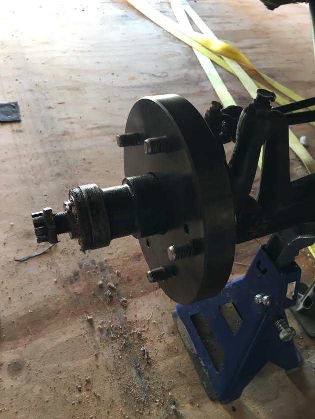

Pictures of the front wheel model A wheel adapters.
The wheels are probably stronger because of being designed for 40 HP.
I will post the rear picture when I have a wheel off.
I bought a set of wood split rim wheels for the 25 picku and am going back to them so that I can put the Model A wheels back on the Model A.
