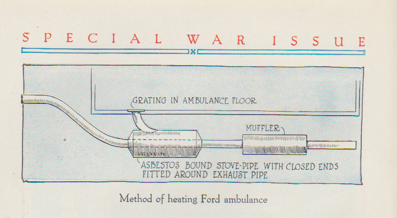

Heater for model t
Post by Colin Mavins » Tue Feb 05, 2019 5:22 pm
I have not seen this before found it in the 1917 war issue Ford Times

Post by Rich Eagle » Tue Feb 05, 2019 5:28 pm
Pretty neat. There is plenty of heat there to take the chill off.

Post by Mark Gregush » Tue Feb 05, 2019 7:41 pm
It's missing something, a way to get air in to pass over the pipe or if the top were open and fitted to a register in the floor approx the same length and a little wider then the stove pipe it might do something. Neat find.

Post by Bill Dizer » Tue Feb 05, 2019 8:01 pm
My 1925 Coupe has an Arvin exhaust heater in it. It has a cast iron section with fins, covered with a tin box, and at the bottom rear, a scoop that is adjustable to catch the air going by, and at the top front, a rectangular opening that fits to a grate in the floor boards. The heater fits in the exhaust pipe just behind the manifold, and replaces the bend in the pipe. It puts out a fair amount of heat, in mostly one spot! At the grate, it is roast, bake, or incinerate! A fan would be a help! The heater casting also seems a bit restrictive, flow wise.

Post by Tmodelt » Wed Feb 06, 2019 10:45 am
My manifold heater grate is in the floor boards at "momma's" feet. When "momma" is happy, everyone is happy!
